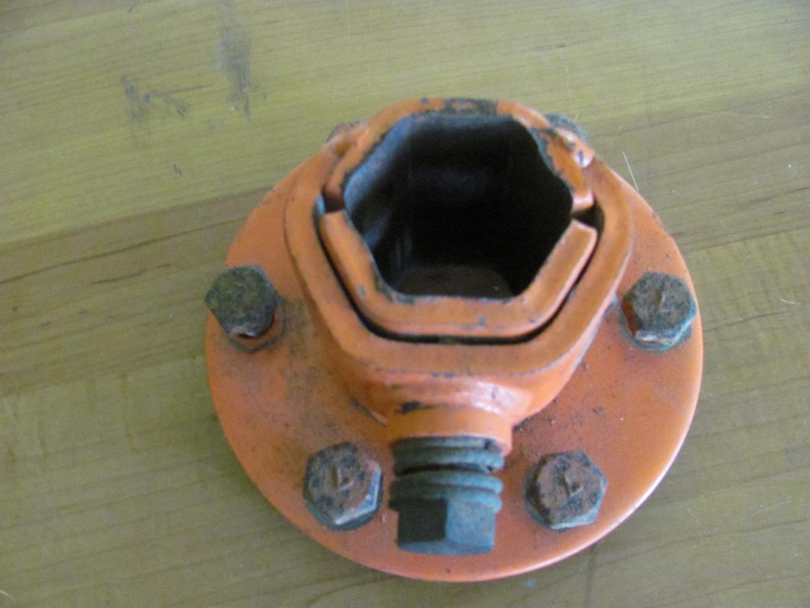

Question - the old style pinched the axle with a tight grip on 6 sides....more or less.
https://www.ebay.com/itm/Rear-Hub-f...d=401422238603&_trksid=p2047675.c100009.m1982
http://www.orangetractortalks.com/forums/attachment.php?attachmentid=17822&d=1440300419
I wonder if that two bolt style would have the same effect. You cannot see inside the hexagon in the picture, wonder if there is a "plate" that squeezes on the axle - or is it JUST the two bolt faces pinching?
Either way - be worth the price to try it!
I have found some other pics as well. It appears it is just the 2 bolts that contact the axle.
