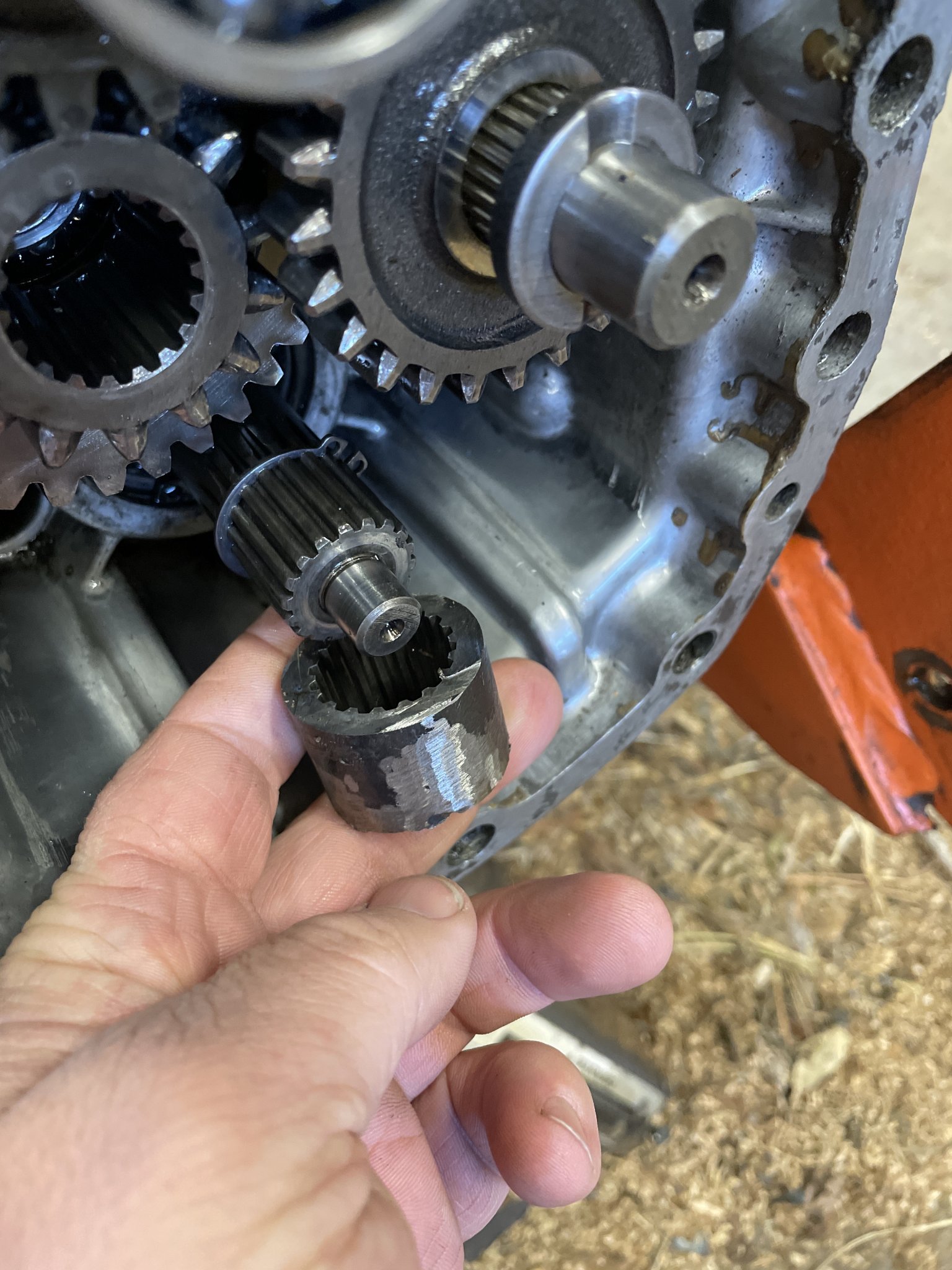

Hi there,
New to the page.
I’ve got a 1979 B7100 geared tractor that I’ve had a couple years.
PTO does not work and the guy I bought it from had opened tractor up and found the one-way clutch broken.
He removed the broken parts and put back together.
I’ve now split the tractor and ordered a one way clutch (H6670-14380) off Ebay.
My tractor has 18 splines on the transmission side and 28 splines on the PTO shaft side.
The part sent to me has 28 splines on both sides of the one-way clutch.
Am I missing something? Did I get the wrong part?
When I split tractor there was a broken piece remaining that has clearly been worked on. I can’t figure out what it is and it doesn’t show in the service manual.
Some sort of adaptor from 28 to 18 spline that’s been broken?

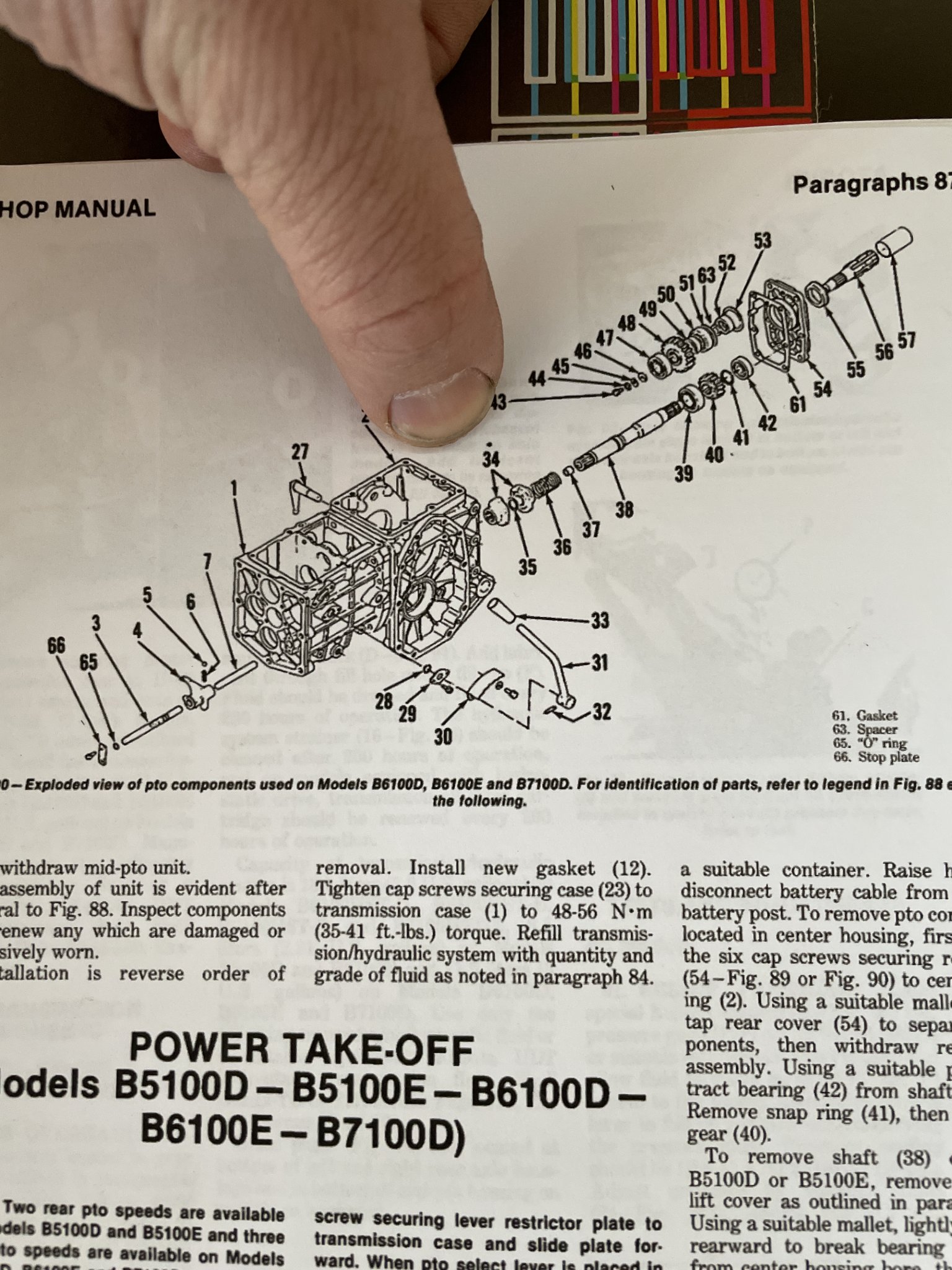

I believe you need 66706-14380 also 66611-14370 Boss spline. Kubota was having failures with their splines and started making adapters for the earlier models, I think pre 1980, don't hold me to it. I have a b6100 with a crank adapter to run the new style front pto clutch, the finer splines of the early models just did not hold up. I good dealer should be able to help you.

Based on the serial number you gave you shouldn't have needed the boss spline, but odder things have happened with these.
And you never know what the past owners have done to it.
More picture of that parts you have might help sort it out.

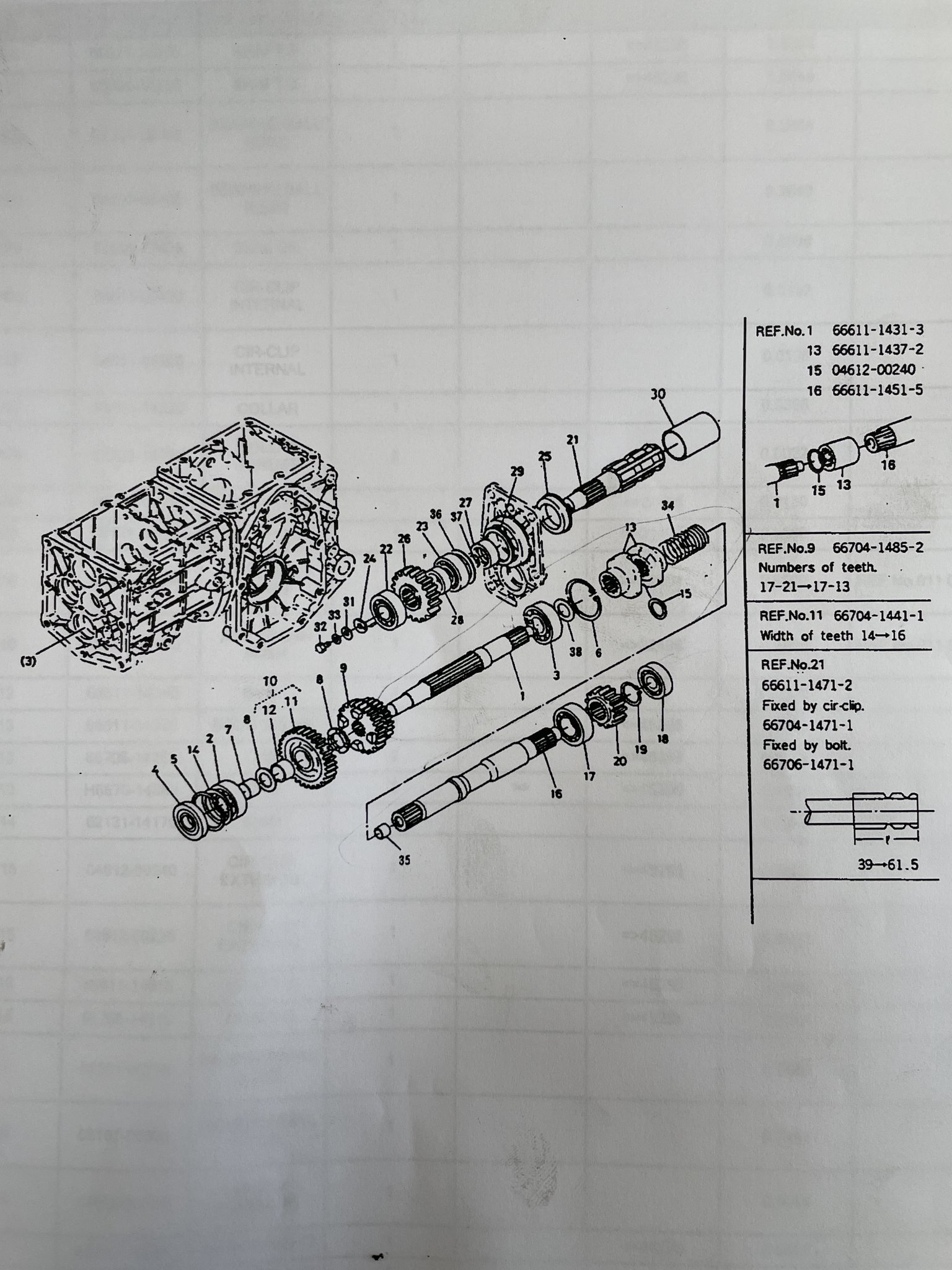

Looked into it deeper, it appears that you have an older style output shaft than didn't have a one way clutch, and that has a different spline count than the newer shafts.
I think this is the shaft you need:

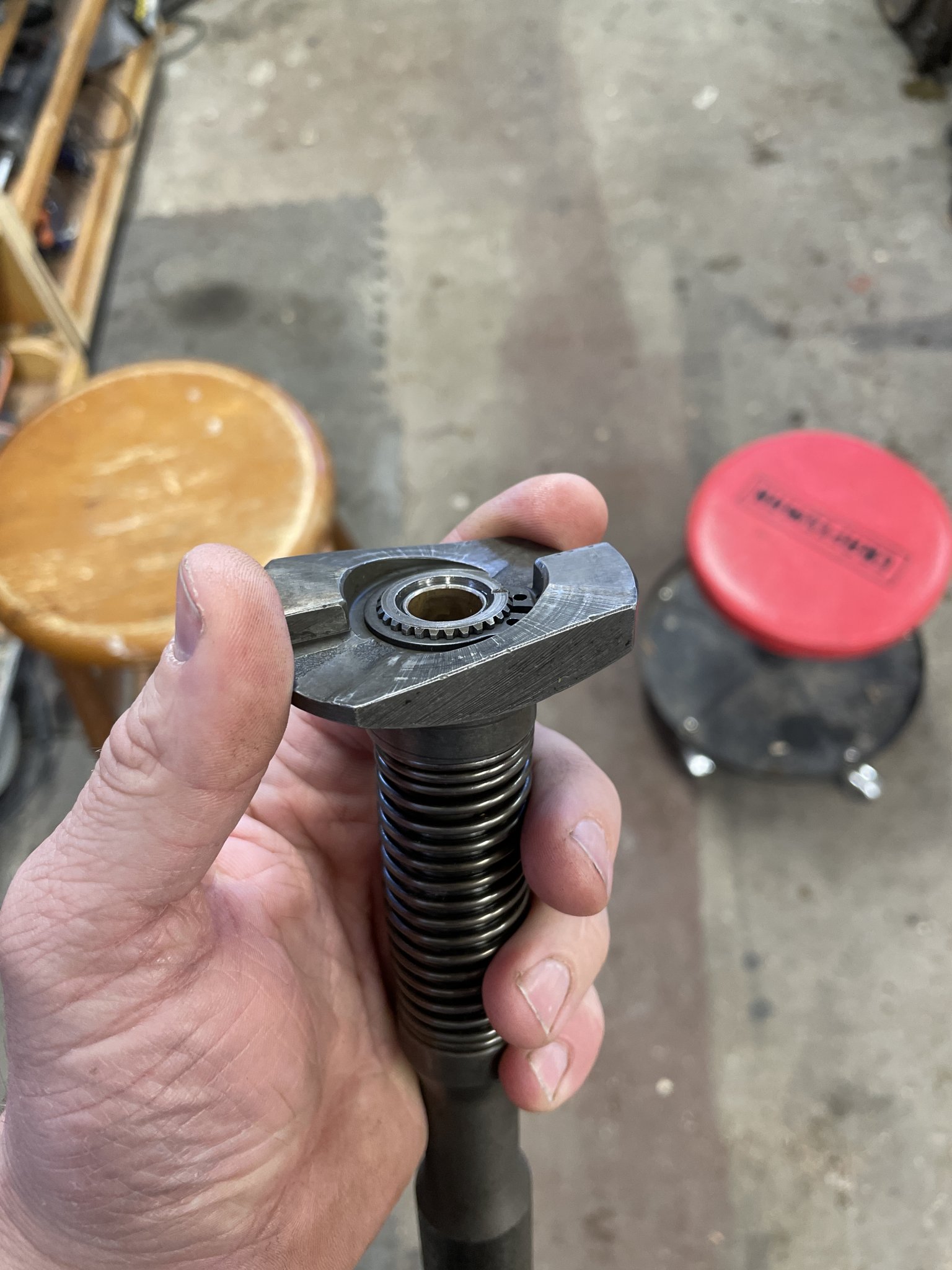

Correct, my PTO shaft was not hooked up.
The PTO would spin from the friction of touching the end of the 3rd shaft but if you grabbed it with your hand it would immediately stop spinning.
How would it have originally been hooked up with the 18splines on the 3rd shaft and the 28splines on the PTO shaft?
The 3rd shaft that is in my tractor has a snap ring on it to keep the one way clutch from going on too far.
I can’t find diagrams showing this.
Has my 3rd shaft maybe been replaced with something from a different tractor?

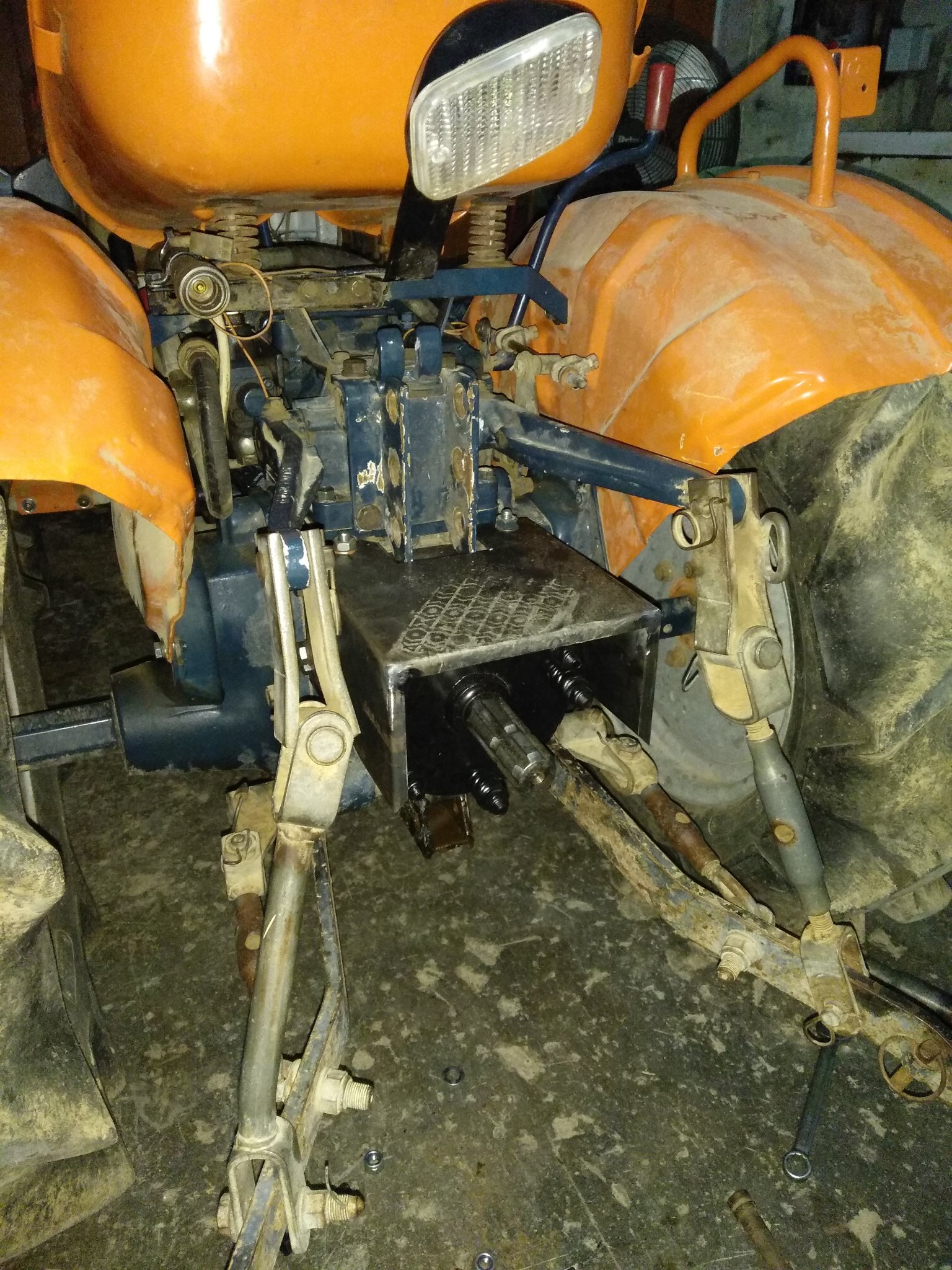

I am not sure what year is mine and it is a B7001 sorry*.
I did open the box several times. :D last year i tore a tooth off the 1st PTO gear when tilling and catching a tree stump. (taking it out required a full strip) but the pto shaft job is easy through the rear plate (don't mess with this shims). I also did try adjust them due to new bearings and cracked gearbox case at the dowel hole :( .
Mine has a splined bush that connects the two shafts. I think since it is spring loaded and has sliding parts you would need a different layshaft to drive the PTO. As indicated above.
I installed this slip clutch on mine. cost me 90(Euros of british pounds). I had to shorted all the shafts as i did not wish to extend the length of the 3point hitch arms. Tractor is a tight fit on the trailer with certain implements.
I thought a slip clutch is better but needs to be checked and torqued to prevent it rusting solid. the over run clutch in the box is ideal when using things like a drum mower which keeps driving your tractor. I got used to quickly depressing the clutch and putting the PTO on neutral when mowing and if i need to move without the mower working. The over run clutch in the box in the case of implement lock up (tiller catching a stone it is of not much help. (if i am correct)
PS and i am pretty sure that over run adaptor clutches can be bought and added to the PTO shaft end. (might be cheaper ?)

I believe I’ve solved my conundrum....
Tractor did not originally have one way clutch (H6670-14380). It instead had the 66611-14370 Boss Spline.
Original Boss Spline and original PTO shaft 66611-1451-5 would have failed/broken on previous owner.
I assume previous owner ordered updated PTO shaft 5 66706-14510 that has the 28 splines instead of the original shaft 5 66611-14515 that has 18 splines.
He then split tractor and found shaft 3 66611-14310 has 18 splines and his new shaft 5 had 28 splines and put it back together.
To have a working PTO:
-I can either order boss spline and a 18 spline shaft 5 and have a working PTO but no clutch
-Or.... purchase shaft 3 66706-14310 with 28 splines and upgrade to clutch.

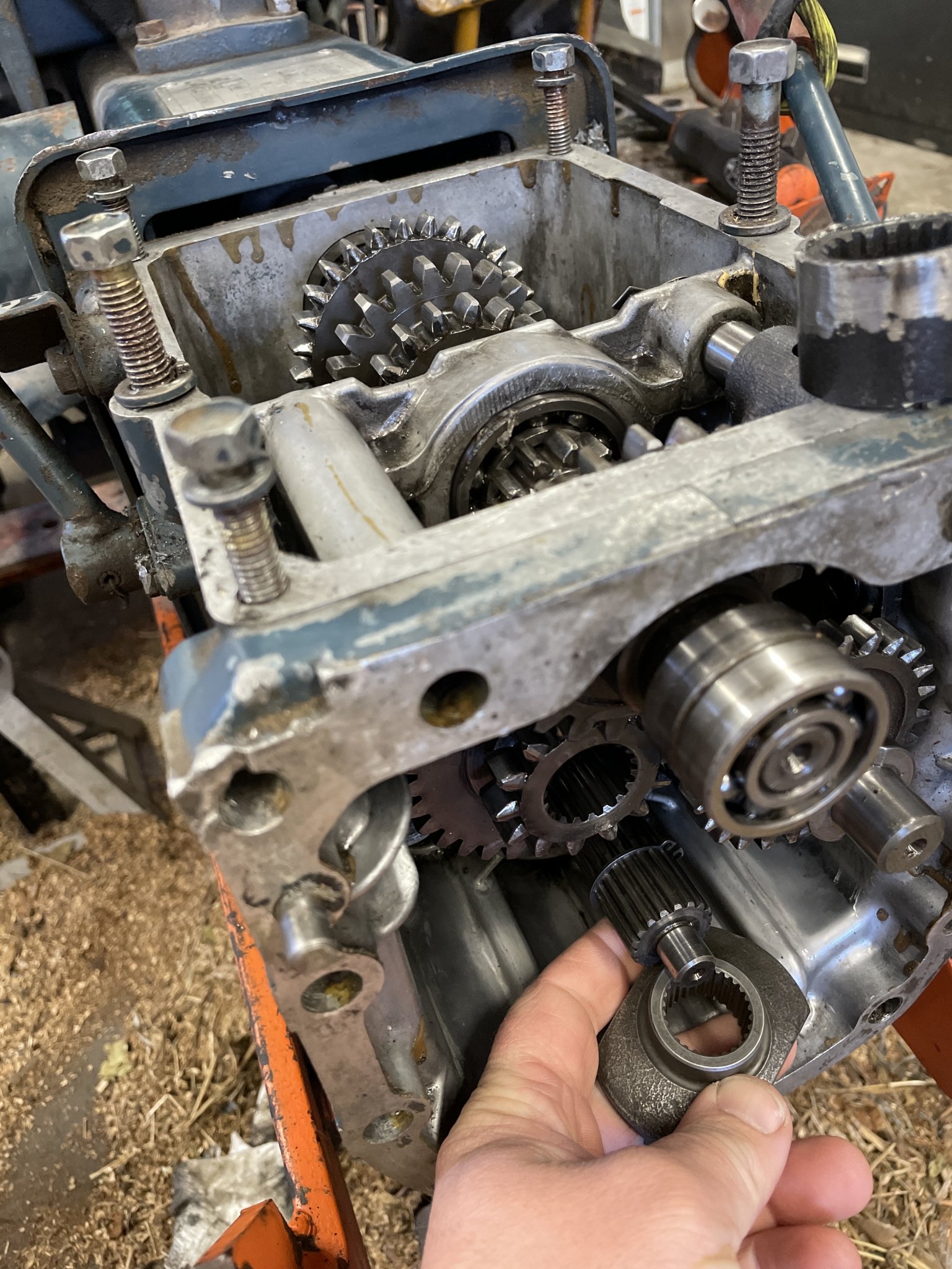

I got this 3rd shaft picked up from my dealer today.
Do you know if I need to pull 1st and 2nd shafts to swap? Or am I able to sneak 3rd shaft out by itself?

Yikes, it's been a long time since I was in one of those.
I've worked on a bunch of HST buy only a handful of geared.
I'm sorry I can't remember the sequence off the top of my head.
If you get into it and get stuck ask specifics and maybe my tired brain will remember.
