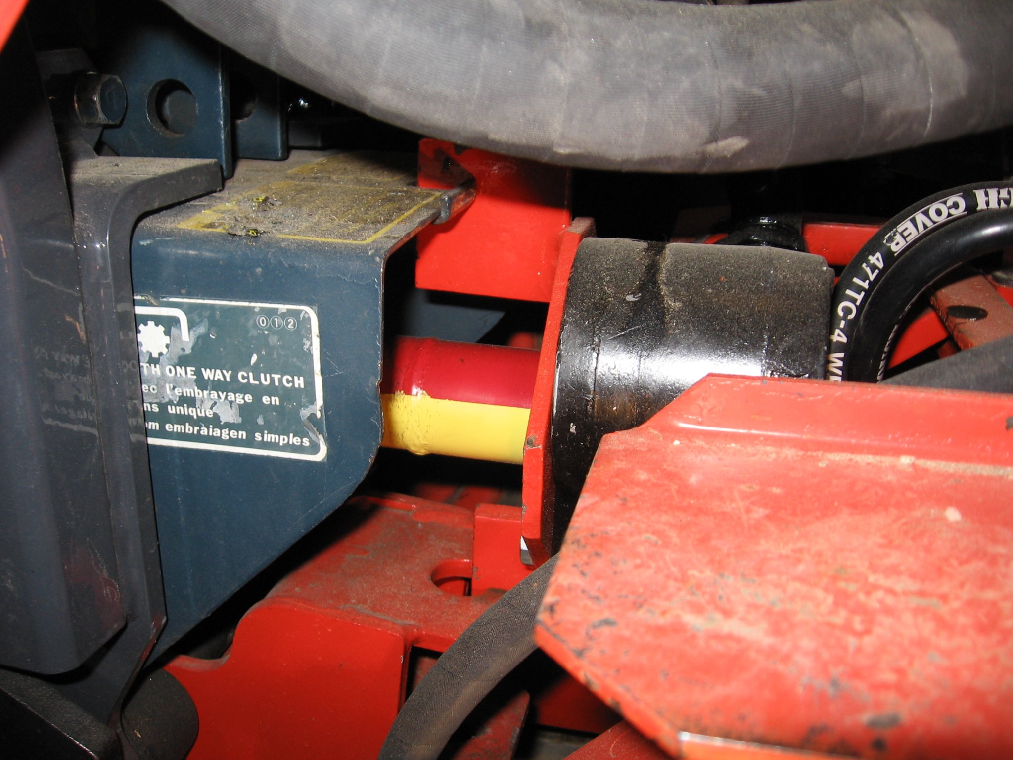

Yes that front shaft and coupler to run the front mounted pump has long been obsolete.
You would have to make your own.

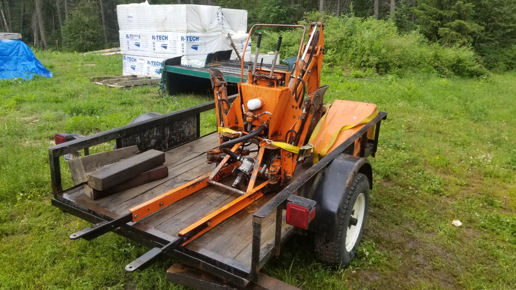

Vevor, and probably other direct from Chiii-nah retailers, sells a hydraulic pump that just slips over the PTO. You would have to fabricobble some basic brackets to hold it in place. Not sure if it's an option that would work for you.
That is how the B670 BH is set up.
