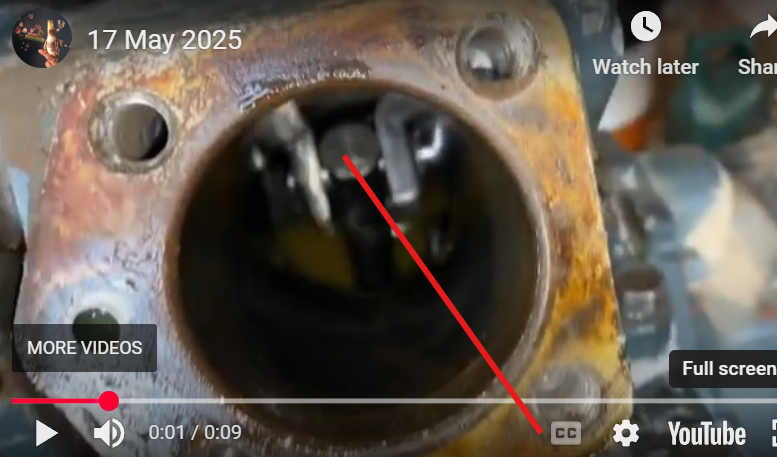

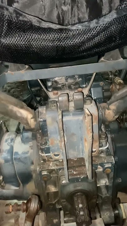

After assembling the tractor, the three point hitch raised and didn’t lower. So I applied some weight on it to lower it, and suddenly it became loose and doesn’t lift any more. I have released air by loosening the control bolt (the one under the chair) but it didn’t fix the issue, and I can see oil pumping when moving the lever (I loosened the bolt in the Hyde line going into the hitch unit) but the arms never move up. I have some videos that might help in assisting the situation

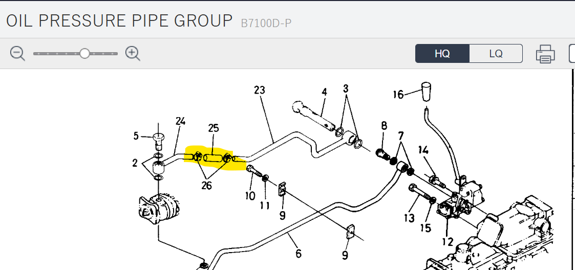

Check the hose section of this pipe and make sure it's tight.
And when you installed the filter screen did you use new O-rings.
And when you installed the filter screen did you use new O-rings. View attachment 154634
I will check that part
no, I didn’t change the o-rings on the filter….but one thing to mention is that after I assembled the tractor again, the hitch worked fine but was stuck at the top…once I applied wait it dropped and never raised again

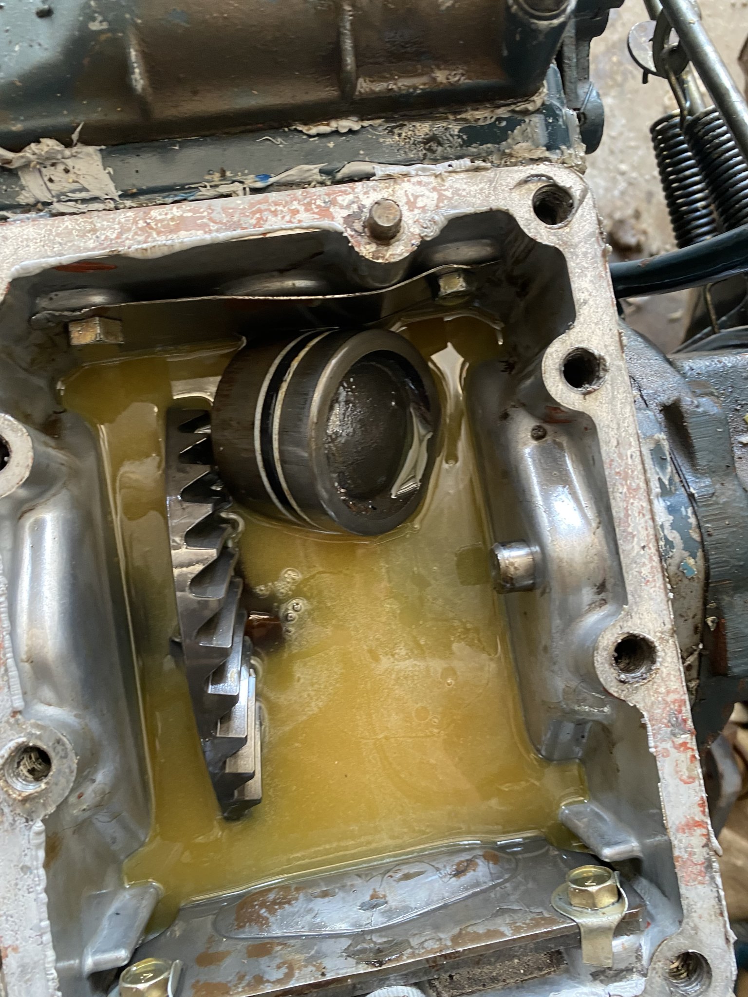

I have removed the 3 points hitch and found the piston in the oil 😅
seems I assembled it incorrectly
now issue is fixed
Thx everyone

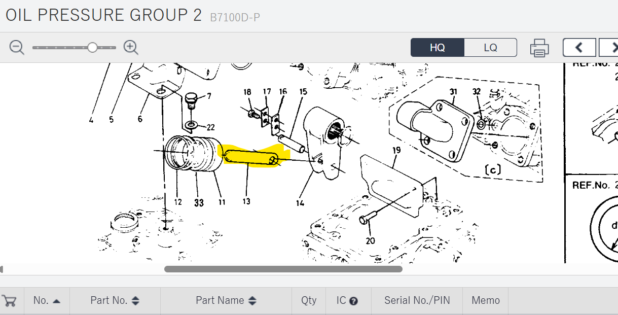

@North Idaho Wolfman or @newshb_k
Is there some push rod between the piston and the arm levers?
I don’t see how the piston would be able to fall out of the bottom of the cylinder? Could you please explain how that would be possible? What part would be missing?
34,739
10,008
In his video I see the push rod attached to the arm, my guess would be that he had the push rod facing the wrong way when he assembled it, as it does spin around and can face the wrong way on assembly
There is also a stop plate to keep the arm from moving back too far but I see that attached in his picture.
7,178
2,604
Deleted original
Thanks, I see it now!
34,739
10,008
It's here it's just pointed down instead of into the cylinder.
Yes, I assembled it facing wrong way…I am not sure I got mislead by a video of disassembly where it was laying down, so I assembled it also laying down 😂…glad I didn’t move the tractor as the rear gear could got broken by the cylinder
