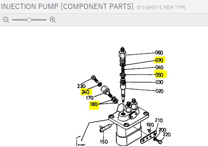

Oh sorry, you said pump leaking, I was thinking hydraulic
I didn't get that you meant Injection pump.
#70 (3) 15331-96760
#50 (3) 15331-51240
#240 (1) 14111-53380
#180 (2) 15331-96650

Would that be for each line still vpnfused but thanks for part numbers.think middle line is leaking but want to do them all
34,347
9,582
These set of (3) is one for each delivery valve that comes out the top
#70 (3) 15331-96760
#50 (3) 15331-51240
These are for the feed line from the lift pump
