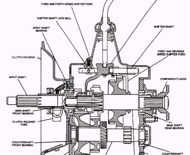

The previous post was a Hydrostatic drive. The forward or reverse is controlled by a foot pedal. A clip on that linkage had come apart.
Yours is a gear drive. Totally different. Sounds like the end of the shifter down inside the transmission has slipped out of the shifting fork. The top of the transmission will need to come off and the shifting forks put back into the neutral position. Never had a Kubota with this problem but was common on older standard transmission vehicles with stick shift and lots of miles of use. Sometimes a ball shape on the end of the shifter was worn down and it slipped out of the fork. Suggest you get a Workshop Manual before you open up the transmission.
Her is a picture that shows the end of a shifter and a shifting fork. It is not a Kubota transmission but will give you an idea of what I am trying to show you.

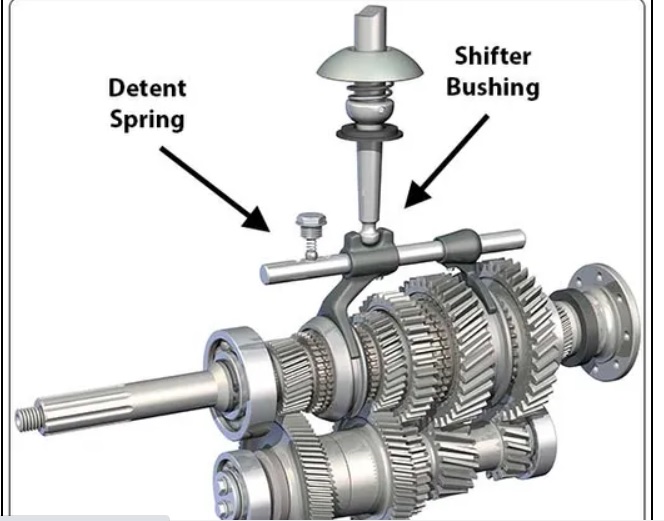

Another picture maybe better. Once again not Kubota but to give
you an idea of what is inside.

Another picture maybe better. Once again not Kubota but to give View attachment 51889 you an idea of what is inside.
Solved = at least in my case.
After viewing this diagram I noticed the shifter is sitting in the top fork with a little ball apparently doing all the work of moving everything inside on the top end.
I also remembered the shifter feeling like something 'popped' when I could no longer get it out of reverse.
So - my solution that worked was to pull UP on the shifter and simultaneously move the shifter to different positions, then letting it go back down to see if I could get it back to where I felt it pop.
Sure enough, after about 5 tries I found a spot that letting it down I could feel it pop back in and whadda ya know?! ... I could shift through all the gears again.
