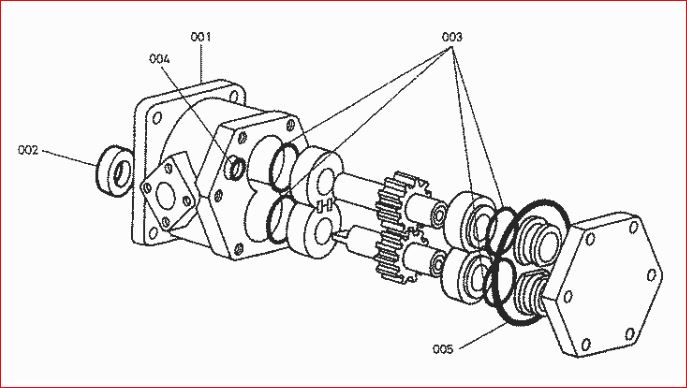

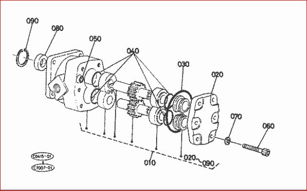

I recently lived the nightmare of having my Xmission oil pumped in to my engine due to a bad oil seal on the engine operated hydraulic pump. I have the pump off but there is not a snap ring holding the oil seal in place as my manual shows. There is a snap ring located on the fuel pump that appears to be holding a bearing in place but not on the Hydraulic pump oil seal side.
I noticed on my Hyd pump, it appears that a punch was used to indent the metal on the pumps case around the oil seal in order to hold the seal in place. I don't want to proceed until I have a better idea what to do. This is an older B7100 4x4 and not a hydrostatic.
Thanks for your help

Thank you your for your quick response, I hope Im tracking right with the snap ring. All the manuals I have show one as does the parts break down you can access at Messicks.

There is no snap ring on the pump side.
seal is just pressed in, if it's popped it out before It is very likely it needs a complete rebuild or replacement, it sounds like it's allowing too much fluid and pressure behind the seal.
Note: I think the snap ring your seeing in parts diagrams holds the cam bearing in place.

You don't have a newer style of pump on there do you? It will have a clip holding the seal in.
You will note the cover plates are completely different, dead give away.
If it is the newer pump and they didn't put the clip back in and just peined the seal in that's the reason it failed, You will need to clean up the clip slot and put a new clip and seal in it.
Newer HST pump
Older Non-HST pump
Wolfman and all others,
Thanks so much for the advice all of you have posted.
I should of given the site a chance to respond prior to in stalling the pump with a snap ring with out having the groove for one. (What was I thinking?)
The good news is my gut told me something was not right so I did more research and found out that I was looking at a diagram for a newer style pump as wolfman suggested. I removed the pump (again) and removed the snap ring. At this time the old girl is back together and all seems to be operating normal. again, thanks to all of you, what a great resource this site is V/R Tom
