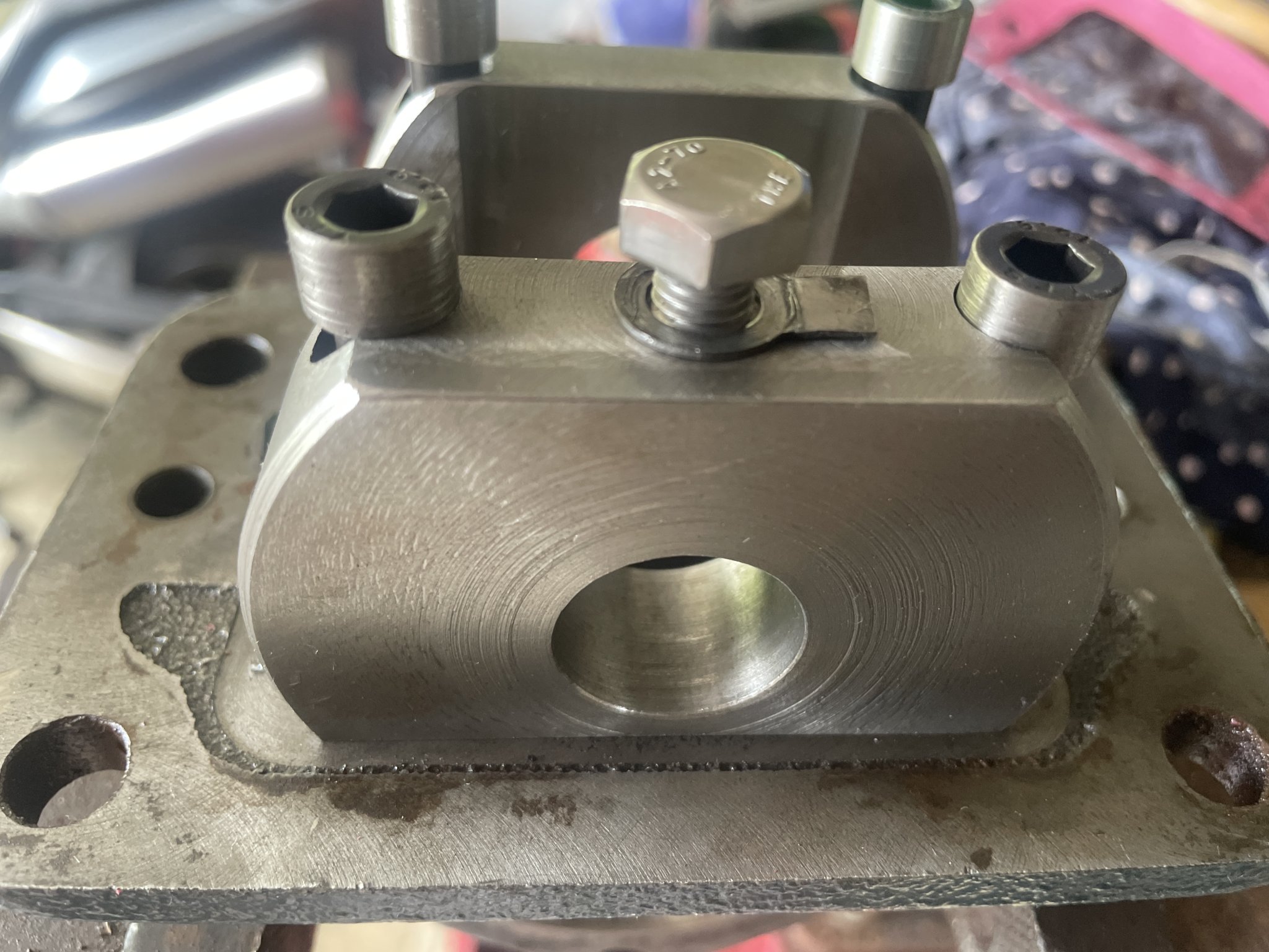

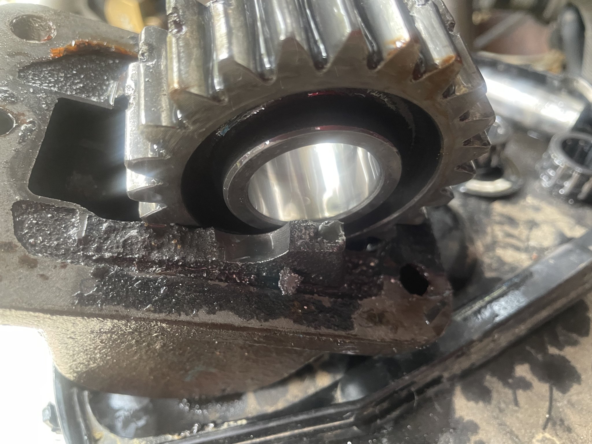

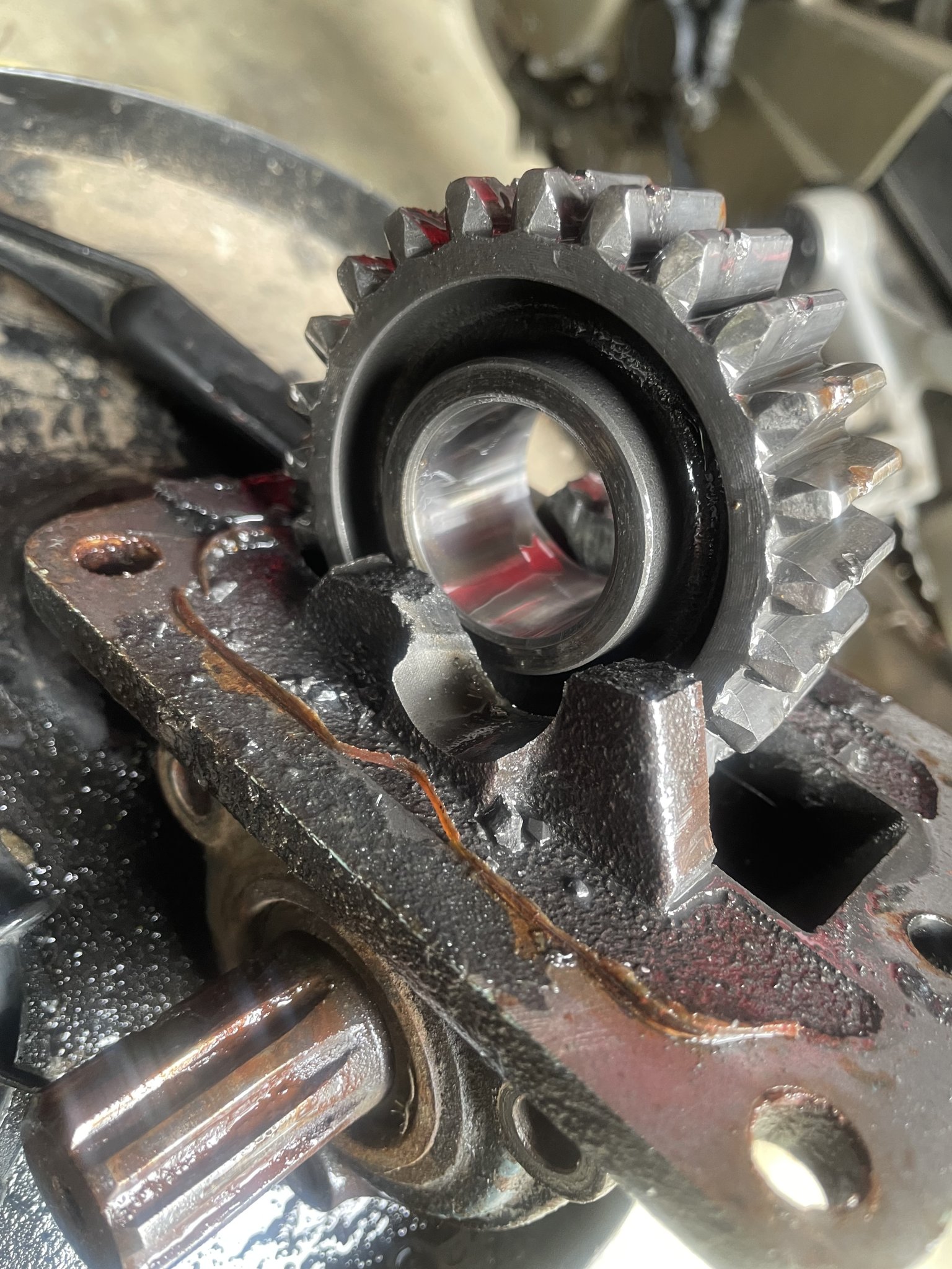

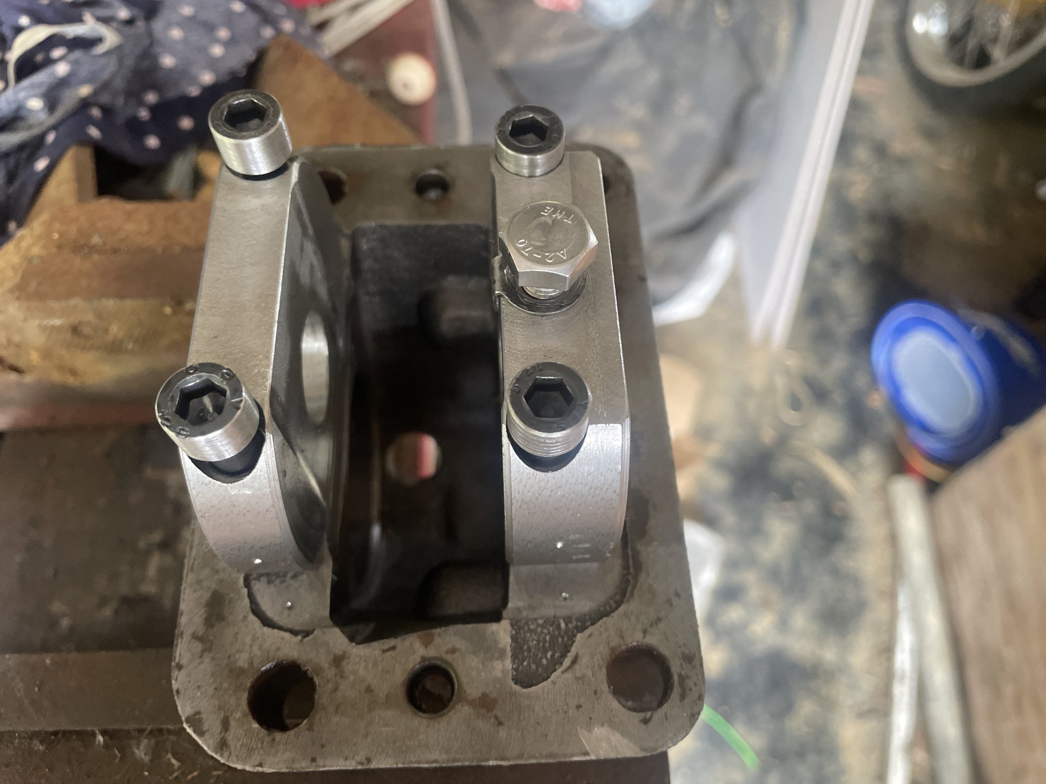

One day it started making a horrible grinding noise so I disengaged, when I tried to reengage it wouldn’t go in and just kept grinding here are some pics of the damage. Anyone have a spare housing ? If your mid pto keeps jumping out might be worth checking this hasn’t cracked causing slight misalignment
