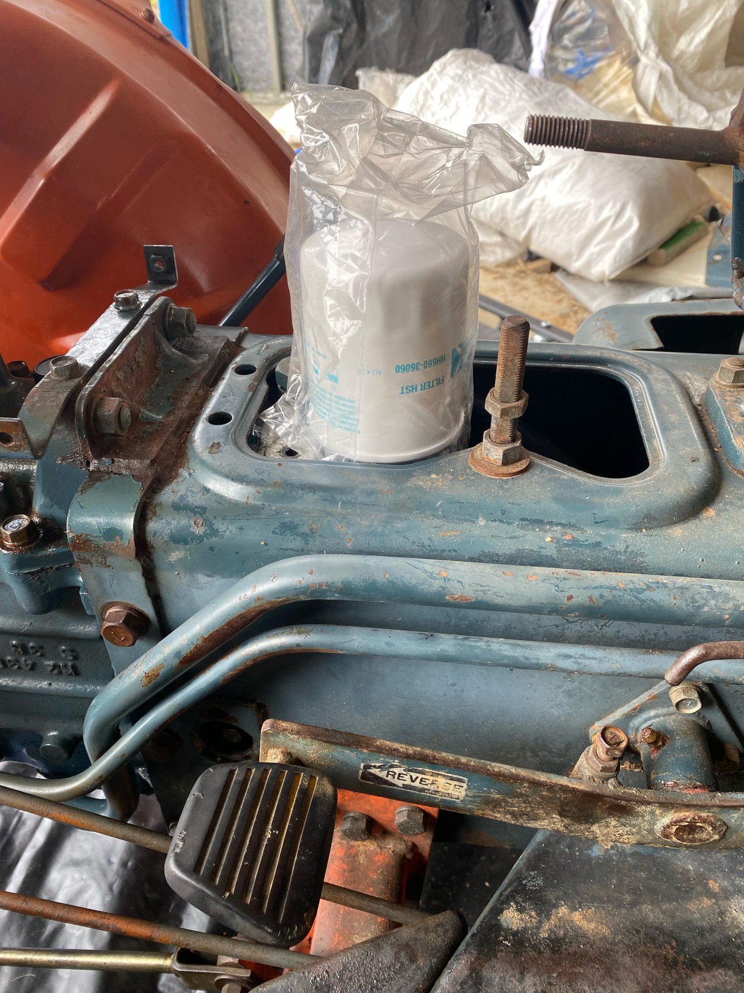

Adjusted the spring tension bolt near HST filter all the way to the maximum tension position.
This photo shows the lock nut at the position before I adjusted the spring tension bolt. However This did not fix the problem.

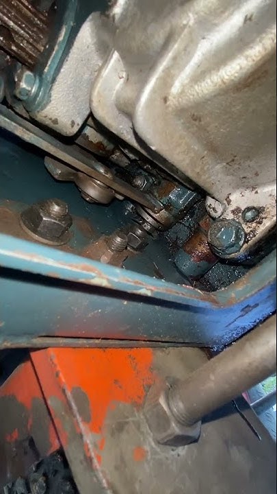

The only thing I can see is where the arm attaches to the HST there seems to be some sort of play there? Or is the spring stretched too much that it does not have enough force to return the pedal back to neutral?
Here is a video showing the play where arm attaches to the HST, is there a bush or something in there that wears? The end of the video shows the play the best
