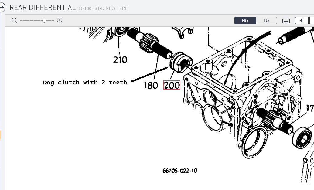

I can see from the parts diagram there is sort of a clutch with a spring that engages the splines. All I can think of is one of these parts is warn? So even though I cant hold the wheels back with my hands on the jack stands out in the field there is a lot more pressure? There is never any grinding nosies.

Assuming its the same as the B7200 the lock is a dog clutch with two square keys. IIRC the spring holds the clutch apart and the pedal overcomes the spring and engages the clutch. The square edges of the keys can get worn off and slip under load. On my tractor that produced noise and a pulsing feel in the pedal. Not a horrible job to replace the clutch.
Yes that looks to be the same. When you replaced it did you have to drain the hydraulic fluid?
10,822
5,940
  1. The drawing is the B7100 parts breakdown.
  2. You are opening up the differential case so you must drain the oil.
  3. IIRC the dogs engage the differential carrier and on mine the carrier was still in good shape. If yours is not the cost goes way up.

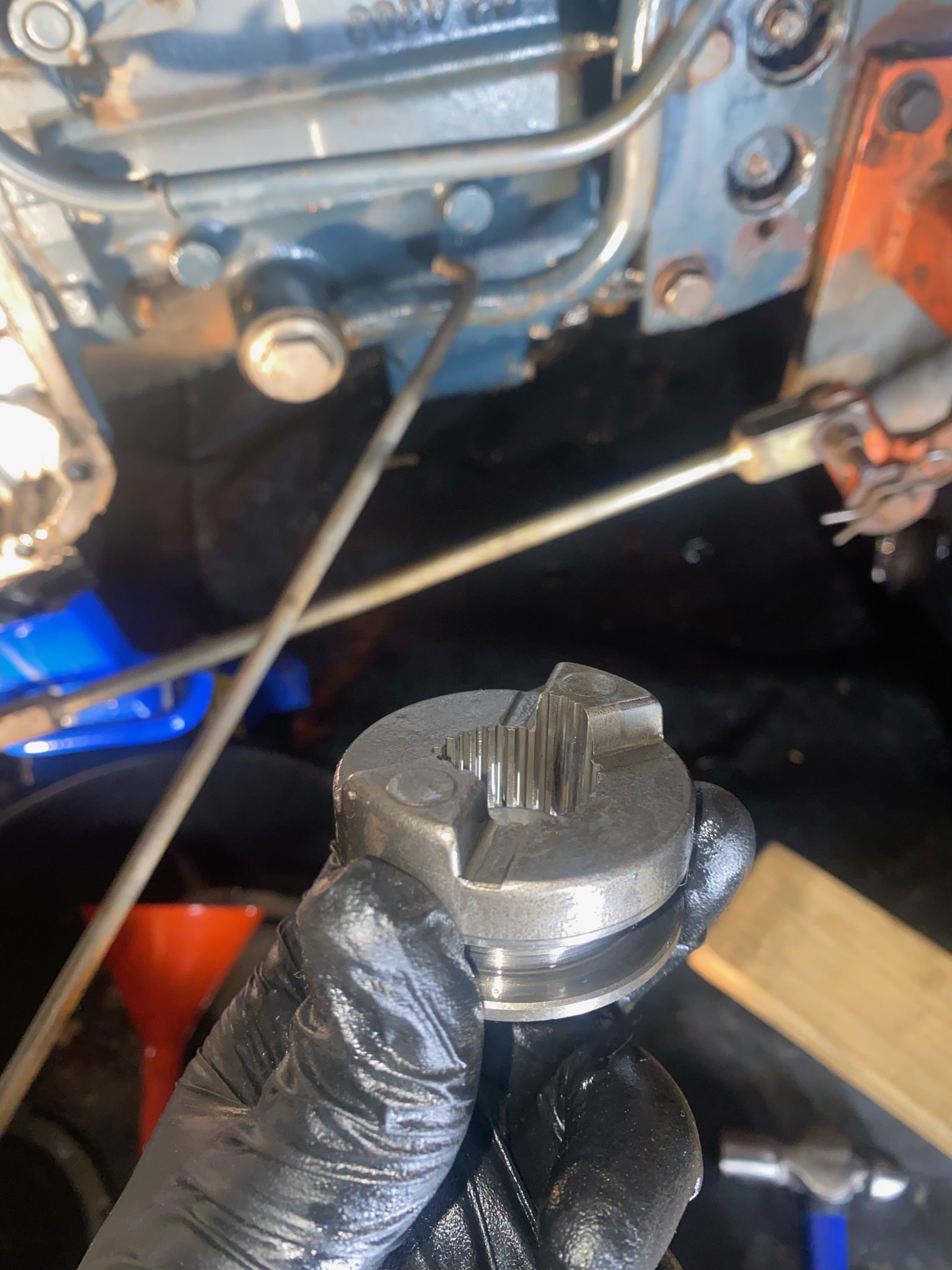

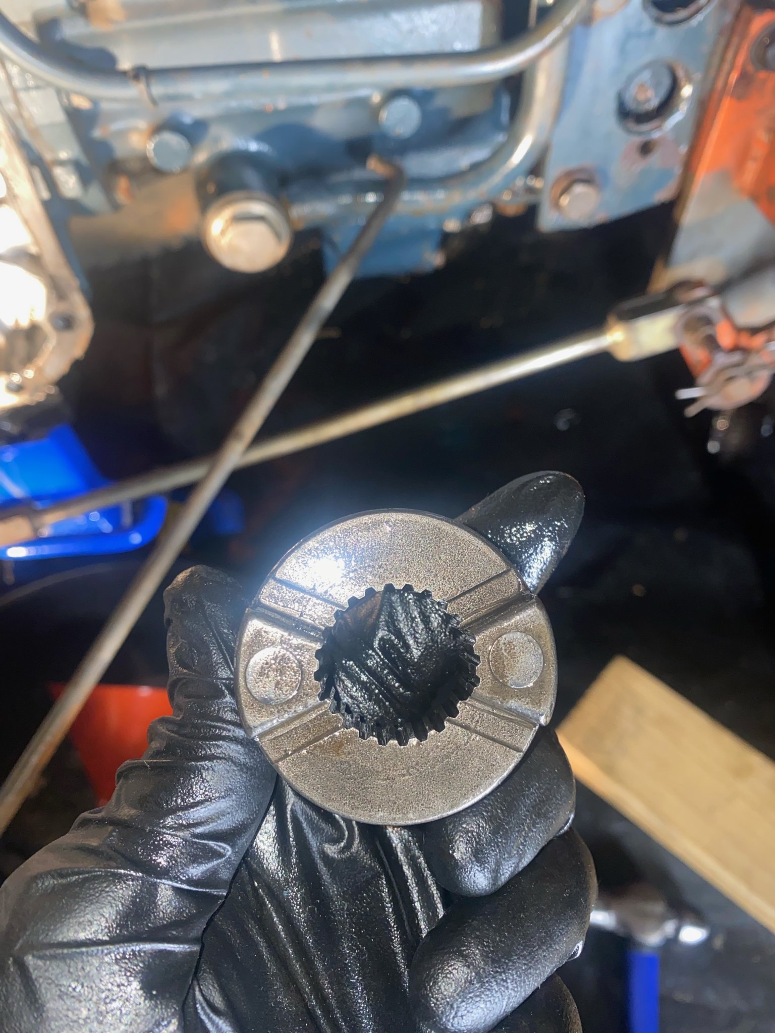

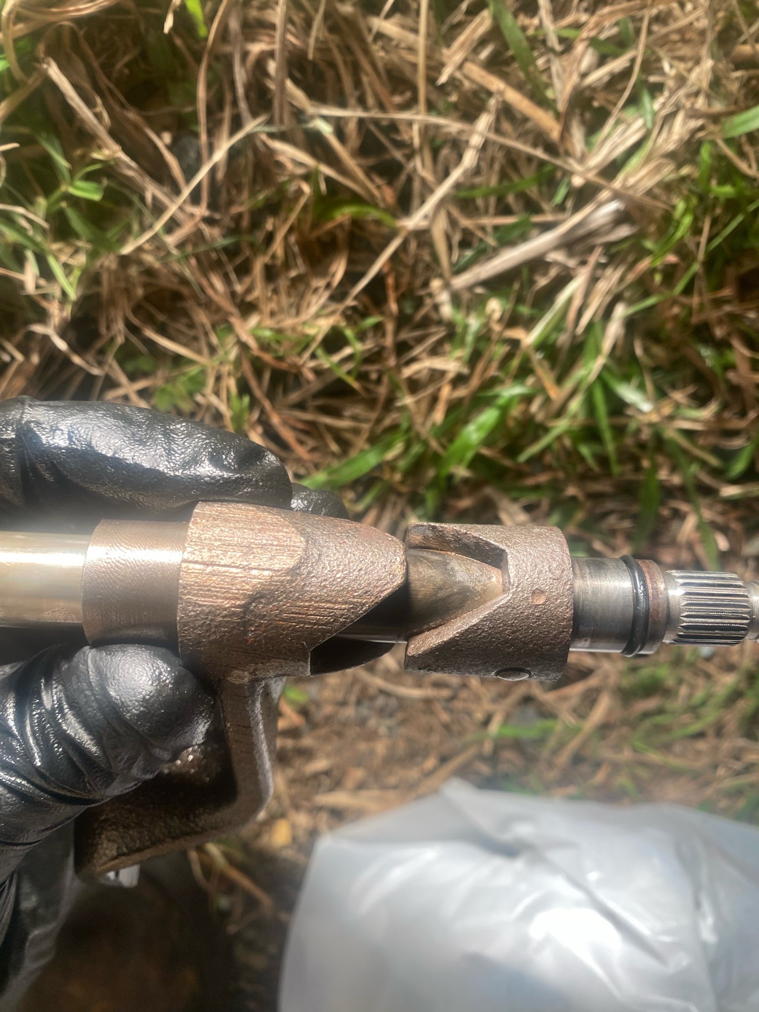

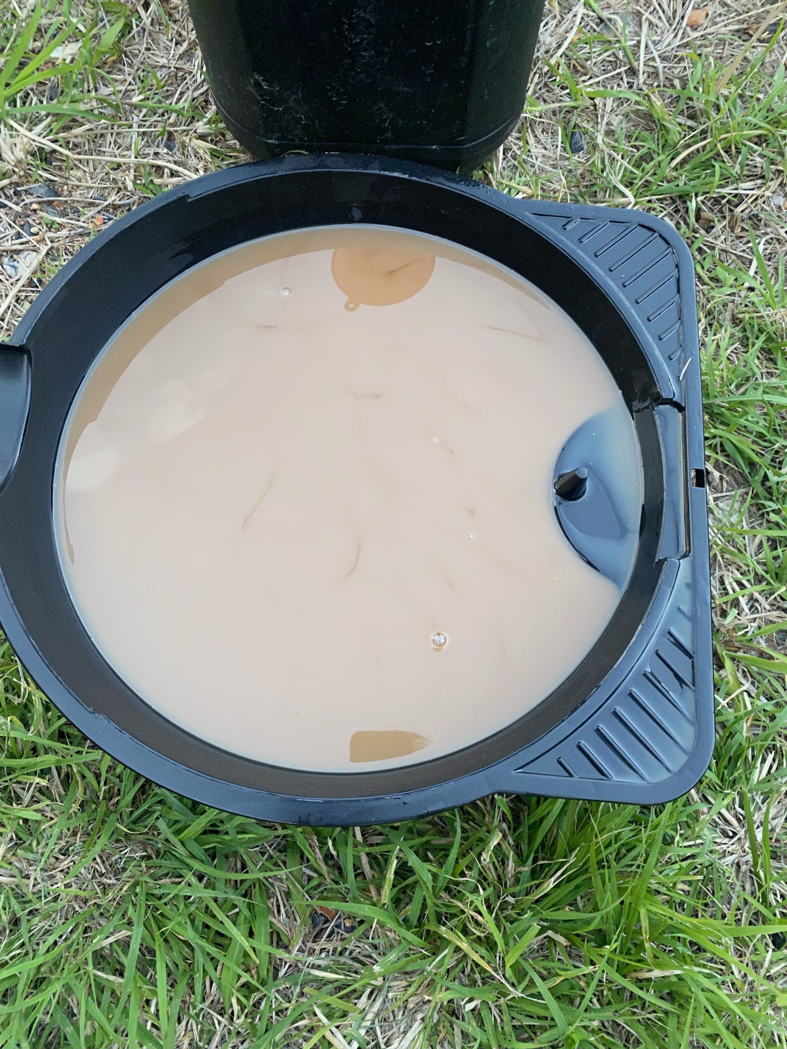

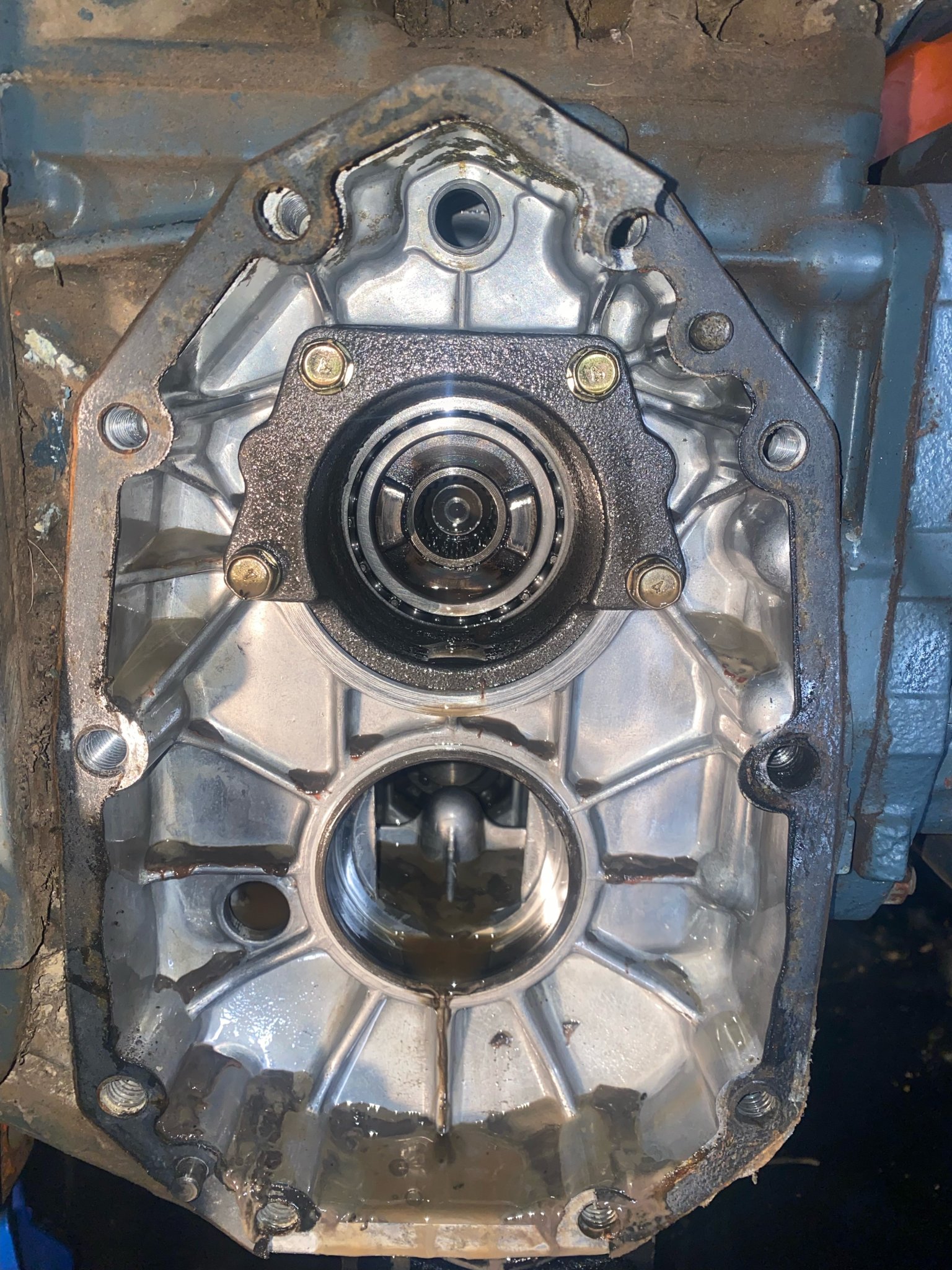

I drained the hydraulic fluid (as it needs changing anyway) I removed the rear right axel from watching this video
This was the hydraulic oil that came out. Does it look normal?
I noticed sludge build up in the axel case corners, I am guessing it is throughout other areas of the machine. How do you flush and clean the hydraulic system?

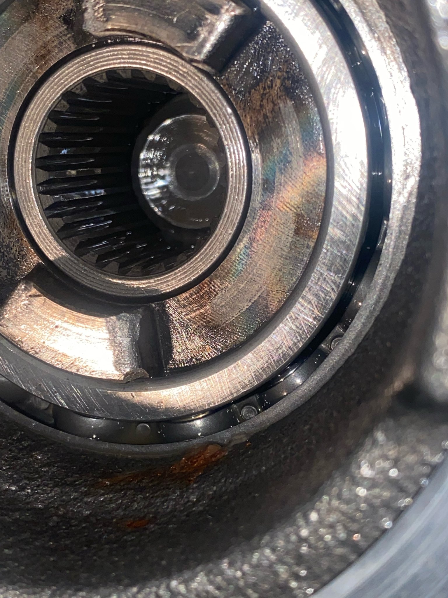

The teeth on the dog clutch on the diff case look slightly worn down on one side, I hoping this is not causing my diff lock not working problem as it looks like the diff case would need to be replaced?
The side with the spring looks like it is not worn at all.

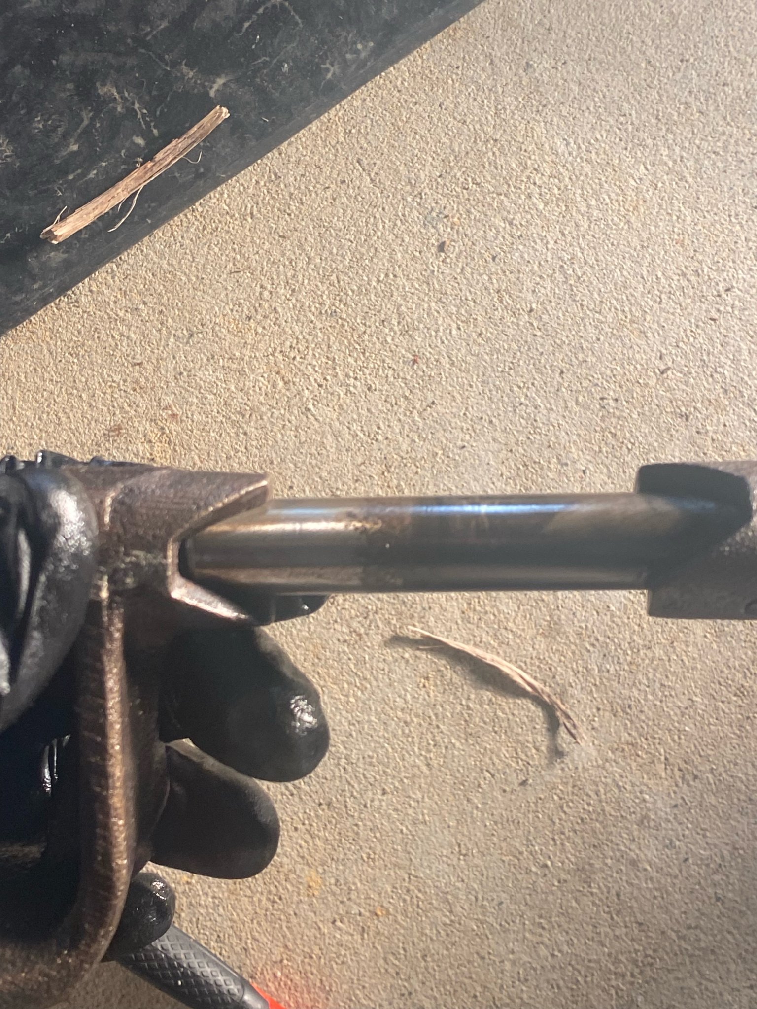

The only other thing that I found was the mechanism that engages the diff lock was a little rusted, it is also cast and not smooth which I found strange. The shaft was a little rusted and pitted. I cleaned the best I could.
I am yet to put back together to see if the diff lock will work. What do you guys think? Will I need to replace the diff case with the warn dog teeth?
Hate to say it but I think your problem is that damage to the differential carrier. Good news is its only $260.

The fluid looks like it is loaded with water and your tractor may be leaking water into the transmission case through the shifters or somewhere else if it was stored outside

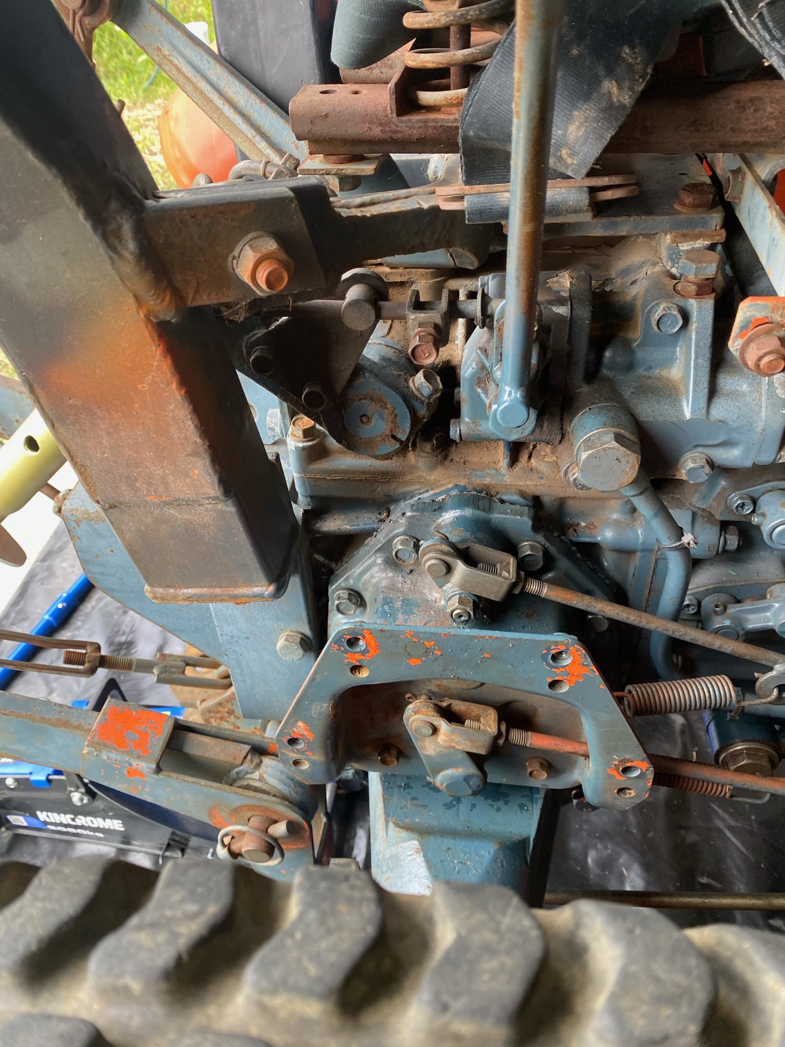

I think/hope I have fixed the diff lock issue.
I put the rear right back together and did a full services. Replacing all fluids and filters.
The diff lock pedal had about 25mm of free play before lever on rear right was engaged. Pedal was also hitting the mid mound mower hanger bracket.
Figured out lever on rear right was only moving 15mm. The service manual with the 3 parts seems to suggest it needs to be 23mm.
The adjuster rod was already maxed out, so I moved the lever position from pointing straight up vertically, to one spline position to the rear, this allowed me to adjust the rod out so there was no play in the pedal. The lever was now moving about 23mm and the pedal was just touching the mid mound mower hanger when fully pressed.
Photo showing new diff lock lever position.
I only had a change to do a quick test but it seemed to work more consistently in forward and reverse. I had the tractor at the bottom of a steep slope, slowly went up one rear wheel would spin almost instantly. Took foot off forward pedal, pressed diff lock pressed forward pedal both wheels would spin, took foot off forward pedal and then diff lock pedal. Pressed the forward pedal, one rear wheel would spin. I tried this a couple of times in forward and reverse and seemed to work as expected.
I am hoping that the issue was the dog clutch was not engaging all the way in and that is what rounded the corners of the diff housing side, and that there is still enough left on it when it is fully engaged.
I will test again when I have more time.
