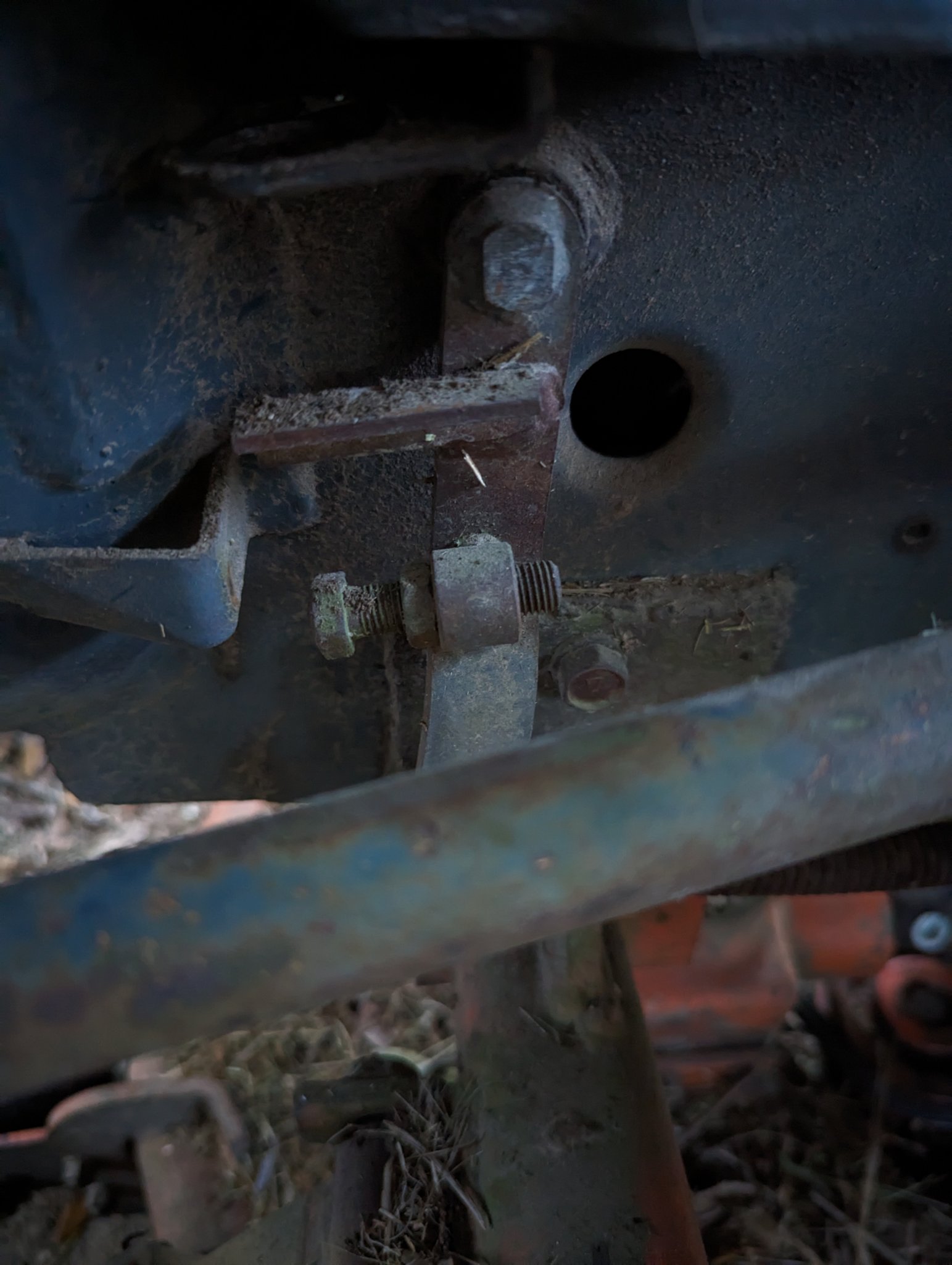

I have the Kubota B7100 HST-E and the previous owner ran a wire from the key to the I assume the starter, deleting the neutral safety switch. Now it grinds when I push in the clutch and try to change pto speed. I'm just checking to see if no safety switch causes the grinding or if something else could be causing it.

Switch not the problem - an adjustment of the clutch linkage would be my first thing to observe.
How much "play" is there in the movement of the pedal? If some - take it up and see if that helps the grinding.

I adjusted the bolt by the clutch pedal and the clutch no longer grinds. Do I keep adjusting that bolt to stop the pto from grinding or is there another bolt for that? Also thank you!

From your picture, your safety switch is missing. the bolt acts as a stop. the flat bar above the bolt trips the safety switch. Retracting that bolt will will allow the clutch to move further in the disengage direction.
It sounds like that is what is required.
The wire from the key switch to the starter, that is a new one….but since you do not have the safety switch I thought you could just join the two wires from the switch to over ride the switch...

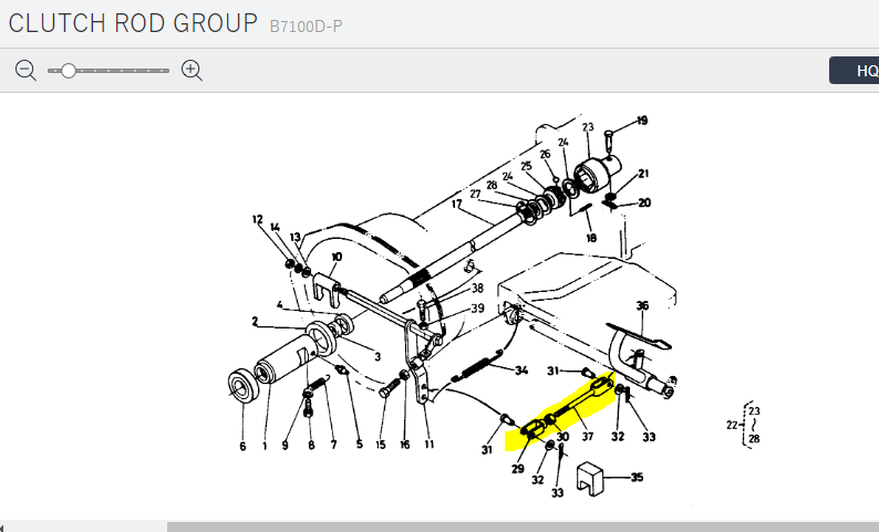

That picture is not the clutch linkage. The clut pedal has a rod attached that has something like a turnbuckle that makes the rod longer or shorter. Usually making it shorter will cause the clutch pedal to move the clutch plate farther which is what you want to avoid the grinding noise.
How far down does your clutch pedal move before you start to feel ext force to push against?

I'm not sure , I'll have to check to see if it grinds. It mainly grinds when I'm trying to engage my belly mower. I adjusted the bolt on the clutch pedal and got it to right before it tries to grind. Changing pto lever still grinds but I haven't adjusted the clutch linkage yet.
I downloaded the manuals as well. I had tried to rewire the safety switch but i don't think it works, I had removed it before the picture was taken. I'll just leave as is for now.

It had way too much travel in the pedal I've adjusted the bolt to what the manual said to and I still need to adjust the linkage.

You need to adjust this linkage not only the stop bolt.
And plan on doing a cutch replacement in the near future.
