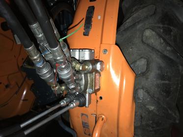

I haven’t found a cylinder cap yet, but I did get the loader hydraulics hose up by tying into the hard pressure line coming from the pump. The loader valve that I have has a built in relief, which I set at 1800psi. I was able to find compression fittings that would crimp to the hard pipe, and then go to my in and out hoses. I tested it last night and the loader works great! The nice thing about this setup is now I can run the loader and 3pt hitch at the same time, though very slowly I’m sure.
As for the cylinder cap / diverter valve, I no longer need the diverter valve, so I’m going to try weld the old cracked cylinder cap up solid, and if that won’t hold, than I may find a chunk of 3/4” aluminium and machine a cap.

Does your loader valve have Power Beyond? ie: 3 hoses: 1 from the pump, one back to the interrupted hydraulic line, and one back to the reservoir? Or just 2 lines, one from the pump and one back to the interrupted hydraulic line?
If it only has 2 lines, then I fear you are compounding the relief valve settings and may cause more damage. If it has PB with 3 lines, then the loader relief valve has an independent outlet to the reservoir and you are safe -- but, you cannot use both FEL and 3ph simultaneously -- use of the FEL will interrupt flow to the 3ph temporarily, until the FEL control(s) are returned to the neutral position.

The loader valve I have is a BLB BM20/2, pt number 905051. I’m not sure how it’s working inside, but it only uses two lines. Originally it was hosed from the diverter valve, through the loader valve block, and then back to the fill port on the transmission case. Now it goes from the pump line, through the loader valve, and back to the 3pt hitch control valve pressure inlet.
I have ran the tractor and it seems to work well, I put a gauge on one of the loader cylinder ports, and it’s set to relief at 1800psi. I’m guessing this means the loader valve is a open spool type. My only concern is that when the 3pt hitch hydraulics are activates, will the loader cylinders be backpressured?

Here's the problem: the relief valve in your control (1800psi) discharges to the 3ph relief valve. That's another, say, 1700psi for a total of 3500psi if both controls are operated simultaneously. That could lead to some serious damage.
You need to get a Power Beyond adapter for your BLB valve. The second hose, that you now have feeding into the 3ph, will be routed to the reservoir (add a 1/2" nipple and tee to the fill hole). Then you add a third hose from the PB outlet to the 3ph.
When the BLB valve is in neutral, fluid flows to the 3ph via the Power Beyond outlet. When the BLB valve is actively controlling the FEL, the 3ph is cut off and fluid is returned directly to the reservoir, ensuring the relief valve is not compounded behind another relief valve.

First looking at your broken part, it is screaming someone hooked things up wrong!! Too much pressure where there should be little.
The loader valve WILL be open center. You need a serious hydraulic system to switch to closed center such as a big excavator.
In the quote above you talk of changes of hoses connections to other ports being made. Sounds ominous to me.
Take some time and google "power beyond," or sometimes called "High pressure Carry Over," and read everything you can find on the subject.
There are youtube videos with animation which will be a big help in learning about this feature
Tank or return ports on any valve are not to become supply ports for another valve. Using them as such breaks expensive things!
This is where "power beyond" steps into the picture. The "power Beyond" sleeve connects into the high pressure side of the FEL valve where it can deal with high pressures. The return or tank port is in the low or no pressure side of the FEL valve block

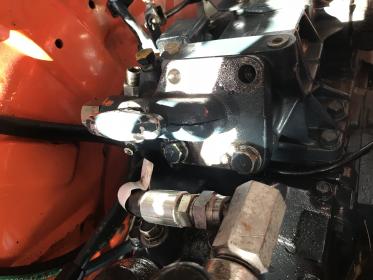

I have managed to make a new cylinder cap out of a 1.25x3.5x4.5 block of aluminium, using a lathe and a drill press. I installed new Orings, and it works perfect, Im very happy. I was able to rototiller the garden finally. That being said, Im still not confident the relief valve is working properly. The engine boys down heavy when the lift lever is partly engaged. Ive set the implement height stop adjustment so that it kicks out the handle before the 3pt hitch lifts all the way up, thus never maxing out the pressure, but tonight I plan to open up the relief and inspect it.
In other news, bad news, Ive managed to strip the threads on the hydraulic pump, the pressure side for the bango bolt. Im guessing I torqued it to tight, as it was dripping from the crush washer from day one. Im hoping I can helicoil the threads, as in put new threads in it, otherwise its a new pump?! This tractor is getting expensive, well my DIY fixing might be the source of the problem..
If the banjo fitting washer is copper, when you reuse it it should be annealed.
Annealing copper washers makes them soft and compliant to the two surfaces irregularities thus making a better seal.
Annealing is simple. Hang the copper washer from a nail or similar held in a vice. Slide the washer unto the nail so very little of the copper and nail surfaces and in contact. This step is necessary to have the copper washer not being cooled down through heat transfer into something else. For example, you lay the copper washer on the end of your vice because it is a flat surface. This will provide far too much copper to cold steel contact and the annealing process wont work.
The actual annealing calls for using a propane torch to heat the copper to a dull red and then withdraw the heat and allow it to cool slowly.
As soon as it is cool, it is ready to be reused just like a brand new washer.
Under the pressure of being squeezed in a connection, the copper becomes work hardened and no long able to conform to a new place in the joint.
