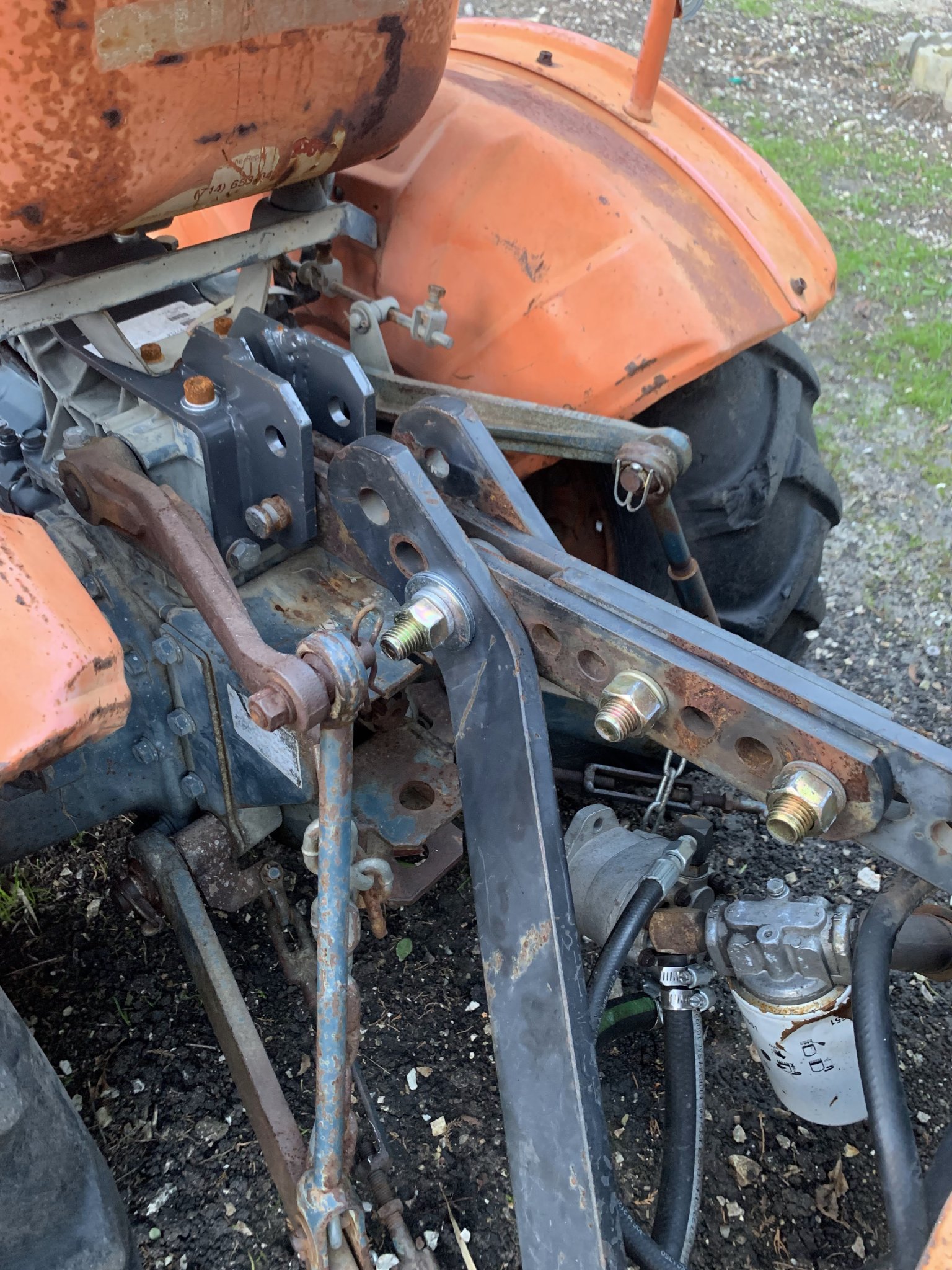

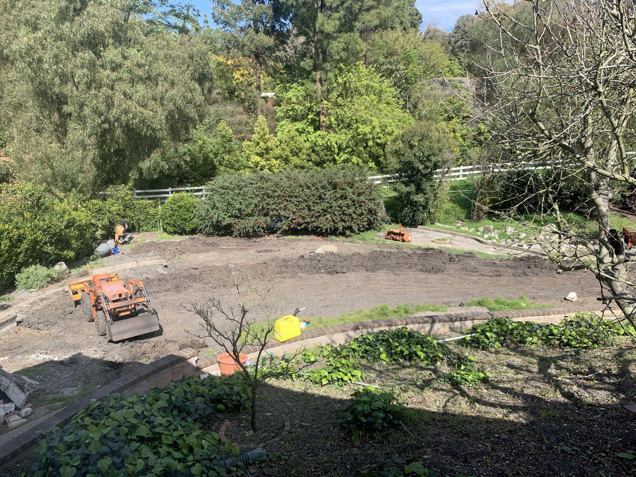

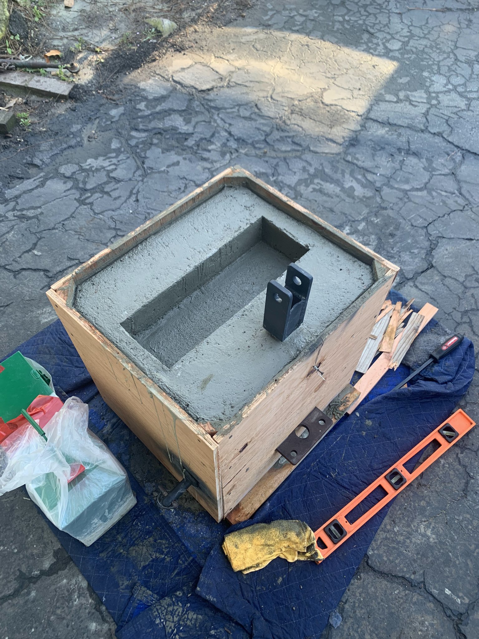

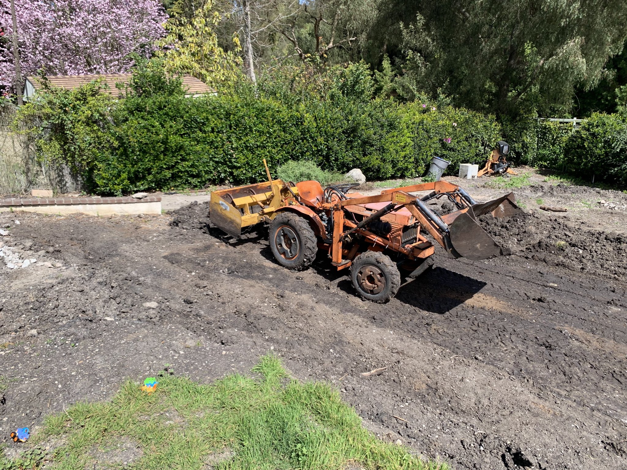

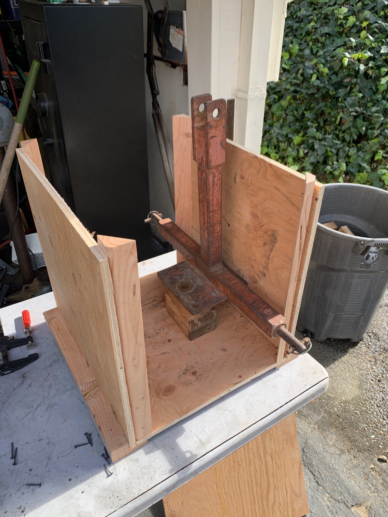

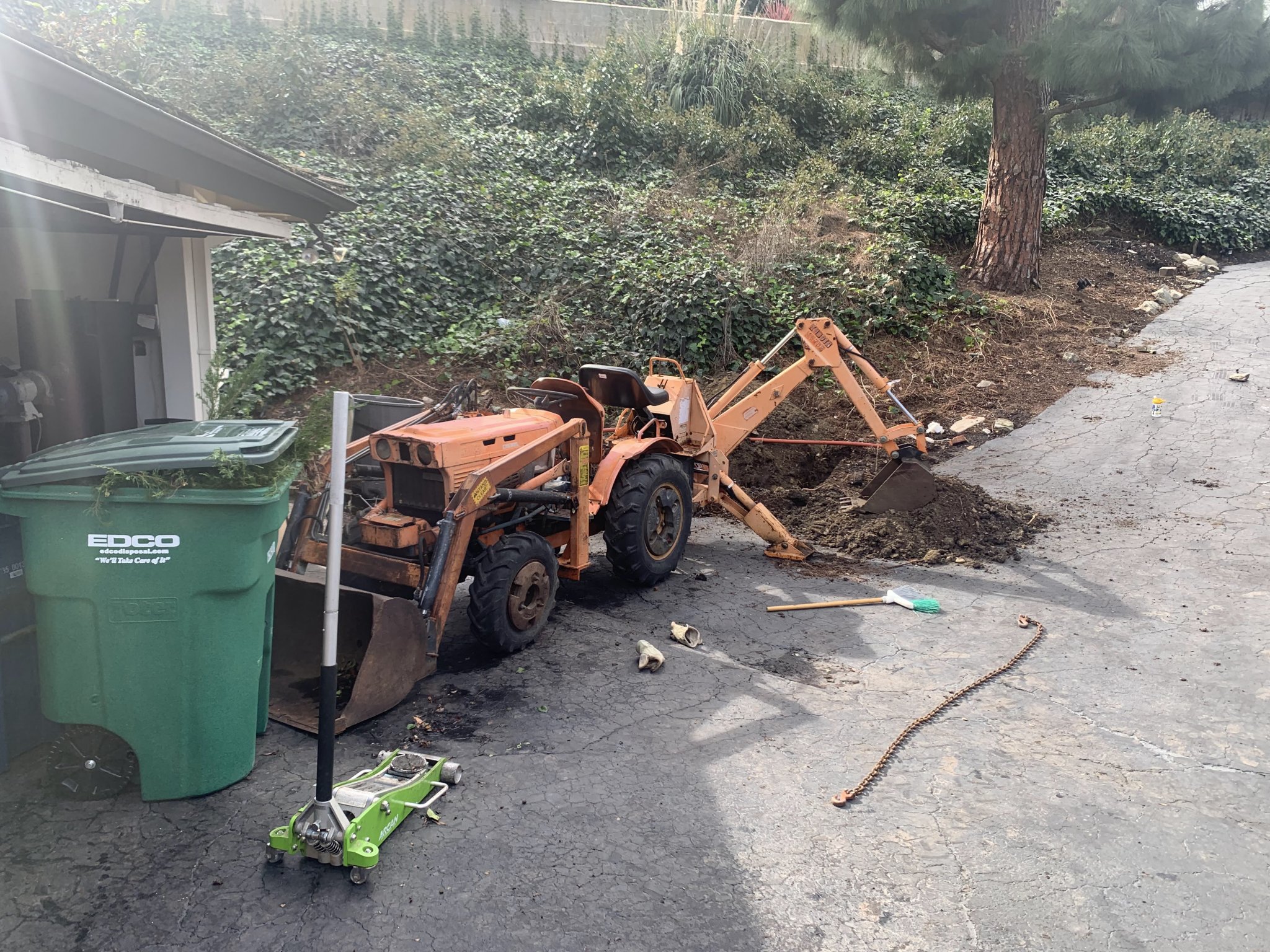

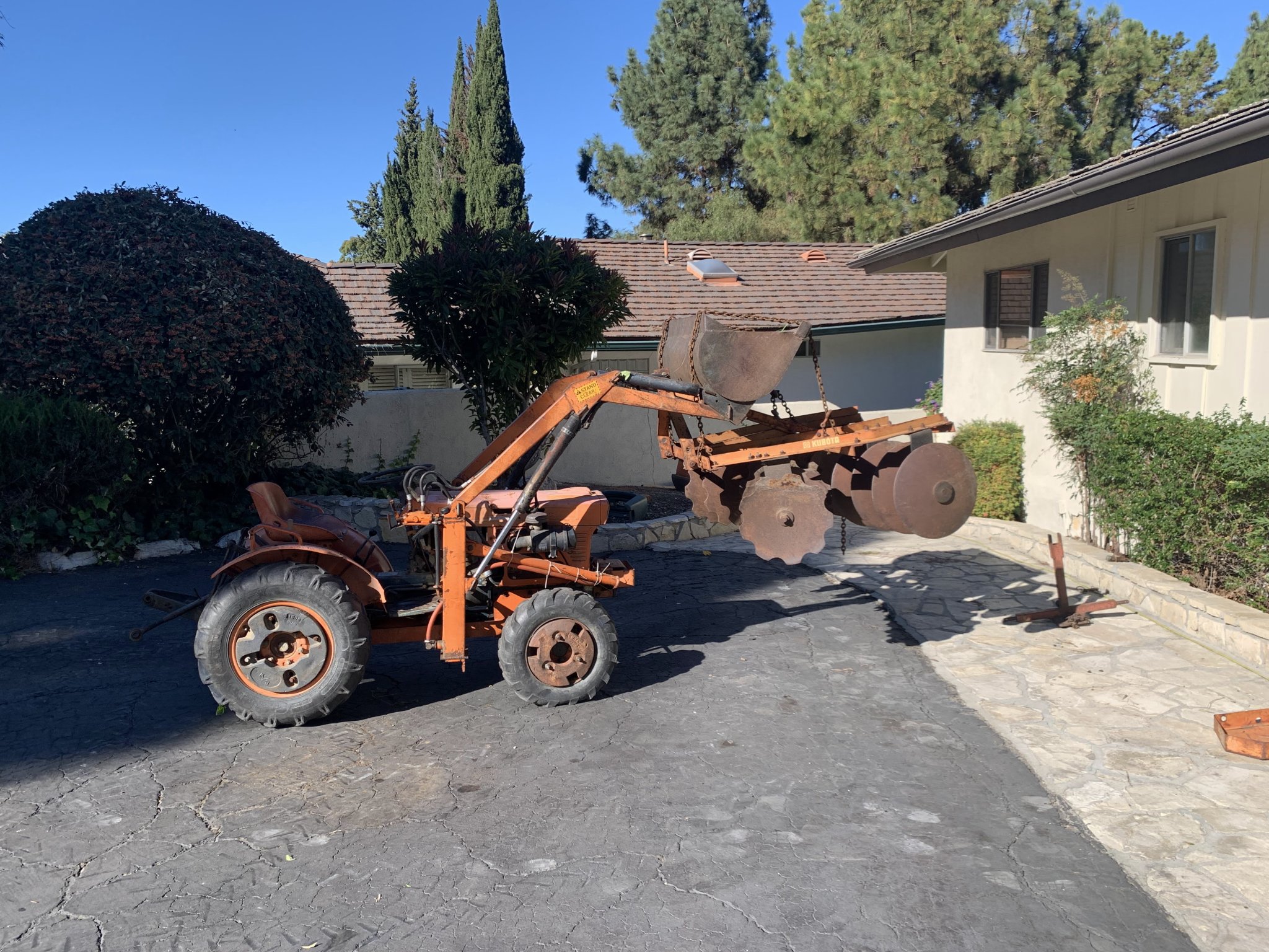

I feel like I owe some of you some photos so here we go!

Its not ideal but works surprisingly well. I am also not doing any loader work when I have the backhoe connected. I load the front bucket a bit for counterweight and that takes care of it being light in the front for moving around purposes.

Nice! I see you obtained or fabricated a nice HD top link bracket. Good job.
