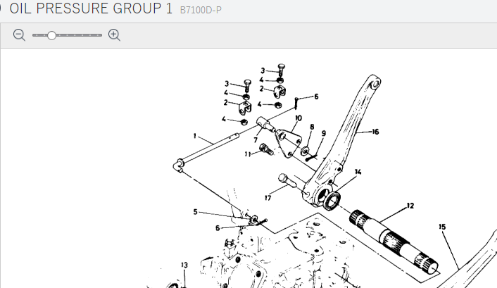

  3. The 3 point is working fine, but I noticed that the control rod (the one that has two screws to adjust the travel distance of the 3-P) is some how bent. are these available, or should I straighten it, or fabricate one similar?

  1. The 3 point is working fine, but I noticed that the control rod (the one that has two screws to adjust the travel distance of the 3-P) is some how bent. are these available, or should I straighten it, or fabricate one similar?
These are probably available but the rod has some bends in it originally so look for or ask for a picture of one before you straighten it.

This is what the three point feed back linkage looks like.
