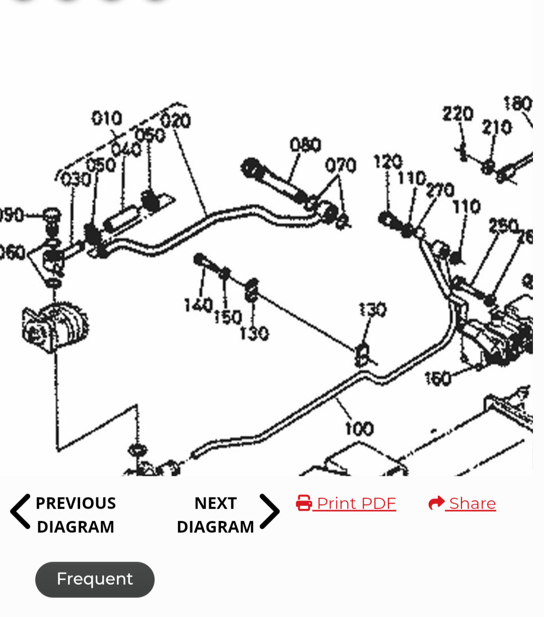

I’ve worked out how to do an engine oil and filter change, air and fuel filter simple (ordered genuine filters and o rings), it’s the gearbox oil change that I can’t find at the moment. There must be a filter/strainer but it’s not the same as the HST version.

Your tractor has a suction screen 080 built into the pump suction line. No filter. Pull it and clean it out while you have the fluid drained. You'll probably want to replace those copper washers 070.

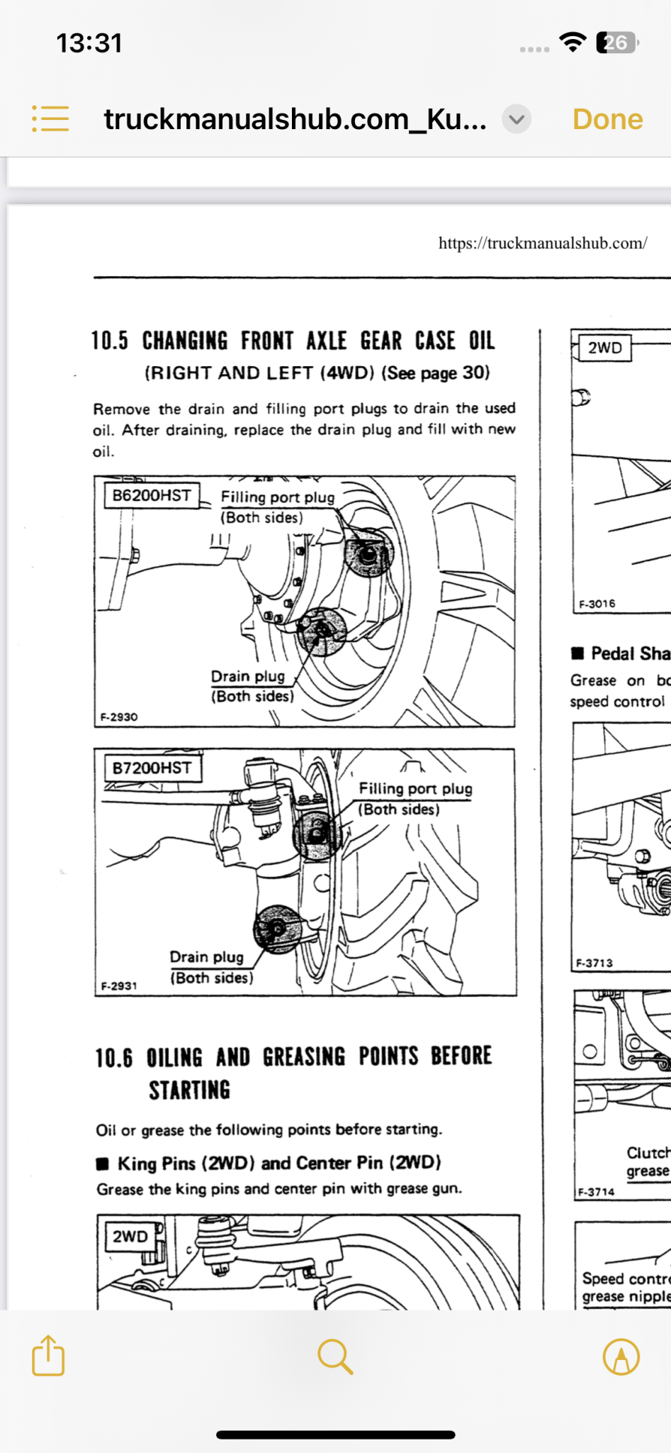

You may want to service the front axle, it's a separate system from the transmission/hydraulic system. There should be drain plugs on each side. Refill with 80 or 85w-90, whatever's close. UDT would probably be ok, but I'd go with the heavier gear oil.
fantastic thanks very much. Just need to find the fill/drain plugs and work out how much oil to buy….
Thanks. This? Is there a separate diff too?

If/when you change the front end oil = fill to the appropriate mark - run the machine a good while and then CHECK the level again. You will be surprised that full and in a little while, it isnt exactly full-full! You may need to top off the oil again.
