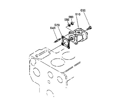

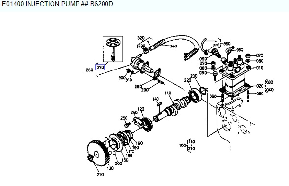

See jpeg exploded view and location view.
I ordered all the seals for this pump hopefully this takes care of my oil pressure problem.

The hydraulic pump is driven by fuel? :confused:
Your hydraulic pump is driven by the back of the fuel cam.
so when the main shaft seal goes out it forces oil into the engine.
PoTreeBoy, was referring to the fuel lift pump which is just below the fuel injection pump as a possible source of fuel being leaked into the engine.

No. There is a mechanical fuel pump called a lift pump between the fuel tank and injection pump. It's driven by a cam lobe, similar to cars with carburetors (except much smaller, I didn't notice mine at first). It uses a flexible diaphragm and if that diaphragm leaks it pumps fuel into the crankcase. Yours has a replaceable diaphragm - mine wasn't.
Some engines use an electric pump and some don't have a lift pump at all. Those obviously can't leak fuel into the crankcase.
