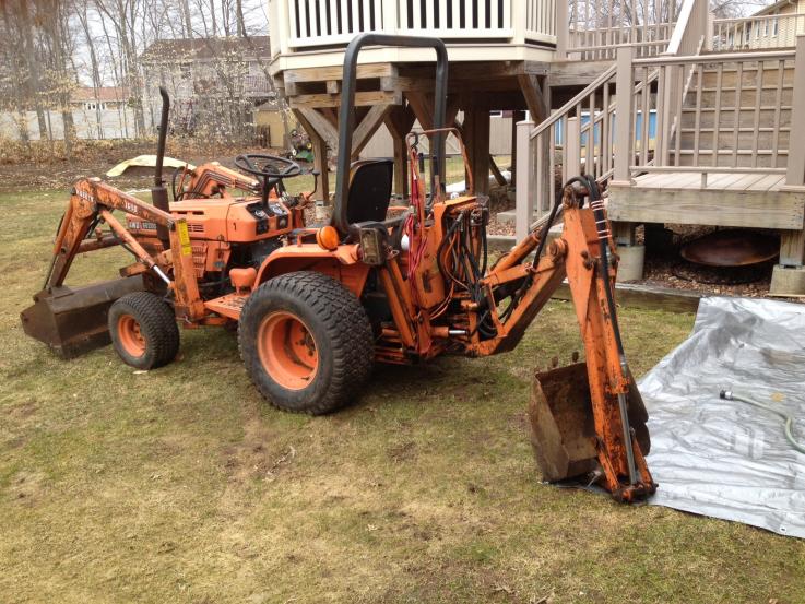

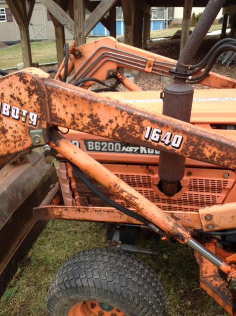

I have a Kubota B6200 with a well worn and sloppy B670 hoe:D I bought this from a Kubota/JD dealer who was only the middleman for the seller so asking certain questions was not an option, especially seeing that the guy (who works at dealership) I was dealing with and supposedly the dealership owner didn't even know what make hoe was on the machine! They thought it to be a Frankenstein type hoe from god knows what grafted to the 6200.
They both basically told me they were only selling the tractor and the hoe was just a + in the sale cause they didn't know what make or model it was and it needed quite a bit of work. I will say that the serial tag was missing off it but it was still the same faded Kubota orange paint that matched the tractor perfect!

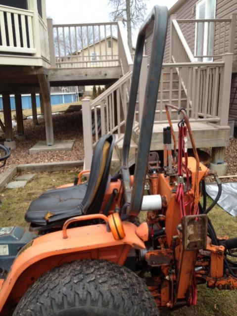

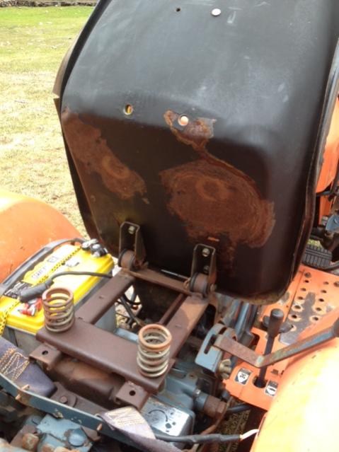

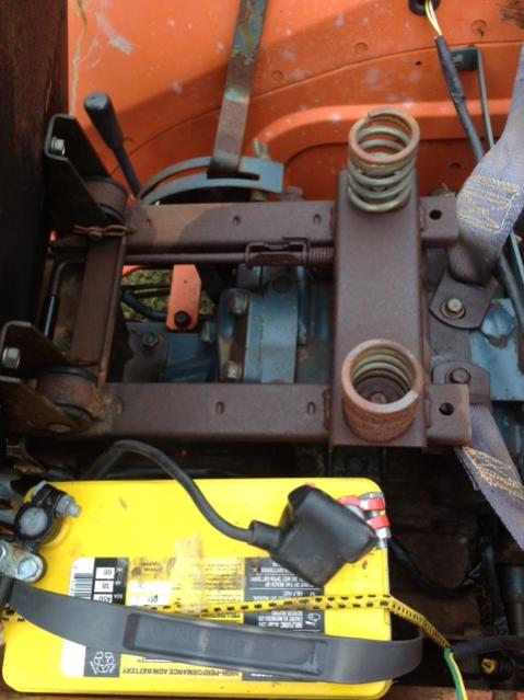

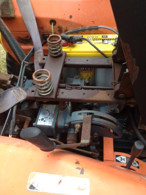

The seat on my 6200 (which I do need to replace also) does not have the right mount as seen in this thread http://www.orangetractortalks.com/forums/showthread.php?t=5482 that Lil Foot and Morson82 did a while back and I am trying to figure out my options for a flip seat that can be easily used in either the tractor or hoe operating positions as the hoe does not have it's own separate seat from the tractor and I don't believe there is enough room for 2 seats. I kick myself for not having pics to attach but will try and remember to take some.
Because it has the ROPS I am unable to just stand up and operate the hoe as I was originally thinking that was how the old owner used it but when I got on it and tried to stand the ROPS was in the way. I really have no idea how this guy used the hoe??... unless he is 4 foot tall!:p

Welcome to OTT Dave and thanks for the pics. How well does the tractor run? How many hours?

The tractor itself runs great everything seems to work on it except for the decompression cable (frozen). I don't see any fluid leaks from the tractor either. HST seems good as well.
It says 872hr but I am thinking it's more like 2,872:D I just need to straighten up the exhaust pipe (that what you call it?)
Service Dept Vic,
Thanks for the compliment! She's definitely no beauty queen and has been worked pretty hard! Plenty of slop in the FEL bucket and in many joints on the hoe but hopefully she will hold together long enough for me to do some projects (patio/walk way/driveway/etc,etc) and fix her up a little at the same time.
When the pump for the hoe is running off the rear PTO it's all egg shaped and wobbly but works. When everything on the hoe is curled up and pulled in so the tractor can move around the the hoe will not stay up and it starts dragging the bucket on the ground after a few minuets. The controls for the hoe are also leaking fluid....pretty good from one of the outrigger controls when it is used. I would like to rebuild that whole control block with new O rings and what not but not sure if it's a DIY job for me or not.
