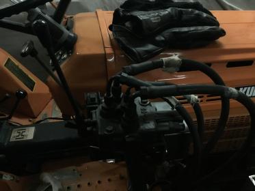

Thanks for the response Dave. It is the original valve for the blower. The parts diagram lists it as a single spool valve. I can tell you it has detects in both directions though...pics attached
If it s the original valve, it makes sense that when the blower was down you would want it in the float position so the blower is not lifting the front wheels off the ground and you loose steering.
You say "New" but I assume new to you.
I am trying to imagine a mounting of the valve body and the lever to see if it could be reversed that way. Picture the lever pivoting above the valve spool instead of below it as shown now. When you push the lever forward, it pushes the spool forward which would be the opposite of what is now occurring.
Is there a name on the valve body?
Your pictures were very dark. I lightened them but the resolution is too low to blow them up to see more detail on the valve body. Could you try and improve the photos of the valve. The cylinder is not important.
Where does the FEL valve supply come from and where does the return go?
Look this image over carefully. I think it shows how you can reverse what happens when you push the lever forward of pull backward
