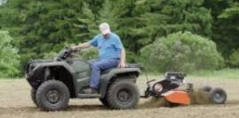

if you wanted a foolproof solution you could go with a tow behind roto tiller. They come with their own usually gas mounted engines.
36" usually about 6-7hp and a 48" usually comes with a 12hp honda or B&S style gas motor.
they work great. Maybe a few bucks more than pto driven but a sure fire solution that would work.
