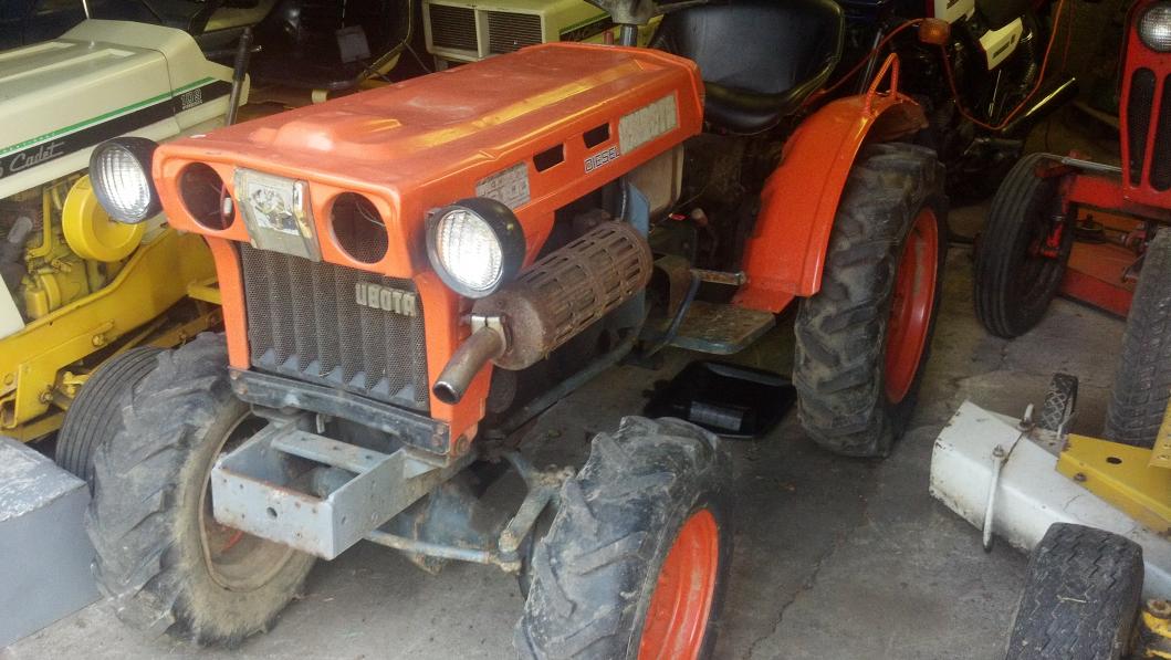

Pic's please!
Here is mine yesterday
kubotab6100d
