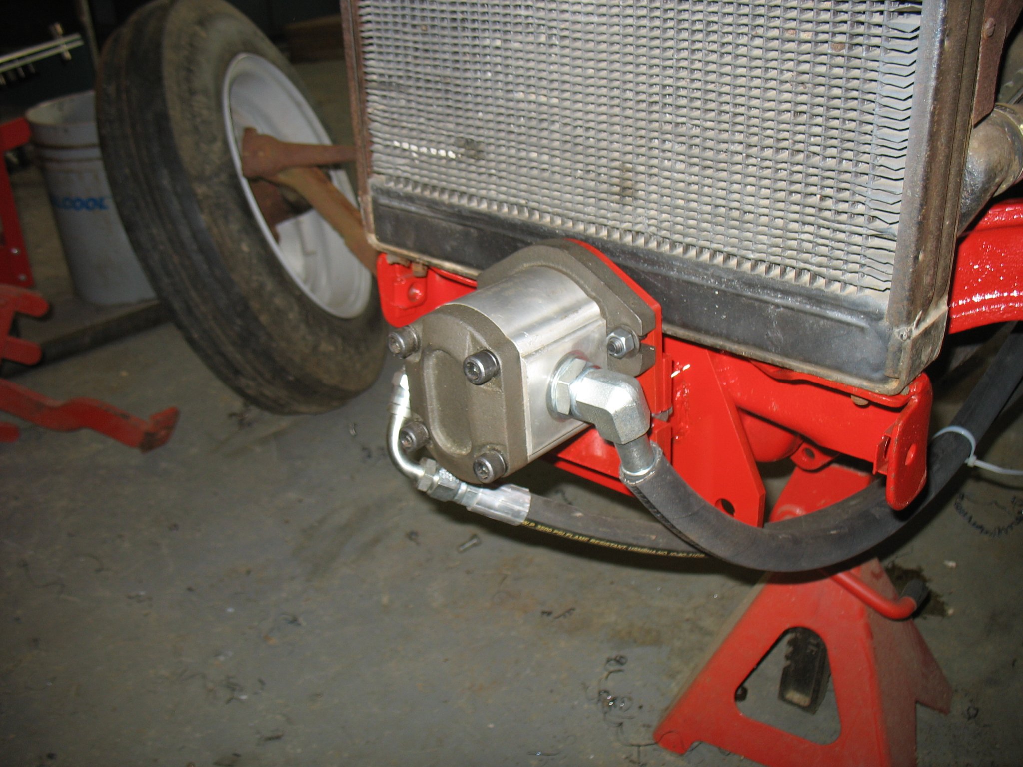

Its relatively easy and inexpensive to build a crankshaft driven pump from scratch. I have personally built dozens
