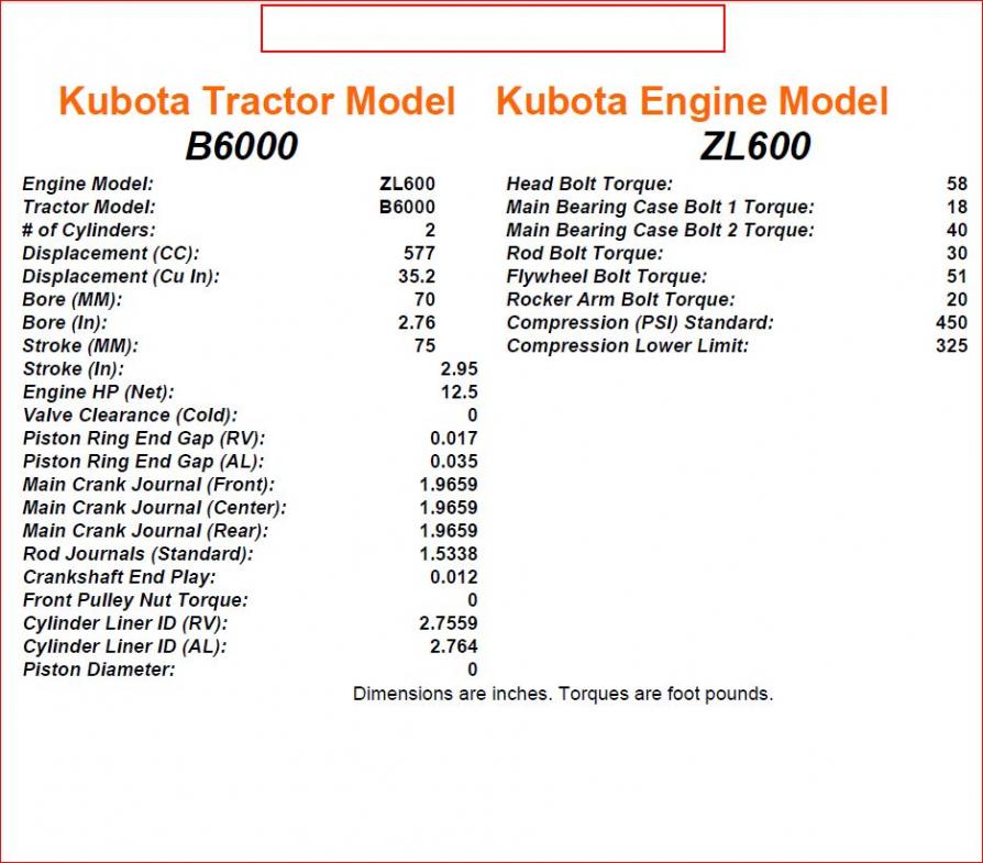

Hi guys, Im in the process of re ringing my B6000. I have a service manual, But I cant believe how crappy it is. gives no torque values at all, well for the head bolts it does but nothing more. does anyone know what the torque of the connecting rods should be? and what the clearances should be at the rod bearings? Thanks.

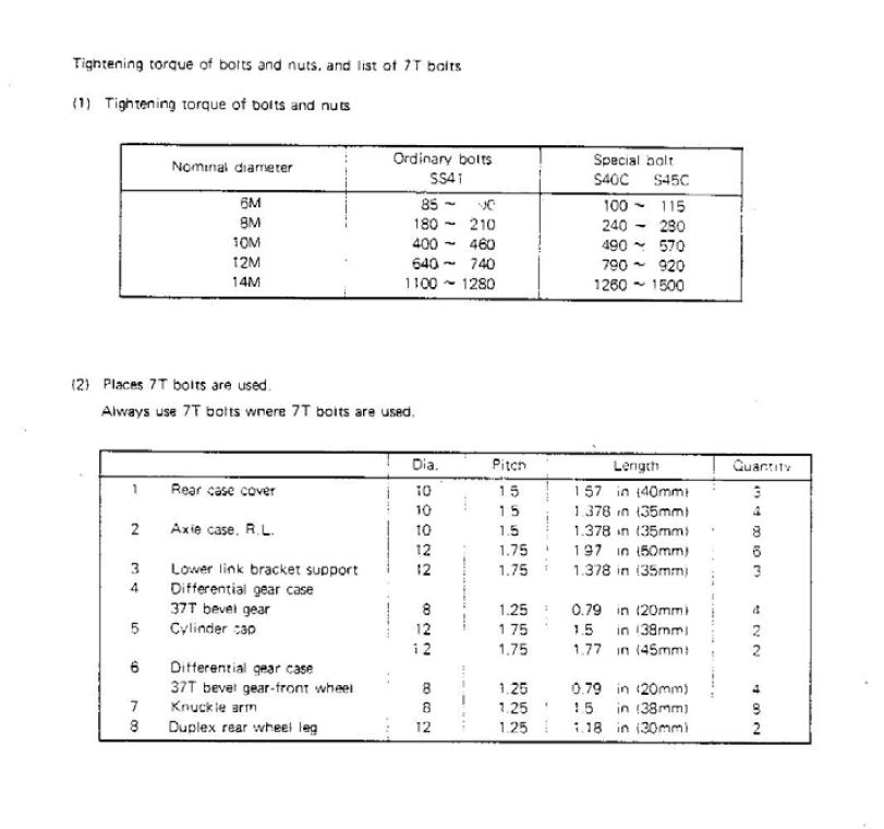

Reviving this old thread for a couple of reasons:
1) The B6000 service manual does include torque values, as attached
2) Anybody know what units are used? There is no mention of this anywhere in the manual. Say, if it's in lb/inch, the torque for M12 7T bolts would be 66-77 lb/ft. This looks too high compared to other Kubotas torque on aluminum. Could anybody clarify / confirm this?

Thanks again Wolfman!
That does help, so I can calculate the torque from the table and then subtract about 10 lb/ft.
