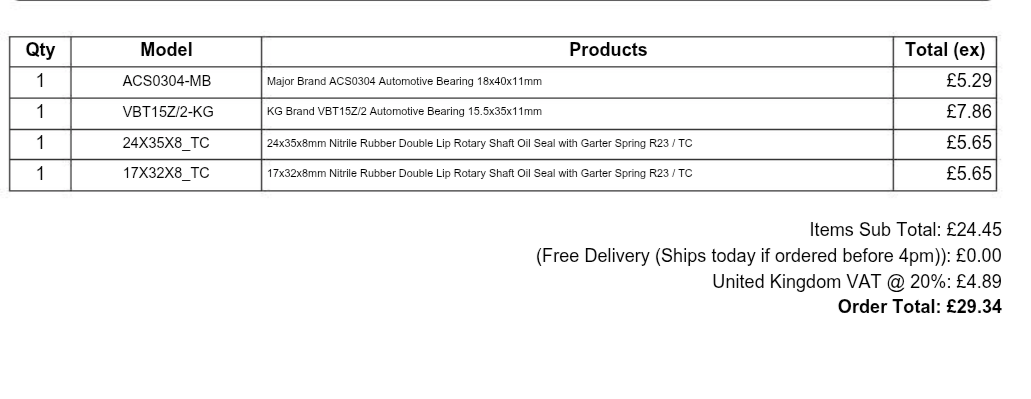

Hello!
It's a long shot this as it's a while since you posted the above and am just hoping you pick this up!
I have exactly the same steering box and am struggling to source the bottom bearing in the UK. Do you have a record of the bearing numbers you used?

Hello!
