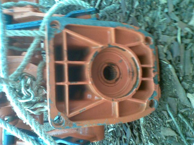

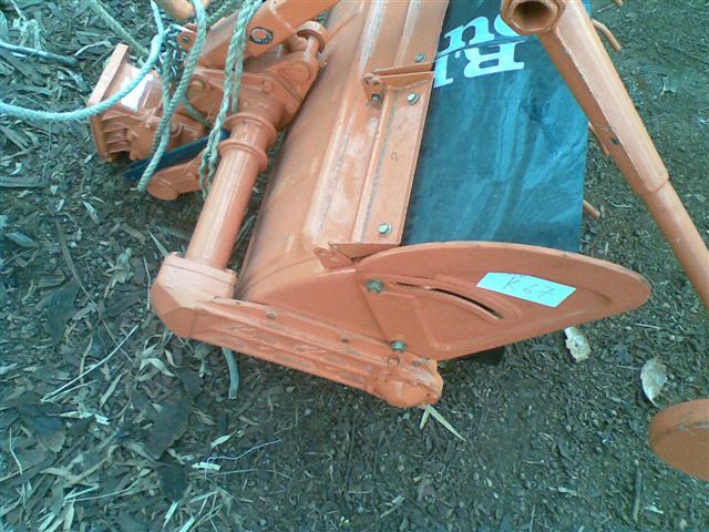

Hi
I recently purchased a rotary hoe to hopefully bolt onto the back of my b6000 - it looks like it will fit but I haven't had a chance to try it yet. Anyway it has no markings on it what so ever. Can anyone out there tell me what model number it is? and also if there are parts and operating manuals available? Its been roughly re-sprayed and new bolts put in it and is an import of some sort I think. It looks like they have used grease rather then oil or a very thick oil for the two top sumps and I'm wondering what oil should be used. Its tines look different to standard grey market though - but they are new and probably after market fitted.
Anyway hopefully someone can tell me what model number it is. Also is this rotary hoe user adjustable to till CW or CCW?
Thanks for any help.

Thanks Vic
I mounted it today to my B6000 and it works fine. I bit of a two man job putting on and off as it is not a 3 point linkage but it really works well tilling the ground.
Is the S850 the same as an SF850? Do you know of a parts manual for the S850? I will put in 80W/90 gear oil and see if she holds. It does appear to turn freely and with no grinding.
Also what did surprise me was that even though the B6000 pto turns CCW. The actual rotation of the tiller blades is still the same direction as the wheels - for same reason I thought it would turn against the direction of the wheels because of the CCW pto. Anyway it sure does a good job anyway.
Cheer John

Yes, rotation direction is same as wheels, you will be making your own rubber flaps as they were OE on the JDM tillers only, and a manual is available. Let me know if you need one, send me a PM.
