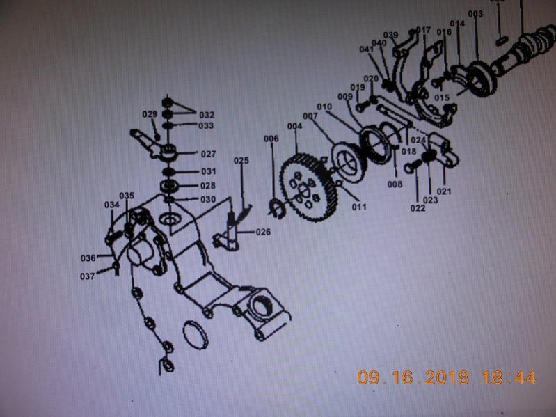

Well..it is item '25' of the fuel camshaft group of the B6000 parts manual. I just spent 30 minutes attempting to get the image here from my computer, with no luck at all. Will try again tomorrow night.
As an official 'old guy'..I have no idea whatsoever how to make a computer do much of anything..sorry.
zuric
L2050DT, B7000 grey mkt. ! Workbull 202 Massey,650 John Deere, 3444 Int.
Feb 12, 2017
42
Ava Mo.
Sorry it took so long. Hopefully, there actually is a picture of the spring, and position it occupies in the scheme of things...Item 025, by the way...

So I'm not 100 percent I got it all hooked up correctly but the rack pin sits in the groove for the governor lever but my front pin didn't have a hole in it for a spring. I got a spare one that did from someone on here however I remember trying to put it on but not being able to figure out how it was supposed to work. And it seemed to me that it would be giving me the opposite effect?? It's been awhile so I can't exactly remember what I found to be the issue.
32,814
8,315
There are 2 pins (well one adjustment bolt and one pin) in the front cover.
And yes you will have all sorts of issues if the start spring is not in place, or hooked up right, not only starting issues but run issues too.
Post pictures of the front cover.

Wouldn't I need a different governor fork to hook up that spring? Because I don't see where it can hook with my current lever.
32,814
8,315
Since your engine did not originally come with a start spring on the front cover I don't think you need it.
It's sounding like you have a grey market b6000, the difference between the grey and US model, is just some minor motor differences.
Let me see if I can find blueprints on the B6000 Grey engine setup.
