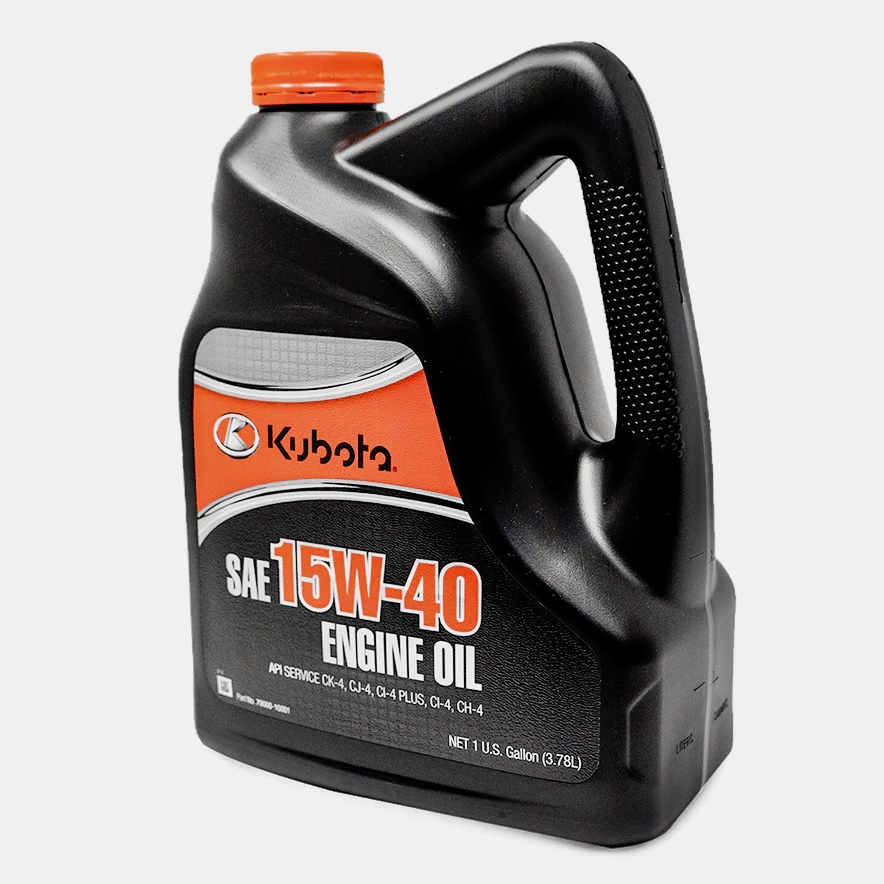

(15W-40 is suitable for most ambient temperature ranges, which is why it is so popular…
check with your Kubota dealer…to see what they carry for customers…. and you’ll likely find their Kubota oil is: (but use any brand you like)
