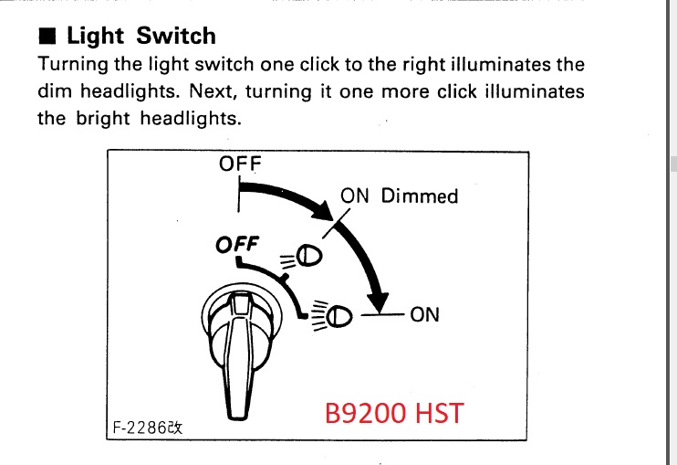

I continue to be puzzled how on the B6000 the headlight switch can produce 2 levels of brightness.
I wonder if the correct headlight switch is installed in the B6000 as the Operators' manual only shows a two position switch.

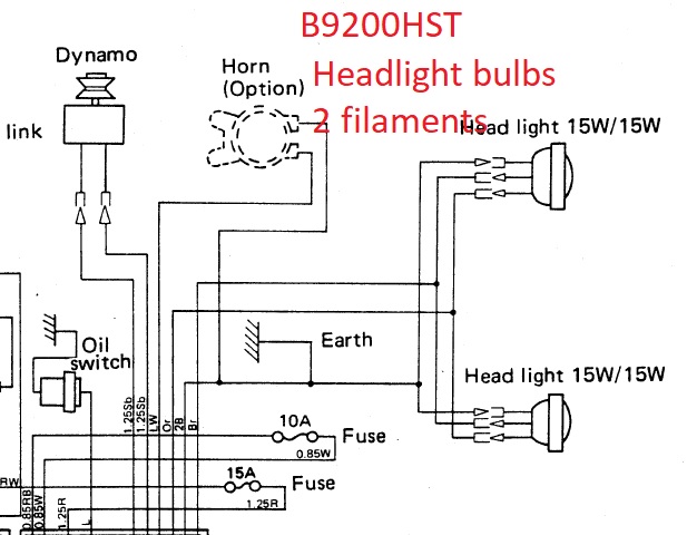

If you look at a later B model, namely a B9200HST, its headlight switch has the 3 positions b ut this is matched by headlight bulbs which two filaments.
None of this is particularly important as the three wire dynamo only had a short life with Kubota. John Deere uses a much higher output 3 wire dynamo on its newer tractors.

The elect schematic above shows a dual element bulb…in which case the 1156 is an INcorrect bulb.

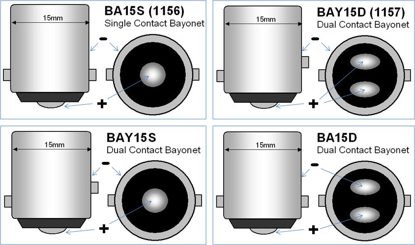

The socket from my recollection is same confiuration for the 1156 pin type so??
Not sure what you’e asking by “so??”… but, for example, an 1156 socket would have a SINGLE contact inside its’ base…while an 1157 dual-filament lamp (which outwardly has a similar appearance) will actually have TWO contacts within its’ base. Furthermore, the 1156 socket (BA15S type)has accomodation for two pins in its’ sides that accept the 1156 equi-depth pins of the lamp…while the 1157 socket (BAY15D) type) has similar accomodation for two pins…but those 1157 pins are at different depths so that the lamp can only be installed in the correct orientation for the differing levels of illumination of the dual filaments.
See this illustration for the differences:
Oldie68
B6000
Nov 21, 2021
60
Yarker Ontario Canada
Not sure what you’e asking by “so??”… but, for example, an 1156 socket would have a SINGLE contact inside its’ base…while an 1157 dual-filament lamp (which outwardly has a similar appearance) will actually have TWO contacts within its’ base. Furthermore, the 1156 socket (BA15S type)has accomodation for two pins in its’ sides that accept the 1156 equi-depth pins of the lamp…while the 1157 socket (BA15D type) has similar accomodation for two pins…but those 1157 pins are at different depths so that the lamp can only be installed in the correct orientation for the differing levels of illumination of the dual filaments.
OK thank-you for the illustration. I believe from recollection the bulb and socket is a BaA15S 91156) single contact bulb, as I attempted a couple of 7056 LED bulbs but didn't quite work as I had expected. So these I know are the BA 15S type base/contact.

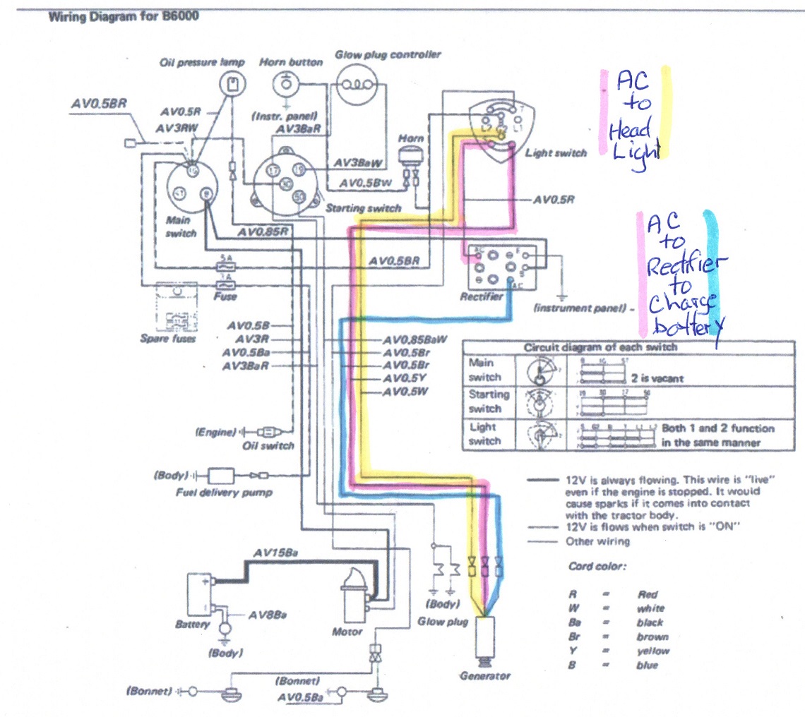

I have marked up the 3 wire B6000 wiring diagram in two formats. JPEG and pdf. The pdf is attached and the JPEG is immediately visible. Depending upon your computer and printer one format may print more clearly than the other.
In the box showing the circuit diagram of the Main Switch, the Starting Switch and the Light Switch the light switch box says both positions 1 & 2 are the same. One position is not brighter than the other.
The dynamo is putting out 3 phase AC voltage. One pair of these phases is used to charge the battery thru the rectifier. These are colored Purple and blue,
Another pair is putting out AC to the headlight. These are colored Yellow and Purple,
If you try replacing your existing headlights with LED's most LED's wont work on AC. A few owners have reported success with LED's but I have not seen this myself but these products are always evolving.
The headlights are not high and low beam. The headlight brightness will increase with higher engine rpm.
Dave
From what i can see. The headlights are not AC powerd but just 12V DC.
I don't understand why, but it seems that the yellow and purple indicaded generator leads are short circuited when you turn the lights on.
