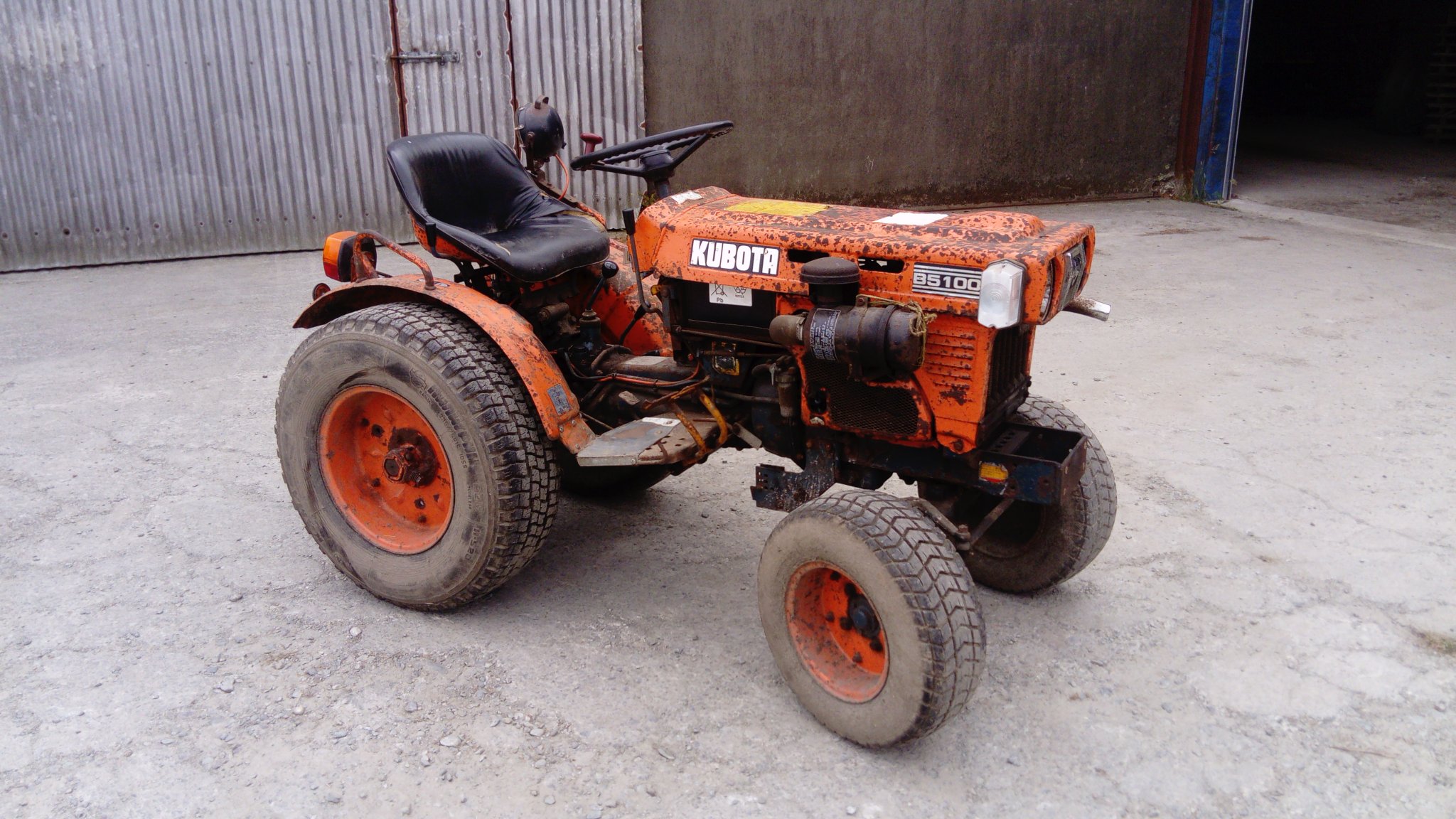

Hello all, this is my first thread so I am thankful for any help I receive. (Greetings from Ireland!)
While doing a somewhat restoration on my B5100, I couldn't find any front hazard/marker lights anywhere online, so I decided to leave the original ones in place, they had a few small cracks in the lens, but nothing like original lights, eh?

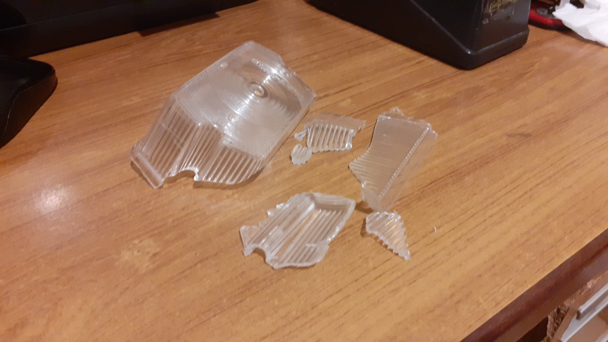

Anyhow, while my brother was pushing in silage to cattle the other day with the tractor, he accidentally clipped the right hand light on a pallet and broke the plastic lens. The bulb etc. are all still working. I understand that these rectangular lights were fitted to B5100s, B7100s, etc., maybe more models? but they aren't present on every example I see (perhaps a factory option??). The bulb has two filaments, one used as an blinker/hazard and the other used as a marker.
They are two numbers on the lens, (6097R6-7097R7 and STANLEY 041-0020) I have spent several hours searching online, to no avail. I wouldn't mind having to buy a whole new light assembly, if they are available.
If anyone has any info, please shout. I have attached photos of the tractor before the light got damaged, and the state of the lens now.

Can't help with a source, but I have never seen those on any tractor before- maybe it's a european only feature?
Sure looks like someone added some aftermarket lights.

I am with Lil-foot - they do not look to be original OEM parts - then again things are different across the pond!
EDIT:

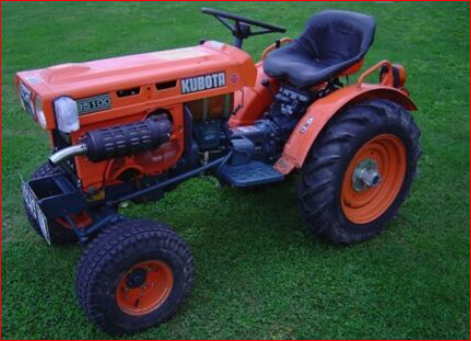

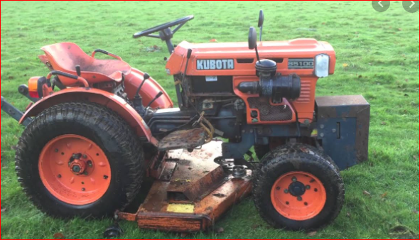

BUT - we are wrong - they are OEM - pictures from the NET
I think - rather than hunt down the replacement if at all possible (I looked and could not come up with a the light or OEM number) - it might be easier to replace both with another pair that will serve the same purpose.
I stand corrected, learned something new today!
Must be a non US thing- none of my many manuals or brochures show lights like those.
10,969
2,816
Bill, - I actually found it in a manual ...... shocked the sheeeit out of me too!

I doubt these are still made so you may wind up having to replace both lights with something else that covers the area these were mounted to.
Your B5100E is in nice shape...a lot nicer shape than mine but I wouldn't get rid of it for anything, a great little machine perfect for small spaces and plenty of power for the size.

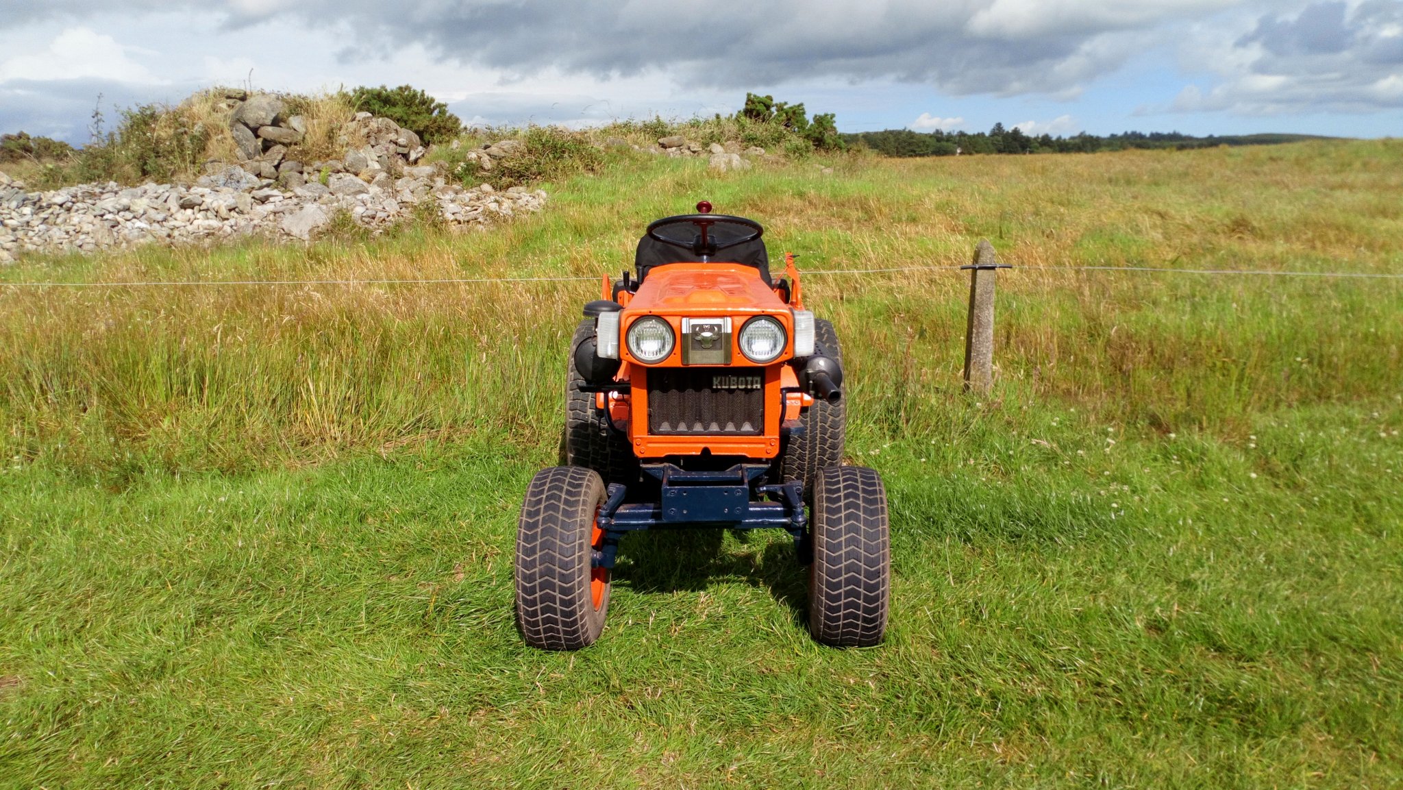

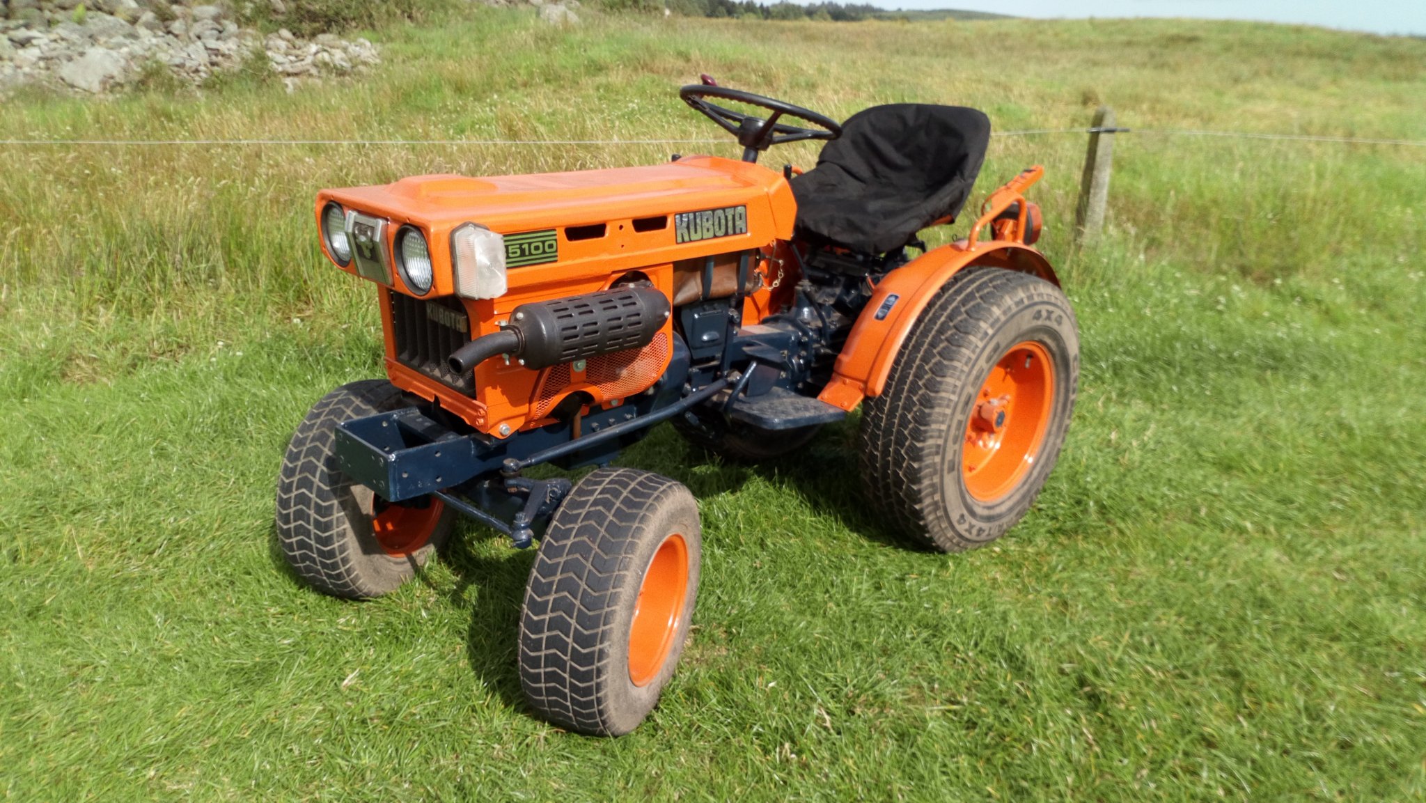

Thanks for all your replies, some great people here. I might try contacting Stanley tonight to see if they can help me.
As you guys say, I might just have to buy similar replacement lights. I have looked at several parts diagrams for the B5100 and B7100 and them lights aren't mentioned anywhere, maybe it is a European thing.
P.S. The tractor doesn't look too bad I agree, take a look at it before i started working on it! Far from perfect now but hopefully protected from rust for a while at least.

Wow...Great job on the restoration.
Since you restored the machine I am assuming that those lights have not been on that new paint for an extended period of time so there is probably no paint fade around the light , So replacing them should be a matter of finding a set of lights that cover any screw and wire holes inside the footprint of the light where it mounts to the hood.
On your before pic is that a rear facing spot light on the left hand side, My B5100E has a spotlight on the right hand side, It has one red marker light on the left hand side of the seat and the spotlight on the right hand side of the seat, I am pretty sure they are original equipment.

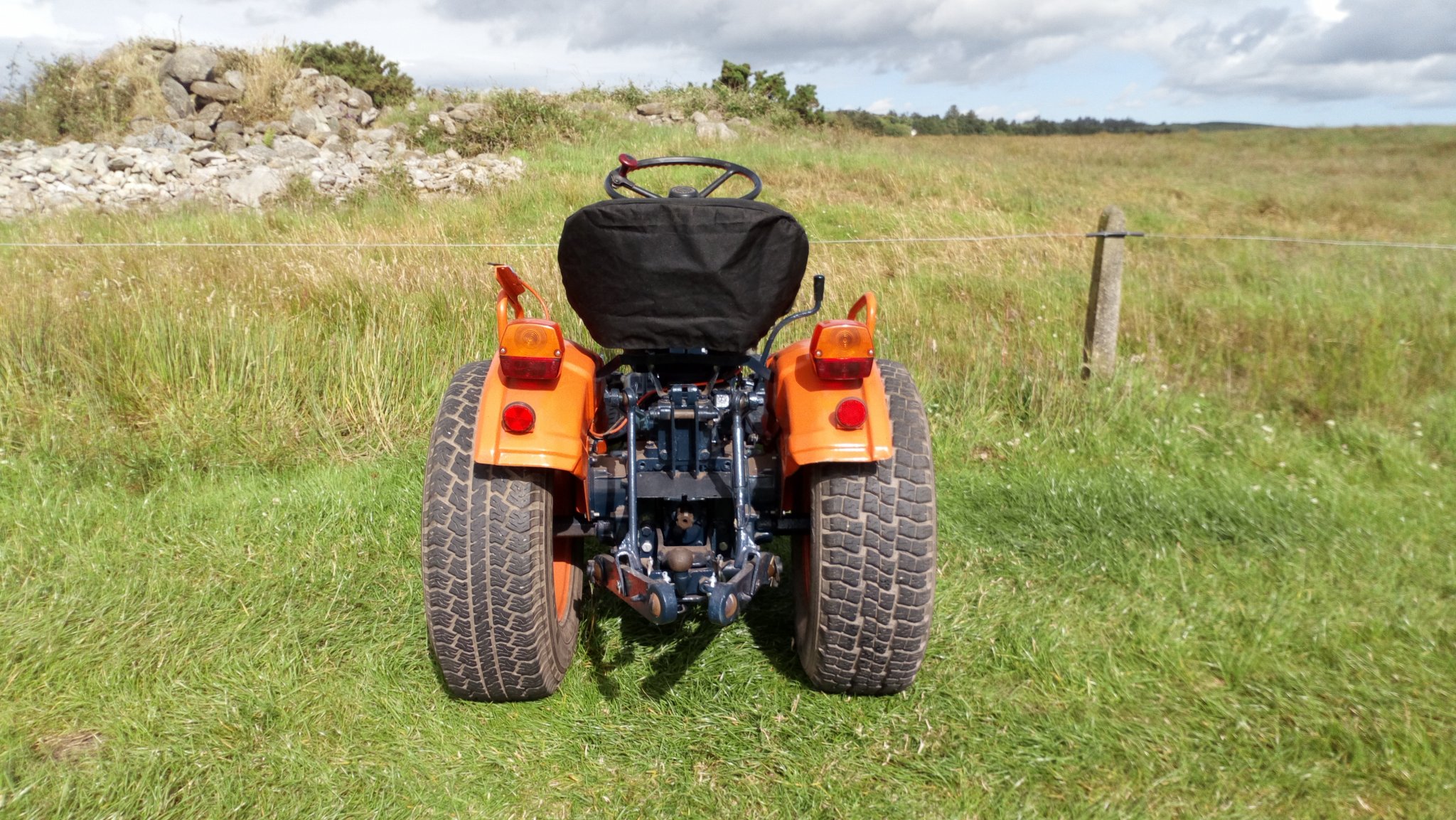

I can tell you for sure that the rear spotlight was added just before my uncle bought the tractor second hand. It was mounted on a piece of angle iron welded to the left handrail with a very shaky hand! The bracket is still on the handrail, I just haven't restored the spotlight to fit it yet.
The tractor also has marker/blinkers lights on both sides (attached below)
As for the paint job, I was pleased with the job I did, however I have spotted a few spots on the hood where rust seems to be bubbling the paint, I might respray it in a few years again with some more effort on surface prep....

**UPDATE**
Went to see the guy who the tractor was bought from originally roughly twenty years ago. He still sells and repairs anything with a small engine, and has many old stock parts on the shelf. Turns out he had a replacement lens on the shelf. €40 later and I had the part in my hand. He was kind enough to ring the local Kubota dealer who said that the lenses and lights are available, but i would presume that they aren't a regularly stocked item.
The OEM part number for the lens (written on the packaging) is 66706-55980. After a Google search it turns out that Messick's have a listing for it, although I'm fairly sure they don't deliver across the pond.....
