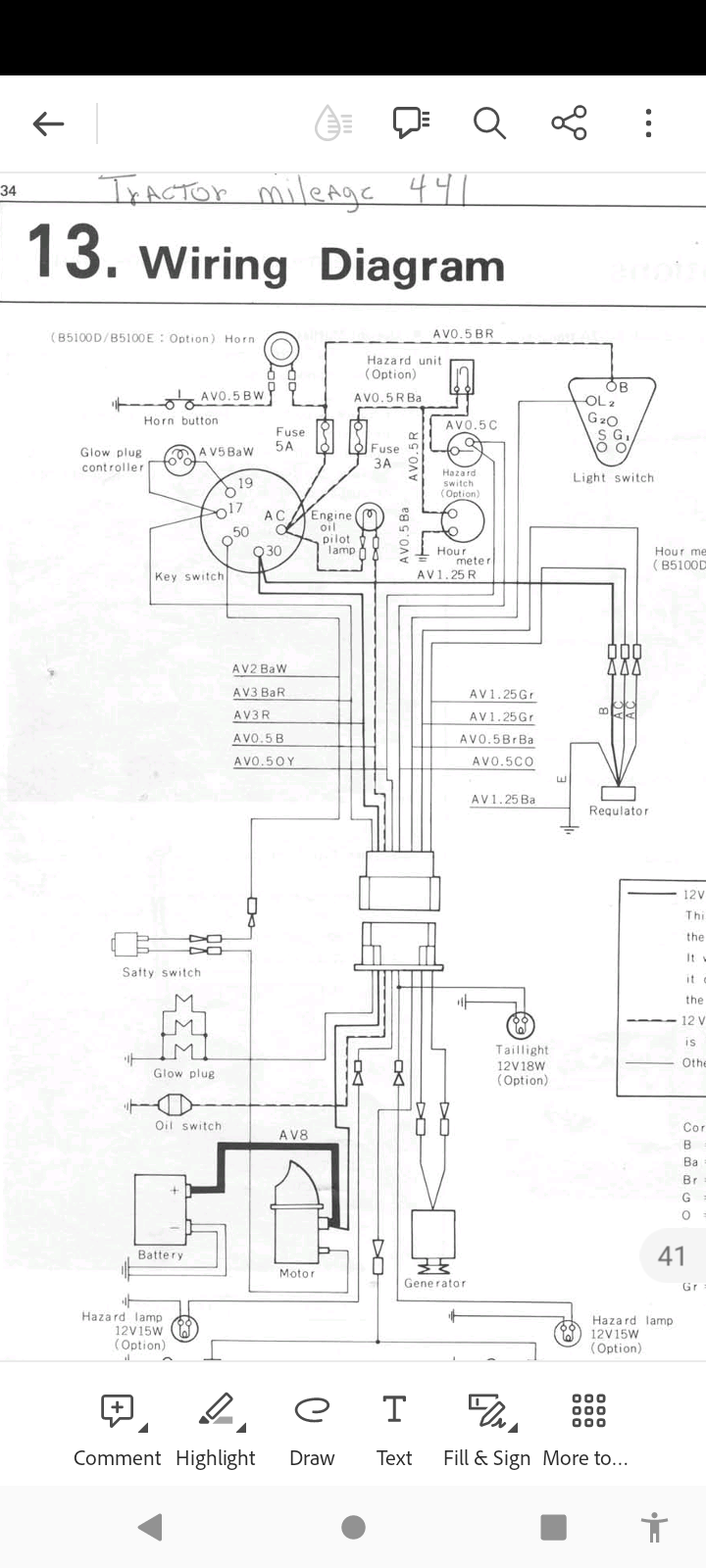

if you can post pictures of the starter solenoid wiring and the dash showing the switches I can give you more detailed information (or post a wiring diagram).

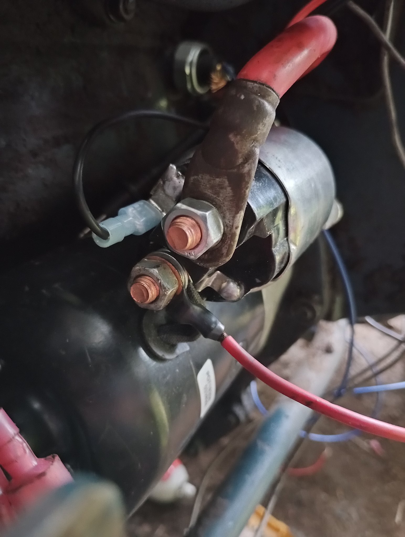

I am attaching a picture of how my starter is wired. From what I understand you saying is maybe it's wrong? It's what the other was wired as, and would heat glow plugs and turn over. Thanks for responding
7,067
2,500
I say it is not correct in that arrangement and should be on the same terminal as the battery cable.

Yes you have the ignition feed wire on the wrong terminal.
It goes on the top terminal, same terminal as the battery cable.

Agree with last two comments. . . Starter small red wire needs to be on same post as wire from battery (large red wire).
I created a simplified schematic for my BX (https://www.orangetractortalks.com/...rt-and-engine-stop-systems.63554/#post-638769) - the details will differ but you can hopefully get an understanding of how the start/crank system works and they all tend to be similar.
With the starter correctly wired and that small red wire providing battery voltage to the rest of the systems, then you can resume looking at your heaters problem.

Thanks everyone. That was it. I guess I didn't pay enough attention to how the old starter was wired ...
