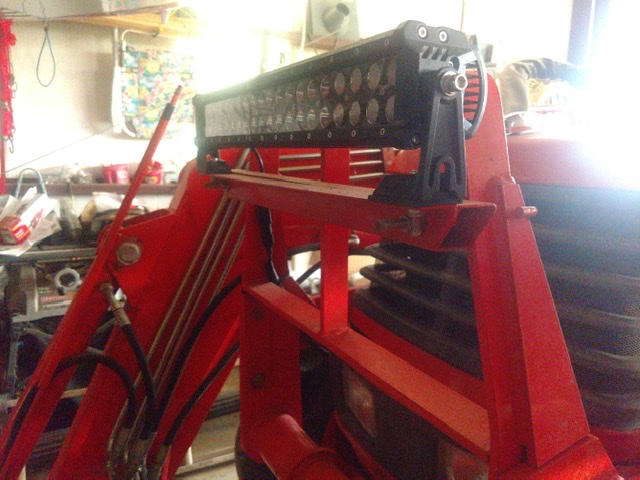

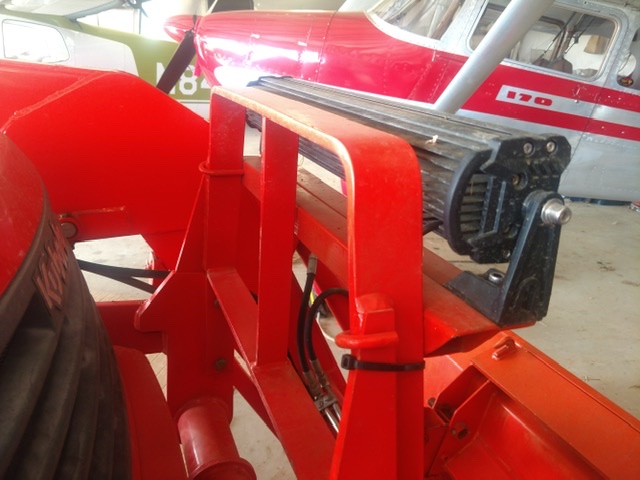

Although we have different M models I believe we have the same 55 watt incandescent headlamps. Flip mentions the same problem I found... the loader blocks the headlights and the flash-back from the bucket or forks is really bad.
I added a LED light-bar to the top of my grill and it totally solved the problem! Wow!... the amount of light and the range/distance is wonderful! (Tractor Supply brand is what I used and put a rocker-switch on the panel.)
6,288
3,629
( Used J-bolts to mount them on angle welded to a piece of 1-inch square tubing.)
