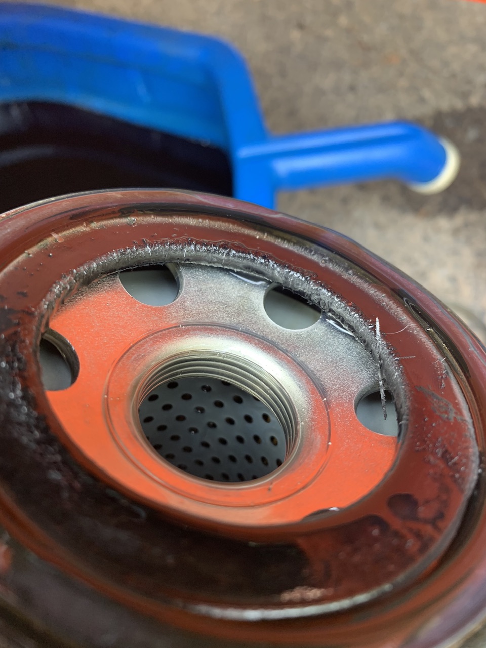

Dang these manuals could use some rewriting. I thought I was changing the fluid for the HST transmission and filter like the manual says, but now wondering if I'm changing the hydraulic fluid! Yeah, it's really the same fluid right? But the manual never says that. It lists two different filters for each and different interval change outs. But if they are the same fluid, why are they not changed at the same time, and why do they even have two separate filters? Crazy and confusing, as the manual uses "hydraulic" and "Transmission" interchangeably, yet calls out filter to be one hydraulic and one transmission. Confusing.
Also, manual recommends draining rear only when changing out "transmission" filter, but removing all oil when changing out "hydraulic" filter. AND it has a heading to Change Transmission Fluid and Hydraulic Filter.... not both filters. Nuts. And don't see a reason to ever drain rear fluid when changing out transmission filter every 50 hrs.
So.... if my fluid is black, I should be changing both filters and draining front and back transmissions right? Also, what bolt size is the strainer? Nothing in manual and not one I keep. Is it 26 or 27 ml?? my 1 1/16 is just too big for it so guessing.

So I was wondering about the performance of the filter and more particularly what has caused the hyd oil to go dark. I do not do a lot of heavy work, mostly mowing pastures and some dirt/gravel/mulch spreading. I'm wondering now if age had anything to do with it. There is no time interval recommended in the manual.
Oil was changed at 100 hrs when I bought it, because it'd been sitting for a few years and didn't know if first owner did the trans filter change. At that time the oil was clear, so the dealer said. Filter was changed then, and presumably also at 50 hrs by first owner, as he was so particular he even touched up the paint scuffs on the bucket. Manual says change oil only at 400 hrs with 200 hrs after second filter change. So thus why I had planned to change oil and filter at 300 hrs. So essentially I'm doing 400 hr service now at 300 hrs, 10 years of service.

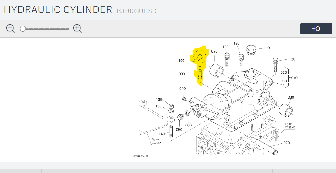

It's not a closed system, there are vents in the system, they are under the seat on most models.

A magnet? I pulled the screen and there was no metal on it. Rubbed it with a magnet to verify. No gunk either. I guess I'm ok.
Turns out that UDT2 is not really clear. If you pour it in a white bucket, you'll see it is actually quite opaque. Not black, but definitely not clear either. I'm guessing the dark fluid is caused mostly by age breakdown. After buttoning everything back up and new filters and inspecting screen, it seems to be running fine and not noisy. Interestingly it was a bit whiny after start up. I'm guessing it takes a while for the oil to get circulating properly? Overall not a bad situation as of today. We'll see how it looks in 50 hrs after mowing the next couple months. I think I'll be changing fluid no more than 100 hrs and/or annually now though. Cheap and easy thing to prevent costly issues.

Here is the vent:
