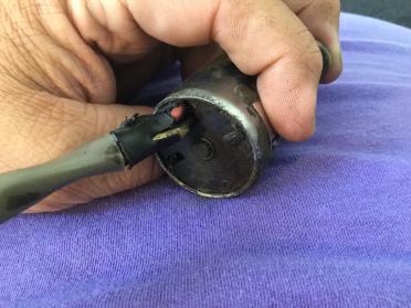

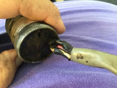

Ive been experiencing this same recently on my B2400, no "brain" per se but looking at WSM it s the 5a fuse that powers the injection pump run solenoid.
I found the back cover of the solenoid pushed out, maneuvered the wires around. Replaced the 5a fuse and it runs....for awhile then blows again.
First time after it happened i was waiting on payday to order new solenoid, but ended up in the hospital that week (gallbladder 2.5 weeks ago)
Forgot all about it til last weekend when i went to mow again and had to replace the fuse to get it to stay running. mowed for about 45min and it blew again. then started raining (again) before i could get out to get another fuse in it.
And again gotta wait for upcoming payday to order the solenoid.....
its rained EVERY.DAY. since last weekend, supposed to rain again tonight.
i did notice the solenoid is abnormally hot after about 15min of run time today, when it blew the fuse again.....
circuit in WSM shows power from starter while cranking the run thru key, in my case the run circuit is 5a that keeps blowing. it'll start and run for a few seconds when attempting to start, then die.
Machines are aggravating !!!

so my own junk is up and running now, received the new solenoid from Messicks yesterday
popped the old one out, the wires where they come together into the case seem to be some what melted. the rear cover had been pushed off somehow.
installed the new solenoid, replaced 5a fuse and started her up. then proceeded to mow 10” high grass on average for the next hour or so. no issues, ran well
i’m not familiar with the B3000 and it’s innner workings, but over time have learned that things are not always what they seem.
hope this helps
