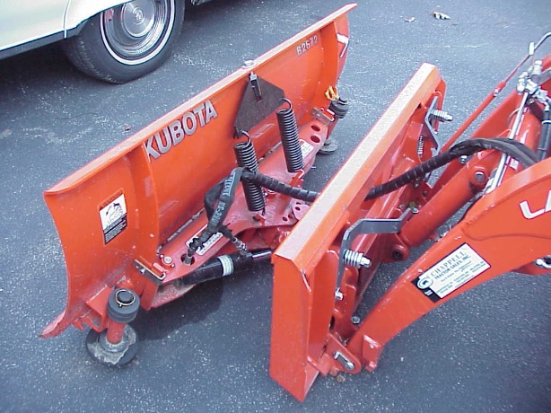

I have found a really good deal locally on a used B2672 - a 5ft wide angling snow blade for the front of my B2620. It, however, does not have hydraulics on it. I plan to remedy that. Kubota makes this same blade as an OEM option with factory hydraulics that looks like the below.
Kubota also makes a conversion kit (B2671, I believe) that converts a non-hydraulic B2672 to one with hydraulics. But online, it is listed at places like Messicks or Colemans for north of $700.
I can do it myself for cheaper, I am sure. I mean, what are we talking about... A cylinder and a few hoses with fittings?
What I can't find so far is info on the size hydraulic cylinder that is the best fit in there. Is there anybody here at the forum that has a B2672 with hydraulics that can shoot some good pix of the hydraulic cylinder on their plow for me. I'd really like to see any plate or sticker on the hydraulic arm that lets me know sizing. Many thanks in advance

You dont need to match OEM perfectly.. You can measure retracted and extended length by angling your blade. The rest should be obvious.

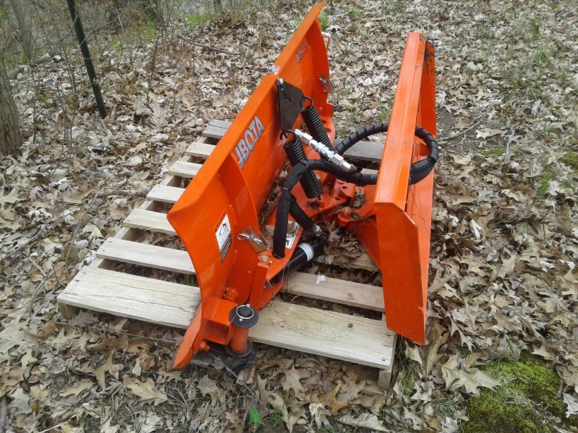

A few other bits of uniqueness to the Kubota cylinder that makes off thr shelf match more challenging
1. Pin holes on each end are different sized - one take a ⅞ pin and the other a ¾ pin. This variation is apparently not common
2. Also the ports to connect the hydraulic fittings and lines to exit the cylinder parallel to the end pin holes on the oem version and so far... mostly perpendicular on the aftermarket cylinders.
So this will be a good challenge. I need to get it out to the farm and do a bunch of measuring and brainstorming. This will be a fun rabbit hole to explore. But Dan may be right... might just be better to pay an extra few hundred bucks and just get the oem kit.
I looked at the porting when you first posted this picture. I could fix both "problems" with a 7/8" twist drill and two rerouted hoses. Like I said - you dont have to match OEM exactly. But for the minimal cost savings I would still buy the Kubota kit 🤔

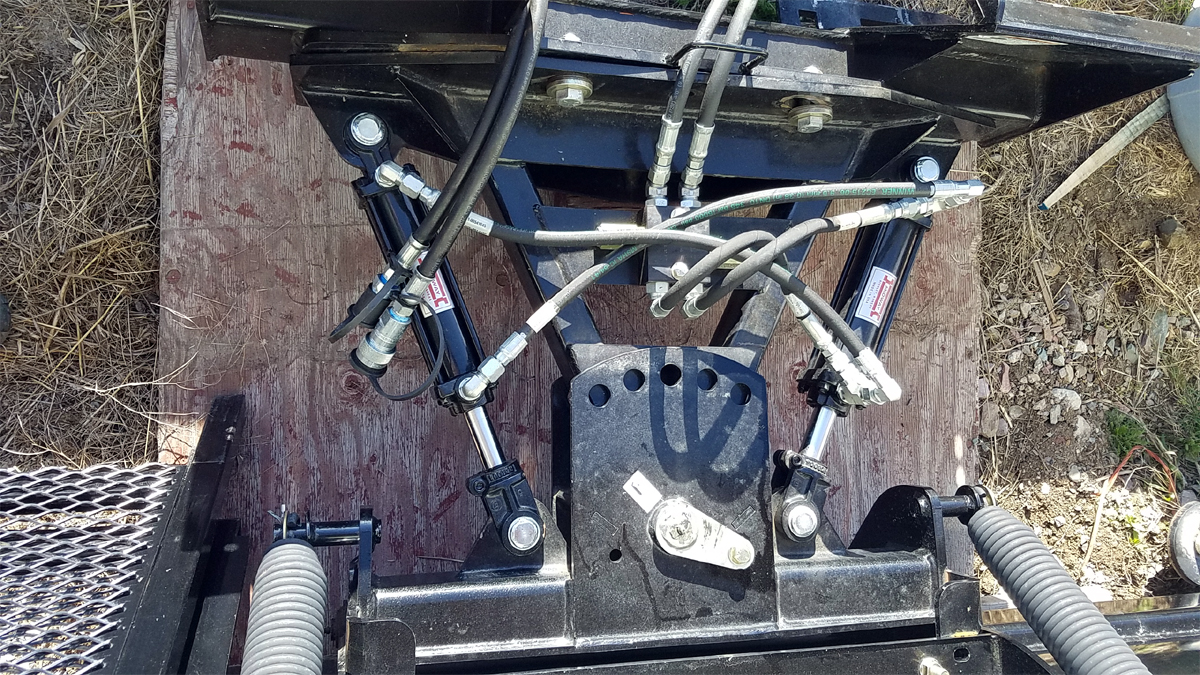

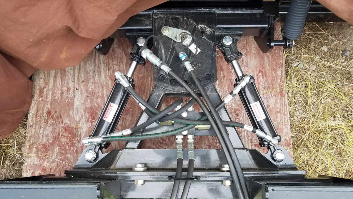

Here's the factory set up on my Land Pride SB1596. I'd buy this implement again, no doubt about it.
Betcha a dollar to donuts that those clevis-end cylinders used by LP are a common item that is easily sourced from a multitude of vendors. Not so much the one off cylinder (# 77700-08484) Kubota is using for a bunch of front implements!

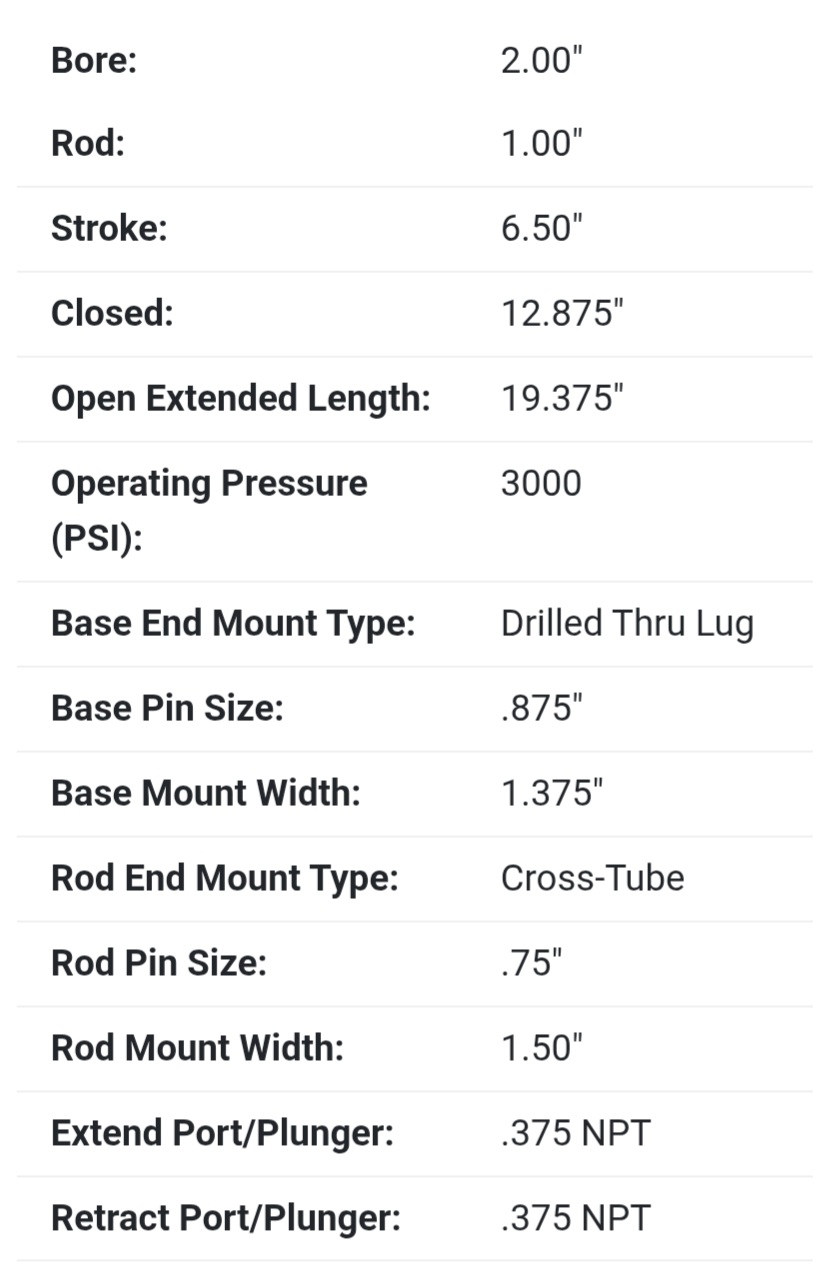

Just for archival purposes in case someone else comes along in the future looking for info on this commonly used Kubota cylinder... the attached is the B2671 kit diagram and here are the specs.
One of my local dealers responded and sent it to me. They want the same $713 that Messicks wants and this appears - from the post above - to be the Whole Goods cost
7,329
10,110
You're probably right. No doubt you and @TheOldHokie will get it figured out, and all I can say is that the view is worth the climb. I've been using my STB1596 for five winters now, and a snow blade without hydraulics is like a cup of tea without milk. 😂
