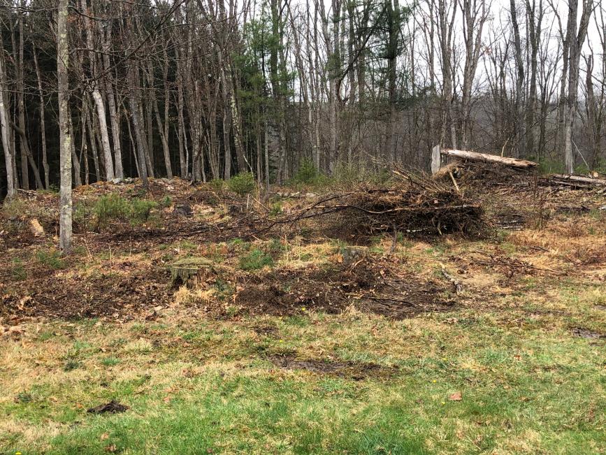

I don't have pallet forks but I find my grapple to be pretty useful. I worked with it for a few hours yesterday rooting up some thorny little trees that were about 8' tall along the edge of the yard and had also a couple dozen that had started in the area that was logged last year. There were also barberry shrubs and small pines I wanted out because I want that area to grow back in deciduous trees.
While I had it on I went to the other end of the property where I had cut down a dead, 80' pine last month. It was in about 10' sections with all the limbs in three heaps. Moved the whole mess out of the field in about 15 minutes.
