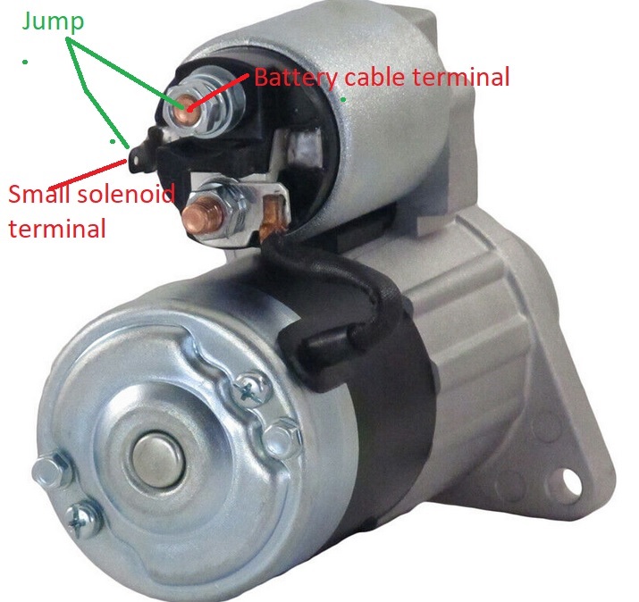

You can jump the starter to rule out the basic problems.
This procedure needs to be done with great care and no short cuts.
Someone knowledgeable needs to be on the seat. Not one of your young kids.
Every safety feature designed into the tractor is being bypassed. You could be run over or end up with a tractor moving with no driver.
The machine needs to be in neutral and the foot brakes applied.
To jump the starter look at the picture below:
Anything metallic can be used. Generally a piece of insulated wire is best.
When you connect the small and large terminals the starter should crank instantly. There may be a small harmless spark as the jump connection is made.
If the starter does not crank instantly, then it is the basics but on a tractor with 245 hours there cannot be much other than the condition of the battery.
