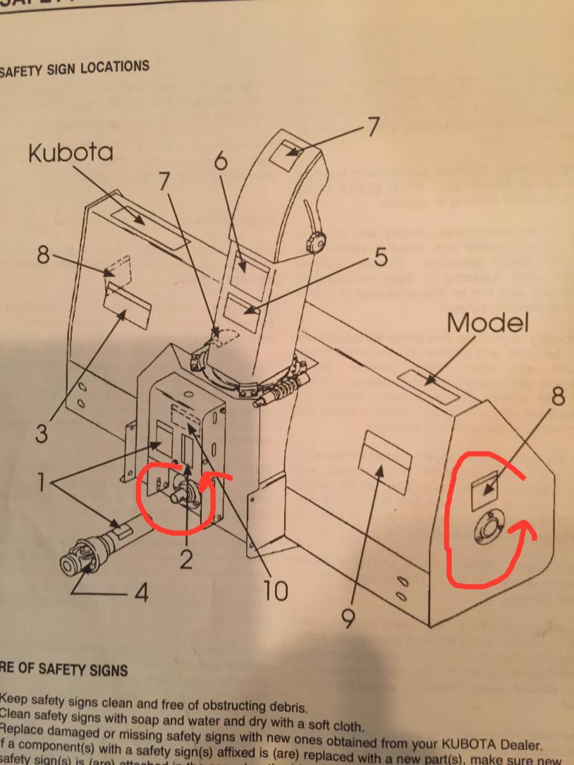

i recently purchased a second B1700 HSD that came with a B2650 Blower. My other B1700 HSD has a B2550B Blower. When i purchased the B2650 the first stage augers were turning clockwise pushing snow out of the housing. B2550B turn counter clockwise and works just fine. The second stage auger on the B2650 turns the proper direction counter clockwise. I'm wondering if it was possible to install the wrong worm gear. To buy a replacement non returnable worm gear is over $330.00. Any help is appreciated.

Direction is the question that i need to figure out. Which is the correct direction for the rotation of the first stage shaft? This one is currently turning clockwise. I believe it should be counter clockwise. For the blower to function properly to pull snow in from bottom then into middle. The only you tube video i could find of a B2650 blower in action seems to show it turning counter clockwise. Can someone please confirm the rotation of this first stage shaft?

The second stage auger turns the the correct way as you have described counter clockwise. It's the first stage shaft that i'm having the problem with since it is turning clockwise when looking at the left side sitting in seat facing forward on tractor. I think it should turn counter clockwise.

Is it possible the augers are installed on the wrong side thus making them appear to be rotating backwards
The parts info shows left and right side augers. Put them on the wrong side and that may be your problem
I have not spent the time going through the mental image in my head but that is my first thought. Worm gear is not the answer for certain.
