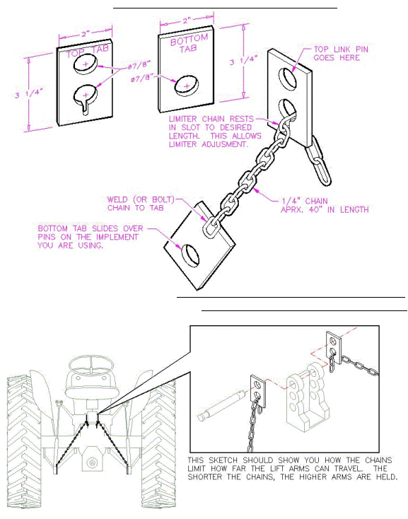

do you have any fabrication skills with metal? Or friends that are welders? IF so - you could work up something using old lawnmower front tires and wheels. It would not be hard to make - then again if no access to metal, it would be difficult.
Have you ever used a limit chain on the 3 point? I know your machine has position control on the 3 point lift - but making it rest in the same spot might be better achieved with limit chains. You simply place a link in the slot to achieve the desired height.
https://www.tractorpartsasap.com/mower-deck-stabilizer-kit-103201.html
Great Idea, thank you for sharing- I will look deeper into this option.
