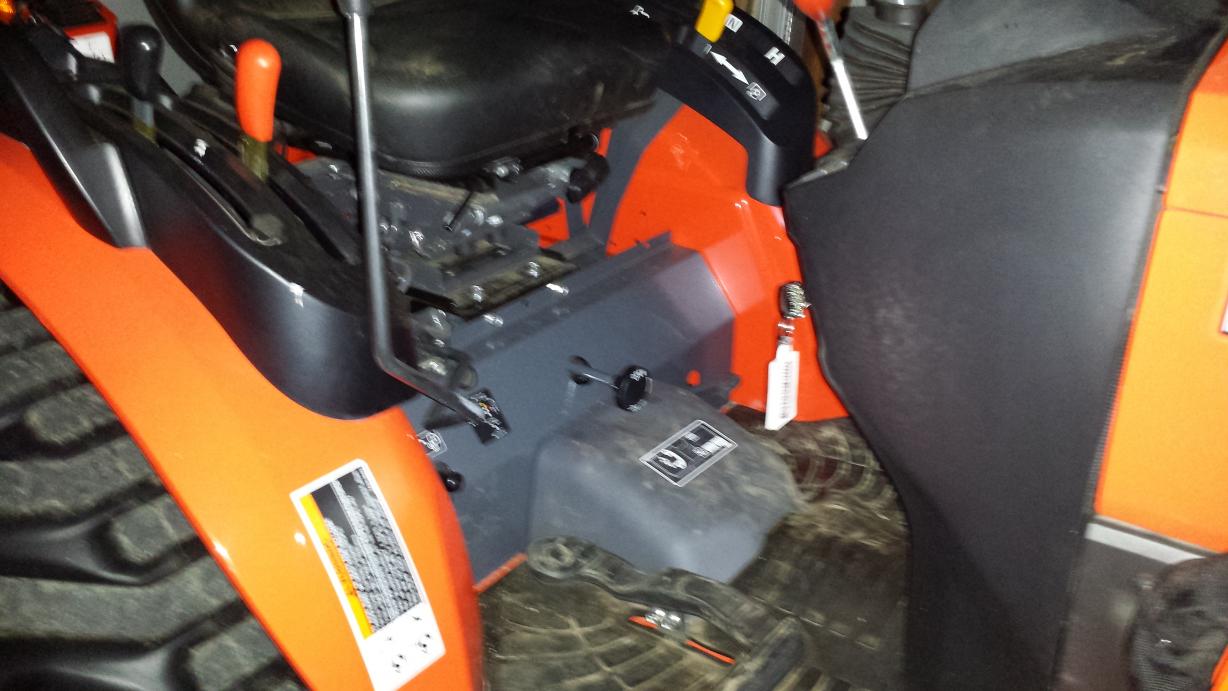

Hiding in the weeds for while but I am now a brand new owner of a B2650.
Have a little over 10 hours on the machine and so far so good. Looking to add a skidding/hitch attachment and notice that I have a knob that the manual indicates is a 3-point hitch lowering speed knob. The knob itself is labeled as CLOSED or OPEN. The manual states FAST, SLOW or LOCK. Anyone have an idea as to what=what? I know you all love pics, so enjoy, I do!
4,667
1,003
looking at the picture in the manual:
Turning anti-clockwise (counter clockwise) is fast (A)
turning clockwise is slow (B)
turning real far clockwise will lock it in position (will not lower at all) (C)
Doing the logic then is
A = CCW = fast = open
B= CW = slow = close
c = CW far = lock = close as far as you can
