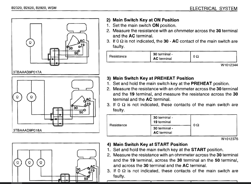

There is NO timer, there is NO fuse, there is NO relay.
It's a simple wire from main switch to Glow plugs.
Since your getting an Indicator of it getting power to the glow plugs then it's most likely you have a fault at a connector or wire between the switch and the glowplugs.
Could it be that the owner is not using the pre-heat position on the key switch?
My version of the WSM shows such a position but the owner never mentions it.

Thanks to NIW for posting the wiring diagram, ! I can SEE that the power wire from the 'T-splice' to the glow plugs is broken. NO timers, NO relays, NO 'computers' just good old SIMPLE wires.....
given in the original post....
1 ) battery, switch are good
2) dash glow lite, lights
3) no power (voltage) at the glow plugs
My conclusion is that the wire from the T-splice (black dot in wirig diagram ) to the 1st glow plug is bad.

The wiring diagram does not show that differentiation as exists on the glow indicator systems.
This owner would see the light in the key switch start position also.
That is how I interpret the wiring diagram NIW provided earlier

I’m wondering if the OP doesn’t realize that there are two positions of the ignition switch that are spring loaded?
Perhaps he thinks because he releases the key and it goes back to the run position that there’s not a preheat position that you need to hold before you fully turn the switch to engage the starter.
But he says the glow plug light comes on...hopefully he is measuring the voltage at the glow plugs when the light is on. Maybe he is just turning the key right through the preheat position…
#40Fan
Jul 21, 2022
373
251
Horrible screen grab from a video, but you can see the switch layout looks just like the one in post #15.
