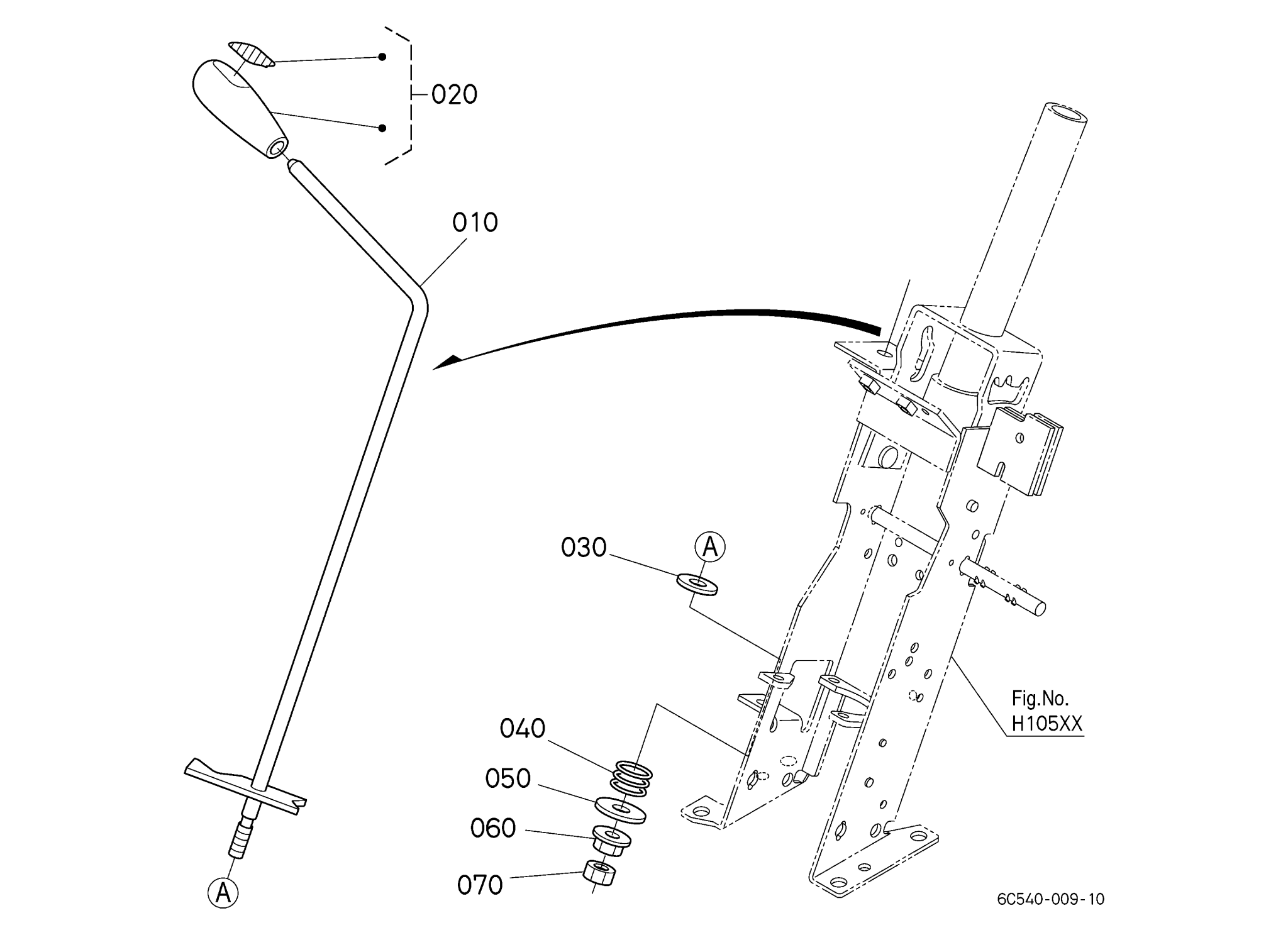

Sporto
B2601-1, FDR1660, RTA1258, BB1560, LR1672, PFL1242, MK Martin Snow Blower
Mar 20, 2021
46
39
Manitoba Canada
There is a You tube video done by "My Cluttered Garage" on that very subject with his B2601. As GreensvilleJays picture shows that was his problem.
