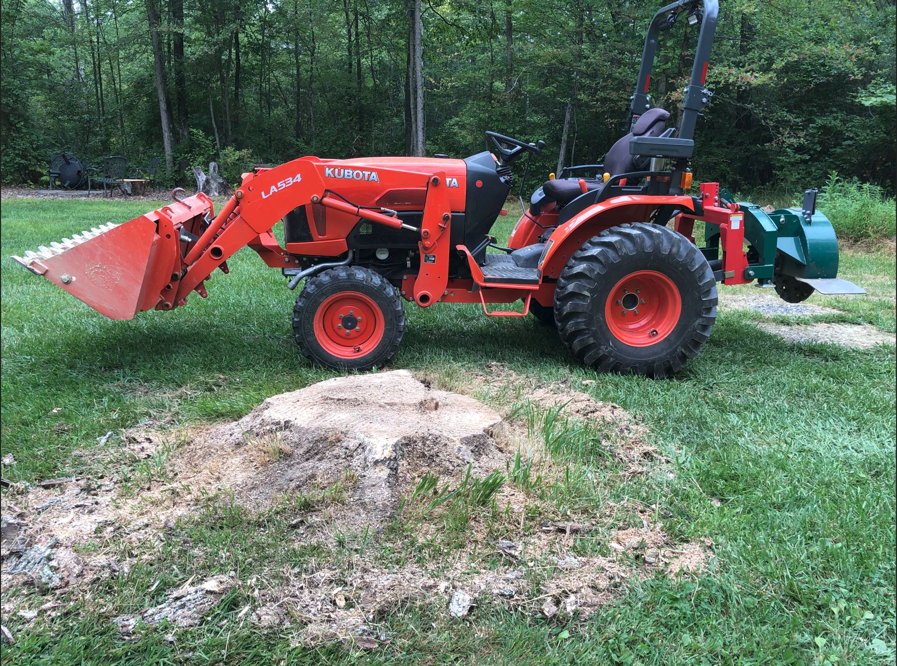

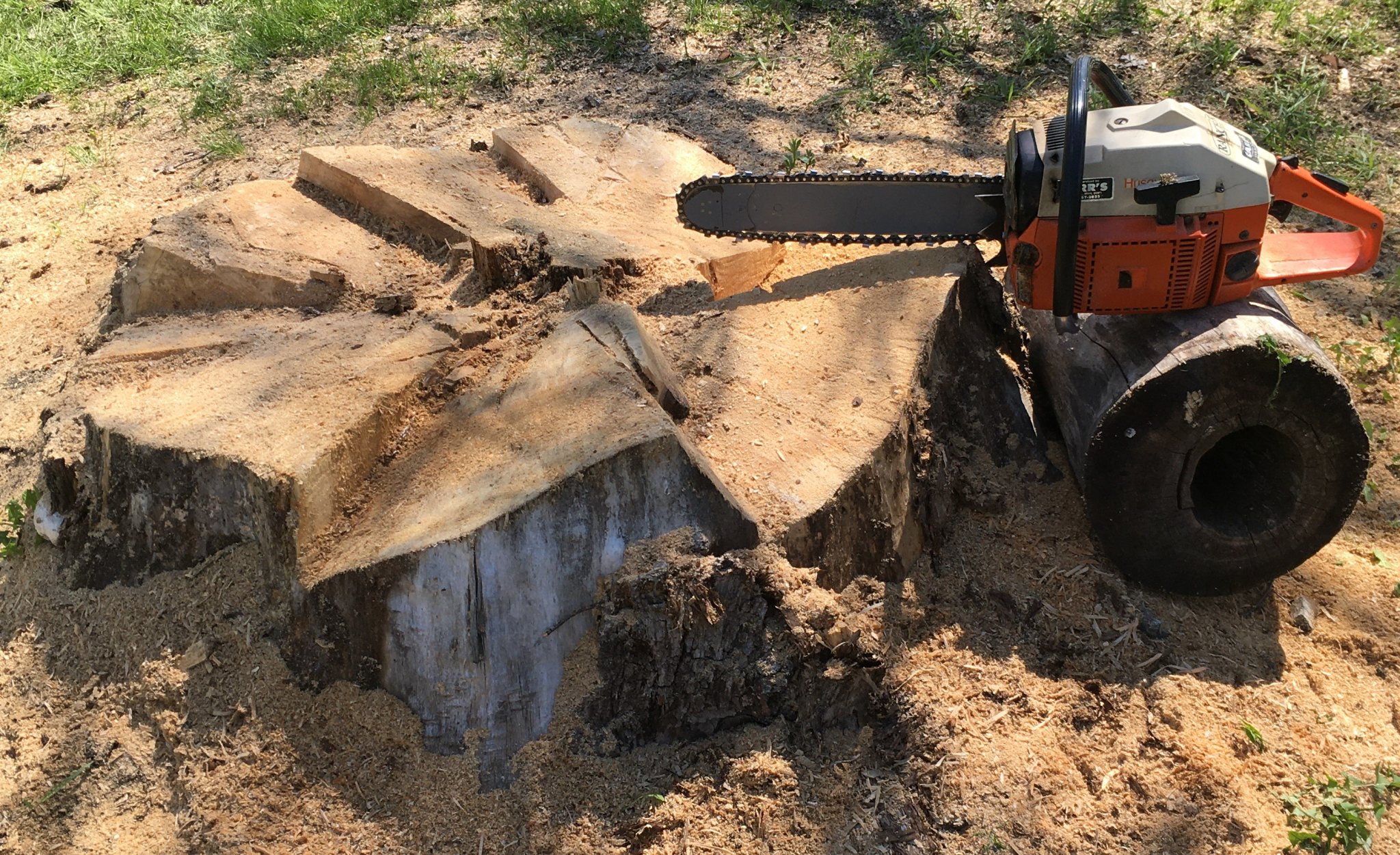

Stump grinder vs. stump bucket: Alot depends on both the size of the tree and the condition/type of ground that the trees are in. I have a lot of 100+ yr old cottonwood, ash, etc. on this farmstead. The old trees are now starting to die off.

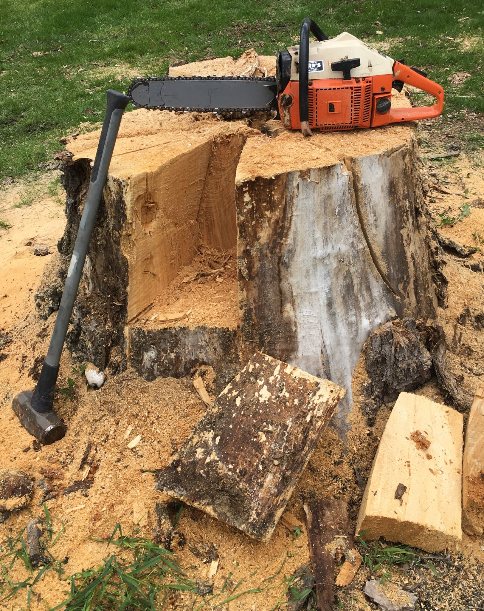

Here's a cottonwood that was failing, so I dropped it before it fell on the house. I need a bigger chain saw!!
View attachment 104926 To get it low enough for the Woodland Mills stump grinder it had to be cut up like a cake! :)

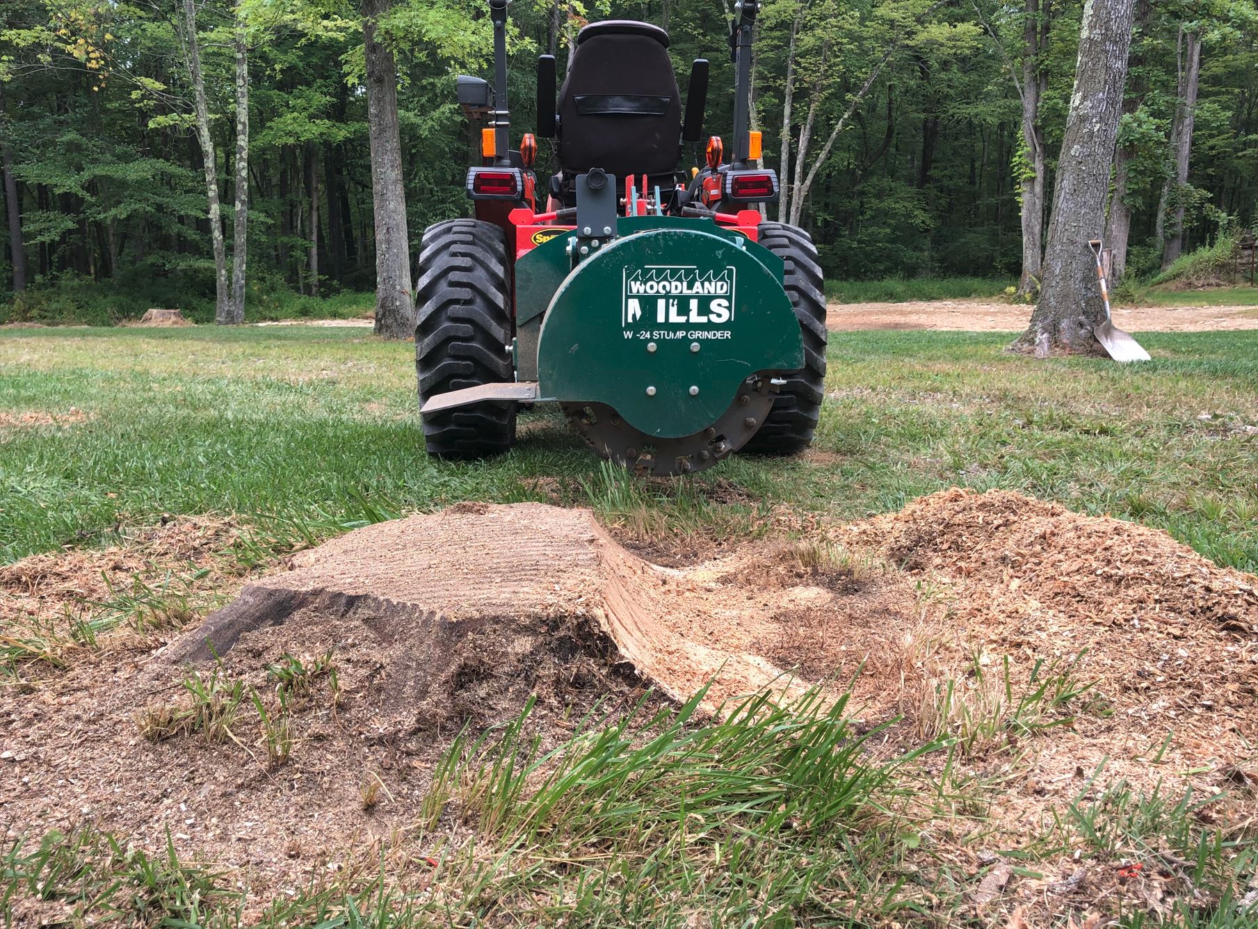

When cut low enough for the grinder it was a little over 5 ft across at the base.

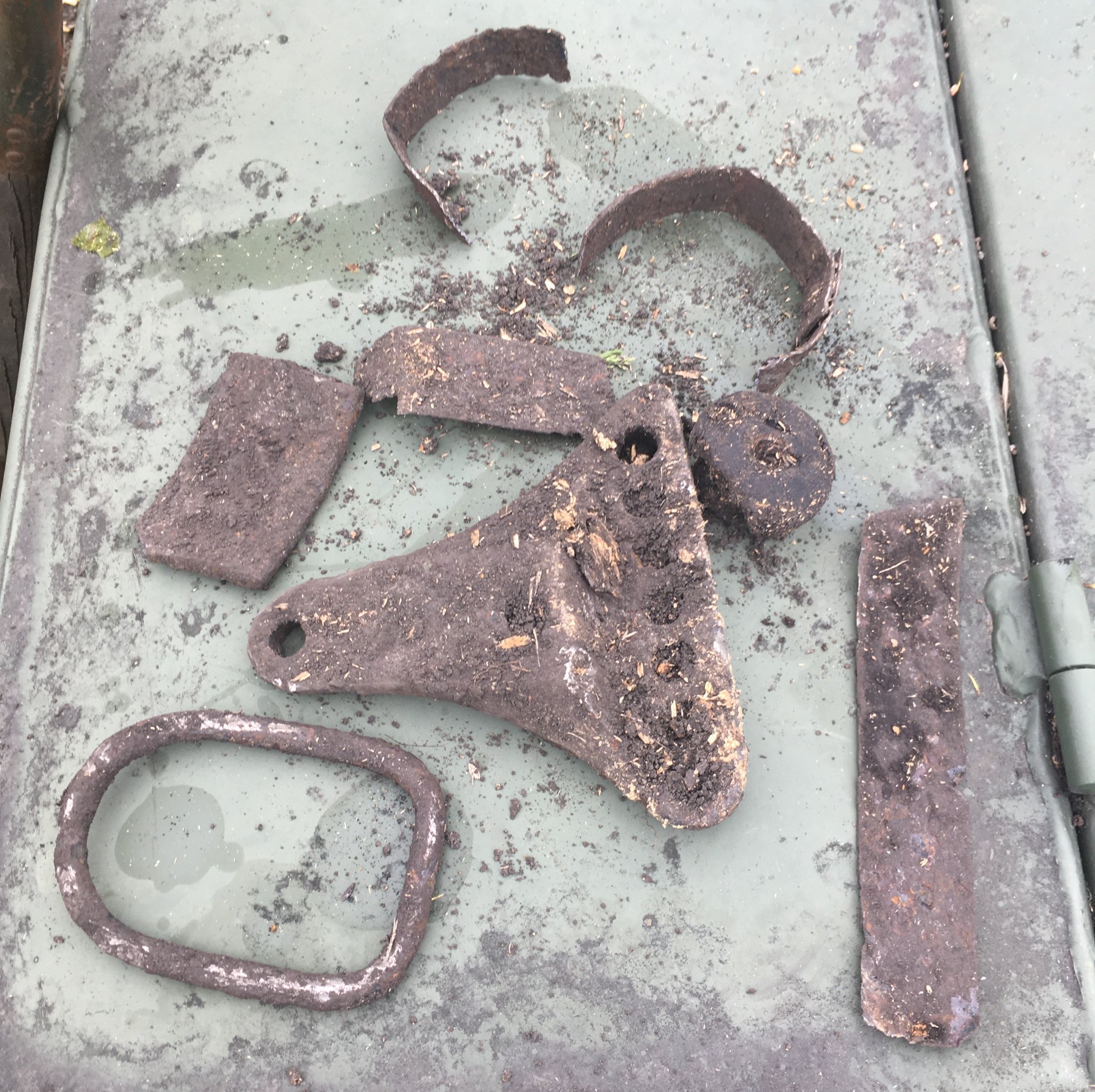

I was smart enough this time to check for buried metal with the metal detector before spooling up the stump grinder...... darn pioneers that left things laying around at the base of trees!! :ROFLMAO:

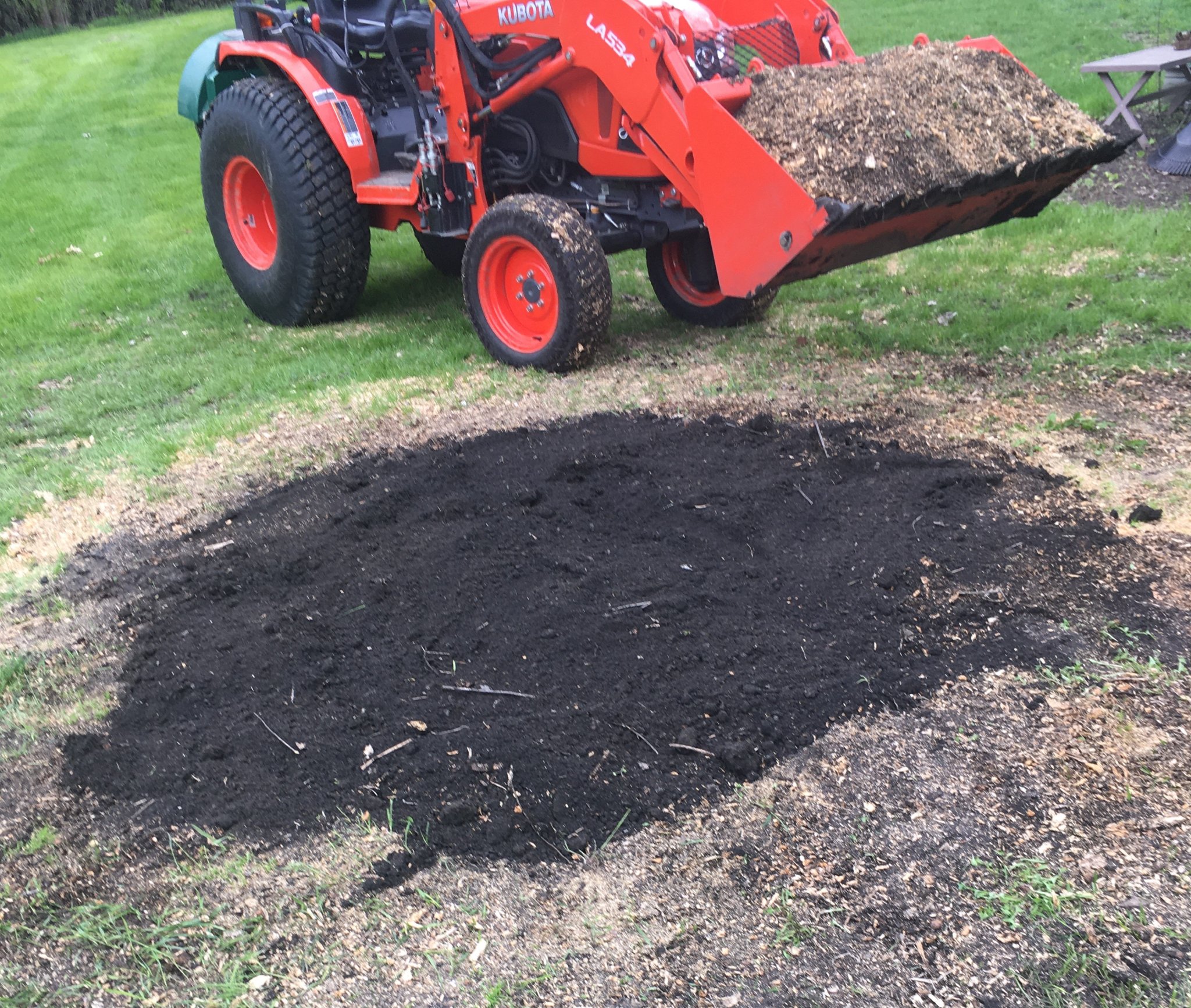

Shortly after the WG24 was spooled up behind the B2650 and black fill dirt spread in the hole....it was ready for some grass seed.
The Woodland Mills WG24 earns its keep around here!
I defiantly didn't see a tree of that size on my homestead it maybe a ft or 2 wide at best. So if this stomp grinder can handle a 2 foot wide tree then the b2601 moves up on the list

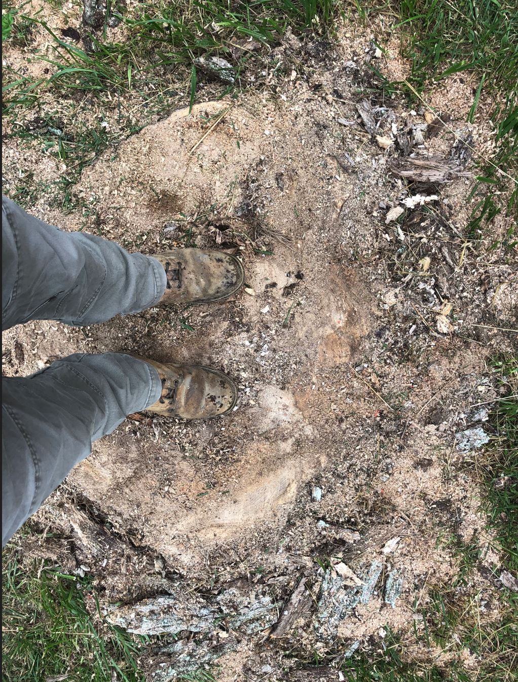

30" plus oak...
