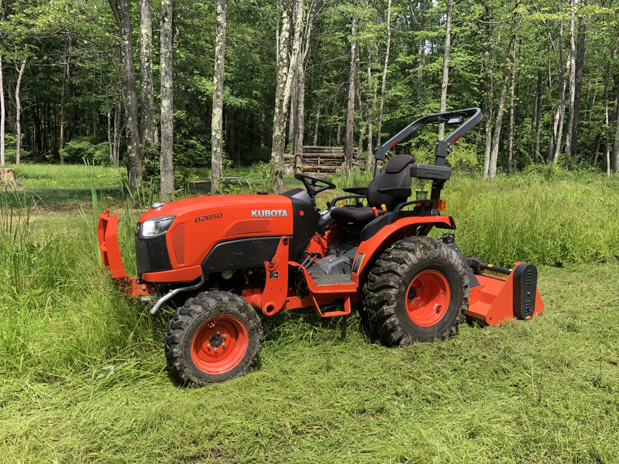

Either of the LX models will spin a 5 foot flail mower...I have a 54" flail, and can over-rev it at will.
