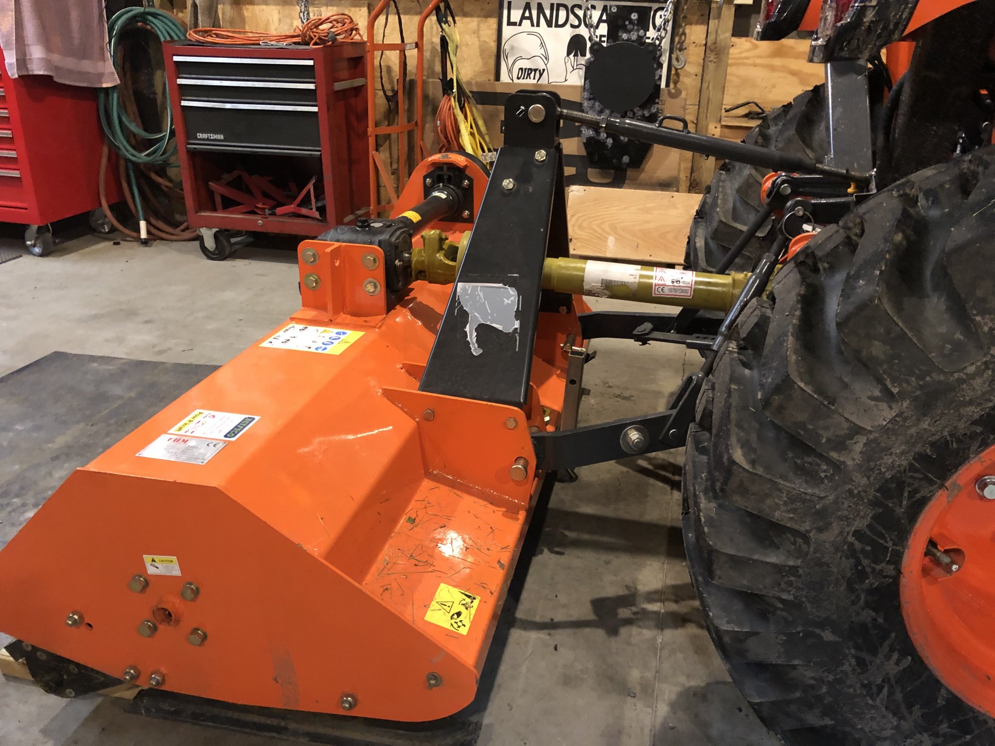

One other suggestion I would make is perhaps consider a flail mower instead of a brush hog. Depending on what you're mowing, you may find that a flail mower would be better suited to your needs. There are several varieties (blade types) available.

They are lighter, much more compact and generally produce a much better cut than a rotary mower. They also allow you to cut much closer to the ground (if wanted) and can be used for grass as well. You can also off-set some models, either mechanically, or hydraulically. You can typically run a bit larger unit as well compared to a rotary mower....again, depending on what you're cutting. It seems like they are only starting to gain notoriety within tractor forums.
The negatives are that they can be more difficult to use if you are mowing in reverse (like to get under trees) and you wouldn't be able to cut really heavy stuff (like over 2 inch in diameter). There are different blade types available (Y shaped for turf, and hammers for turf and heavy stuff).

I agree on looking at the flail. An offset flail can be great for fence lines and road sides. You can get them with hydraulic angle too, if you have ponds or angled road sides that need maintenance.

The flail mower is interesting to me, but I don't think I have the right situation for it. My MMM will do most of what I need. What the flail or rotary mower would be for is the extreme tough situations. Clearing a new path through woods, tackling and overgrown part of pasture with saplings, etc.

...The flail mower is interesting to me, but I don't think I have the right situation for it. My MMM will do most of what I need. What the flail or rotary mower would be for is the extreme tough situations. Clearing a new path through woods, tackling and overgrown part of pasture with saplings, etc....
For mowing I would start with the 60" mmm. Unlike lawn tractor a B can cut pretty high and through high grass and weeds. My first Kubota (small B) was all I had and I used it to mow my yard, as well the meadow three times a year which it did without any problem. And it looked a lot nicer cut with a mower than it would have with rotary cutter.

If you're cutting new trails and new paddocks with the rotary mower, I'd agree I wouldn't do that with my MMM. Once they're cut, you can maintain with the MMM, but if you're knocking down small trees then a brush hog is the right tool for the job. They may also be something you can borrow or rent if you're not using it often - but if you're working it hard you don't want to borrow one then break it.
