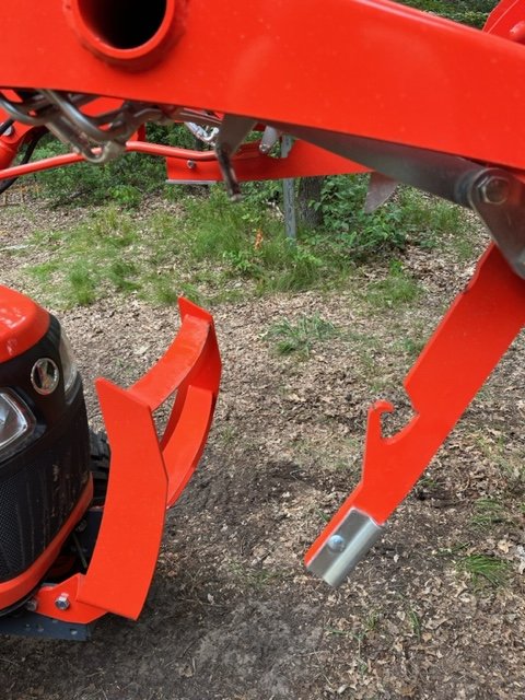

Ok I have broke a bolt holding up the loader stand 2 years in a row in the exact same spot. Last year Kubota replaced it under warranty this year I had to pay for it. Has anyone else had this problem or am I a lone wolf. What could I be doing wrong I feel like the loaderfor looks only not work. IMG_1135.jpeg

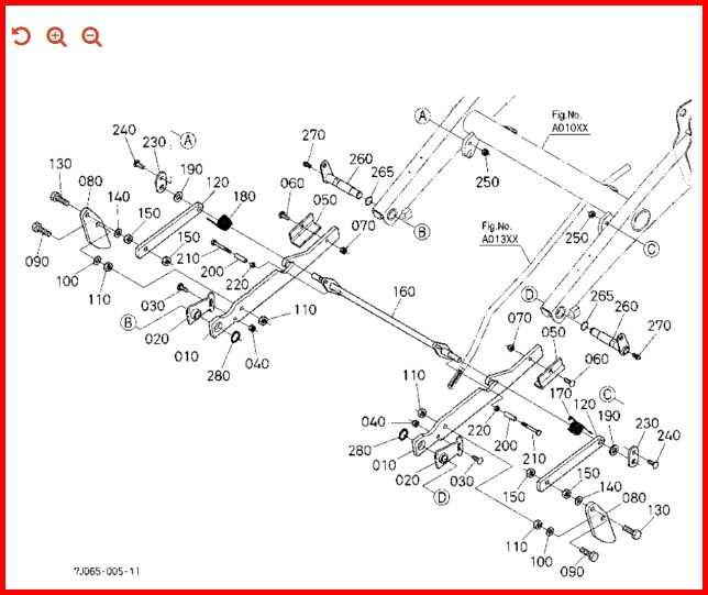

Right after I got my B2601 in 2020 I was using the Land Pride grapple I bought with the tractor/LA435 to clear some brush and I noticed that one of the parking stands was hanging down swinging in the wind. I found that the bolt/roller that holds the parking stand up when not in use was bent (almost broken). I tied the parking stand up and finished the job I was doing. I called my dealer and they came and got the tractor. A few days later they brought it back all fixed (or so I thought). After using the front loader for a while I noticed that the two bolts/rollers were bent again. Just the weight of the parking stands being bounced around was enough to bend the bolts. I decided to replace the factory bolts with some high strength bolts. I used M8x1.25 x 70mm grade 10.9 bolts to replace the factory bolts. I also went step-by-step though the adjustment procedure for the parking stands. No problems since. However, please be careful to not get the two silver "claws" (#080 on the LA435 Exploded Parts View) that are on the bottom of the loader arms hung on anything such as a limb, etc. as this can pull down on the parking stands putting stress on the bolts/rollers. I would have thought Kubota would have resolved this issue by now.
Edit...one other thing I forgot to mention is that there is a interference issue with the parking stand and loader frame, at least on the LH side of my tractor. The head of bolt #130 in the exploded parts view can hit the loader frame causing downward pressure to be put on the parking stand thus bending/breaking the bolt/roller that holds it in the up/stored position. Kubota must have not done a thorough tolerance stack on the parking stand mechanism. I resolved the issue by grinding an angle on the bolt head so that it cannot catch on the loader frame. I did this to the bolt heads on both sides even though I did not have a problem on the RH side. The bolt head/s can still contact the loader frame but the angle allows it to slip by the frame and not get caught.
