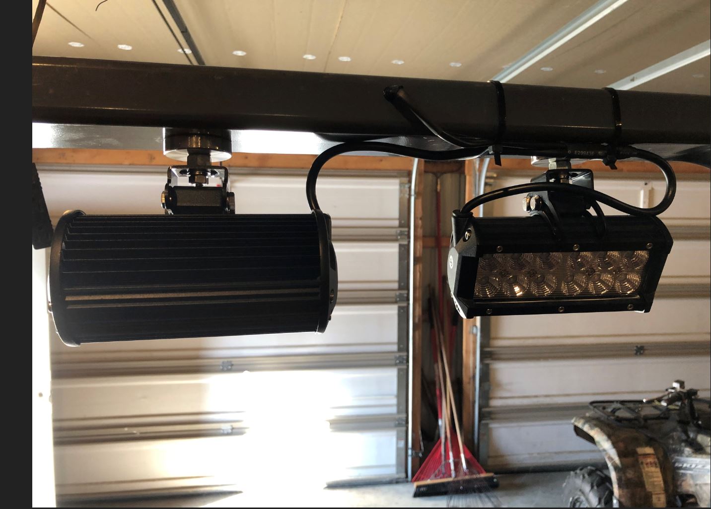

as ctfjr mentions, that's what I did. direct to battery with relay, fuse and switch. I wanted to be able to control the ROPS lights independent of factory lights and with or without the key on.
Here's a simple set up that I used... and the lights I got. I mounted the lights on magnets.

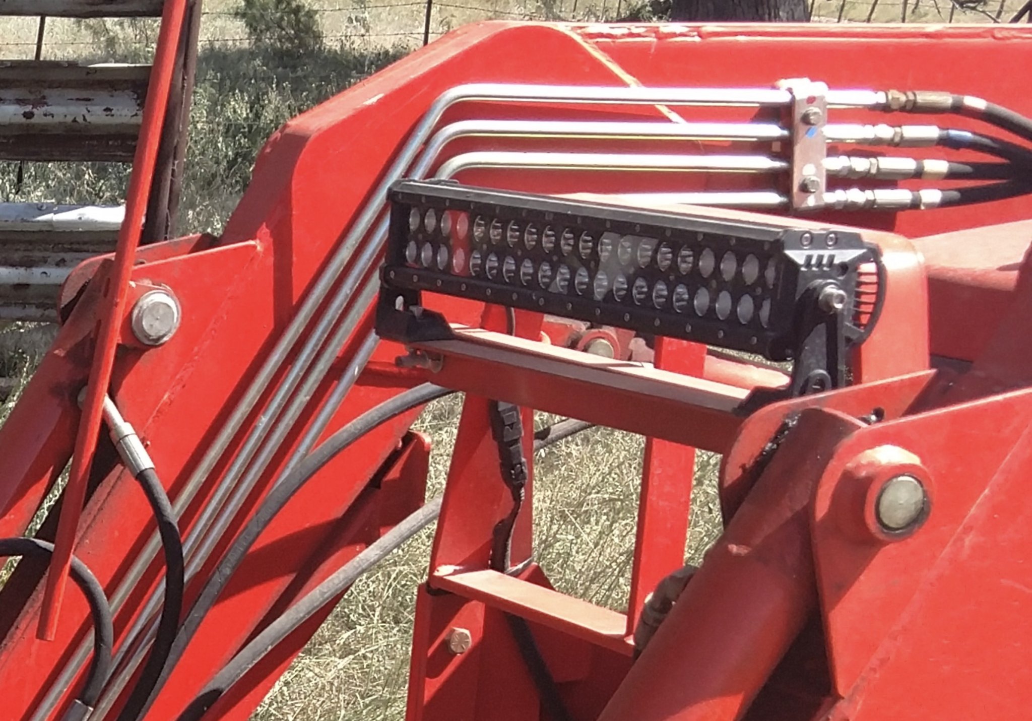

Is your light bar mounted to piece of wood and then mounted to your grill? Or is that just the light in the photo?
