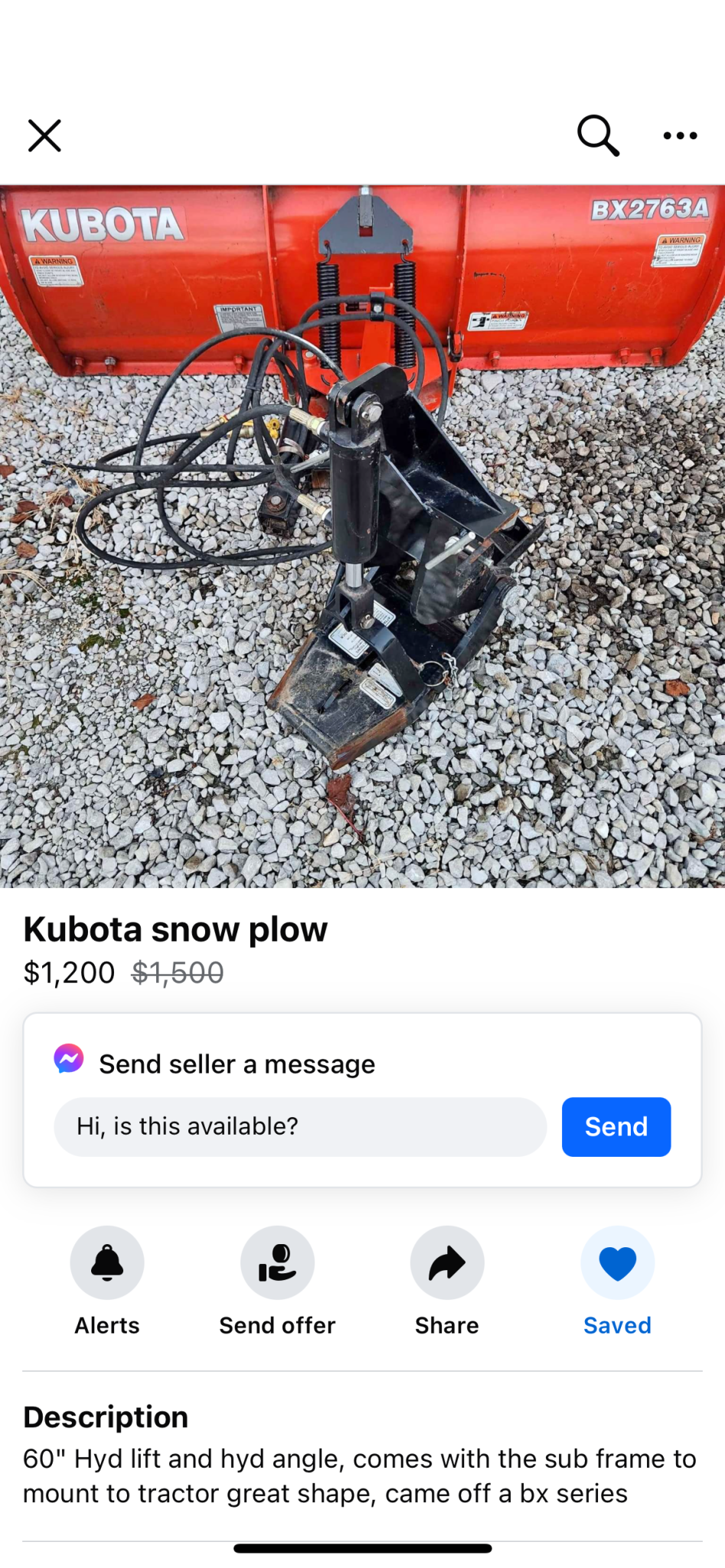

I have a B2601 with quick attach FEL and I would like to purchase a front blade with hydraulic up, down and angle left right adjustment. I found the used unit below which includes the sub frame kit. I’m curious if it will fit my B2601?

That's not a FEL snow blade, it's a Quick Hitch blade.

I think the set up you are looking for has a mounting system that extends up and under the frame of your tractor maybe 2 feet. Google is god. You will figure it out. Good luck.

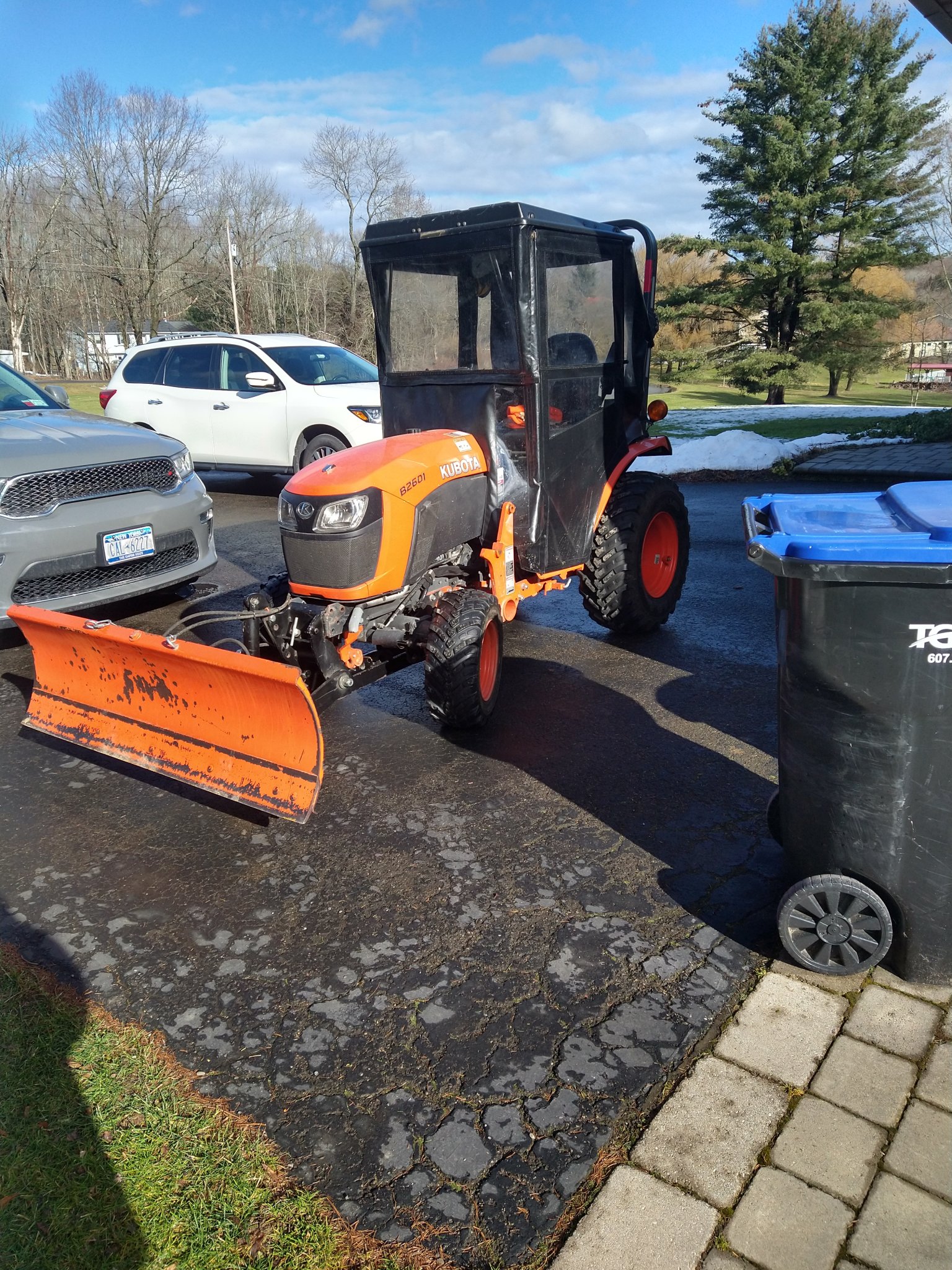

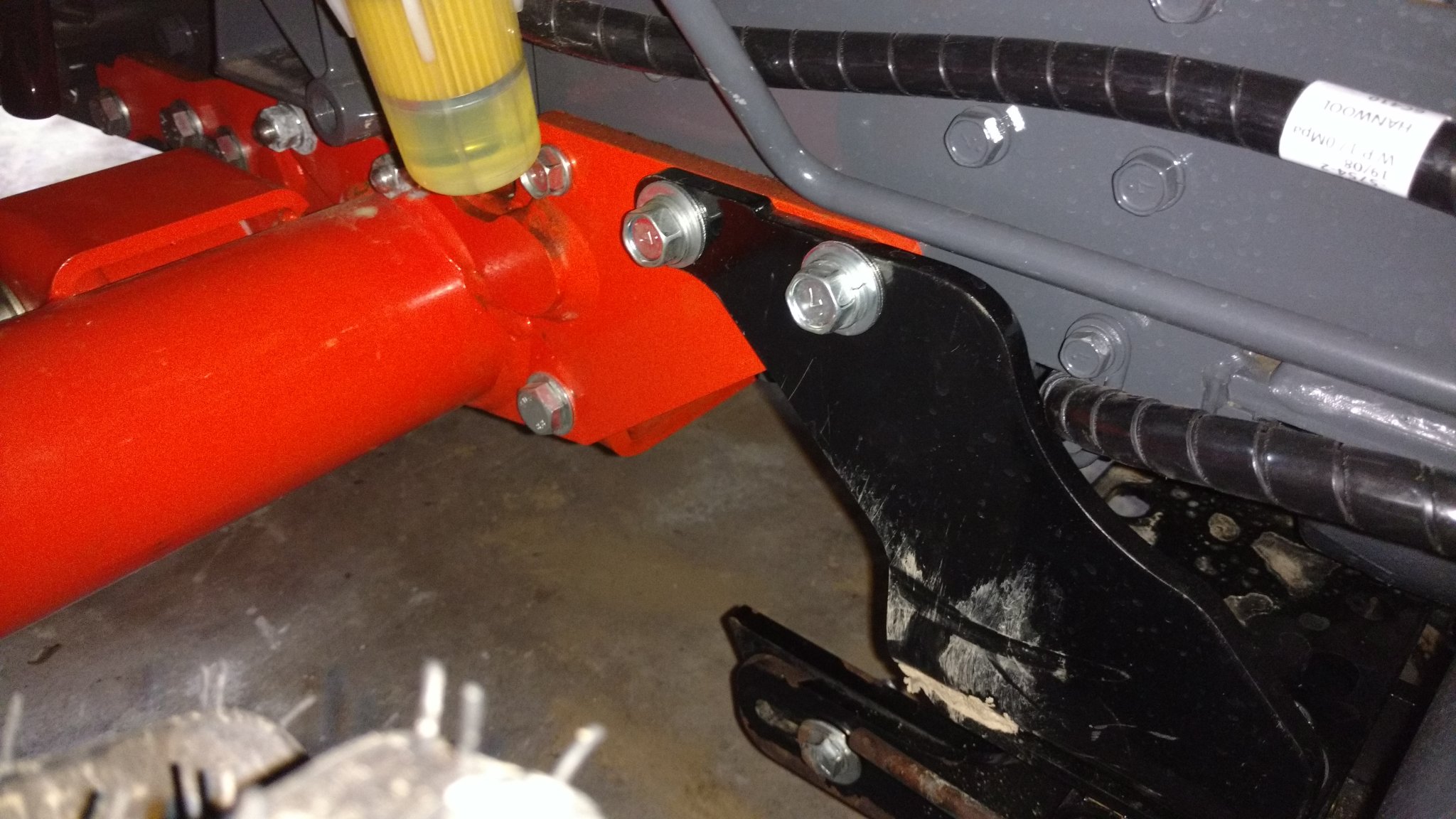

I had a plow on my B2620 that I moved to my B2601. The mount I have is a B2714 and I was able to make it work by ordering a couple of brackets that went to the mount B2791 that was for the B2650. The mount you show is for the BX series. Don't know if it will work. As you can see in pictures my mount hangs on the front like the BX but also attaches to the frame of the tractor.
