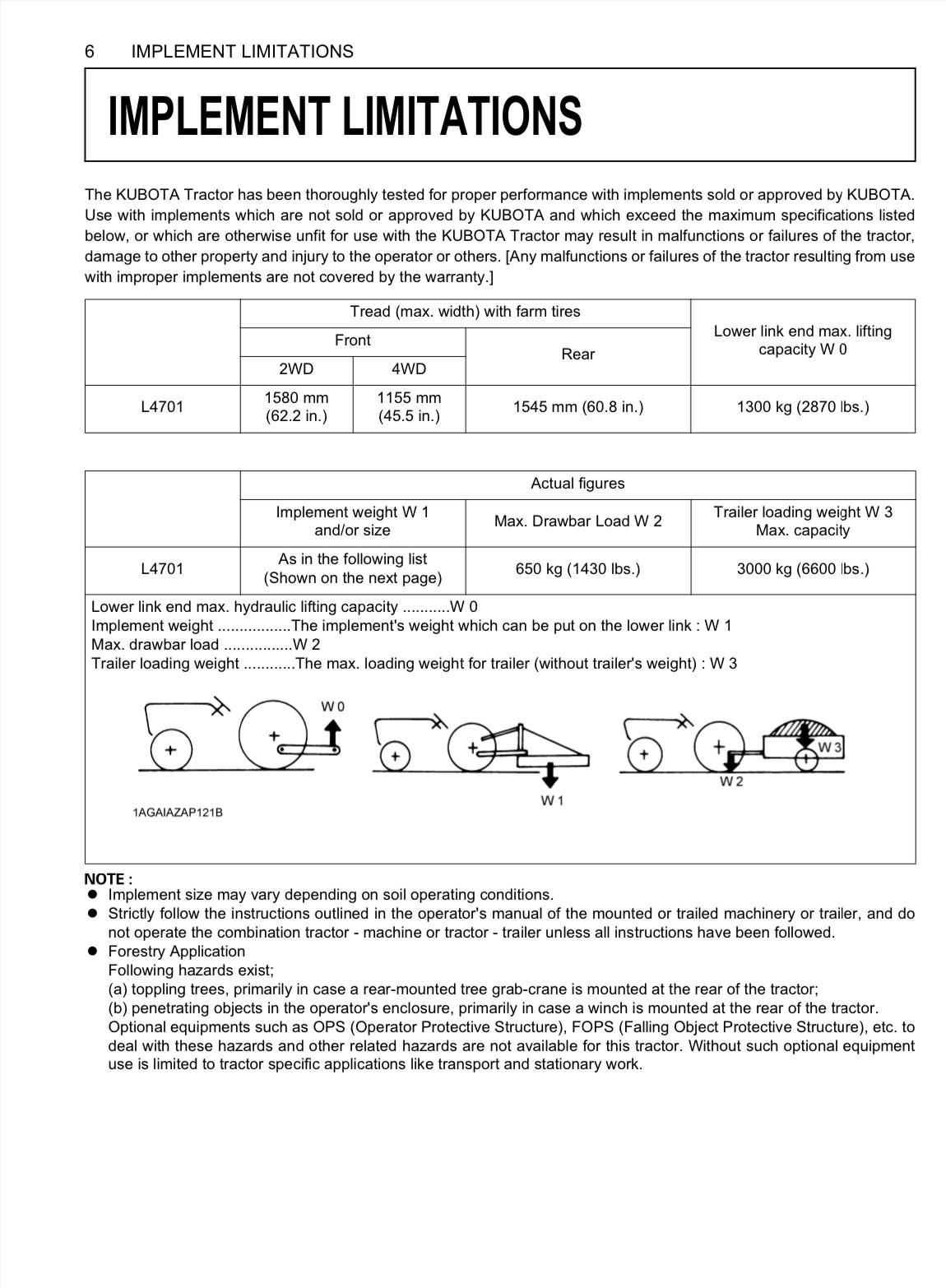

The above is from the Operator Manual for my L4701. Lift capacity is rated at 2870lb at the ball on the lift arms that attaches to the implement (W 0 in the diagram).

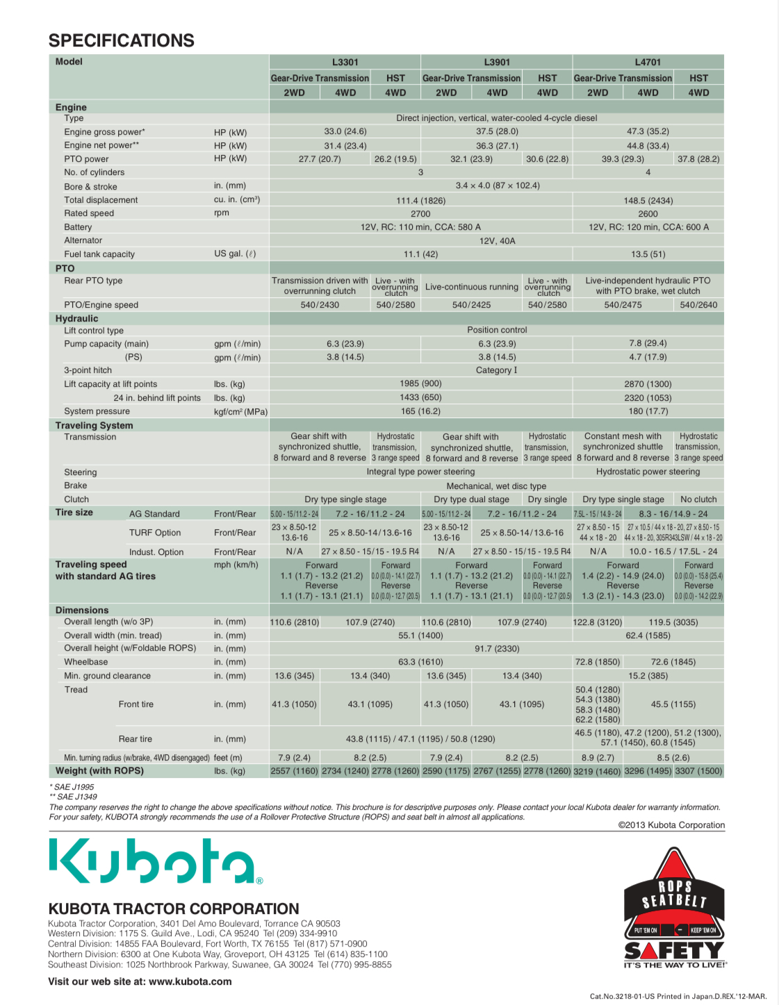

This is from the Kubota website. It lists the 3 point lift capacity of the L4701 at 2870lb “at lift points” and 2320lb 24” behind lift points. The capacities of an L4701 aren’t directly relevant to your question, but a comparison of terminology and associated ratings in the two Kubota publications appears to be instructive in defining “the lift point”.
My interpretation of the above is “the lift point” is the ball on the lift arm that attaches to the implement.
Edit: Clearly, moving the lift point 4” back will reduce lift capacity. It’s currently 1808lb and 1411lb 24” back so at 4” back it would be less than 1808 and more than 1411. It would still be 20” in front of the 1411lb point so I would opine it would be a lot closer to 1808 than 1411. Some engineering calculations could be applied to figure it out exactly, but for practical purposes I’d assume it’s about 1700lb even though it’s likely a bit more than that.
