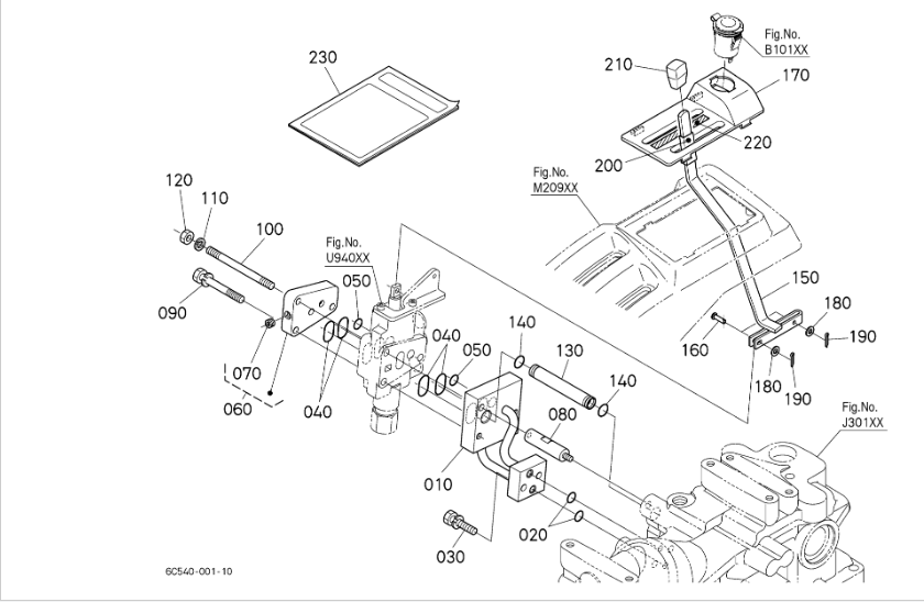

The whole goods part numbers for the factory remote kit are:
  • B1654 - first position stacking kit
  • B7304 - first position valve
  • B1655 - second position stacking kit
  • B7304 or B7305 - second position valve
That will set you back about $1000 and you can only have float on the second valve.
If you roll your own you can mount an inexpensive two spool valve in the general vicinity of the ROPS and connect it to the existing backhoe power beyond outlet. Then use the power beyond outlet on the new valve for the backhoe. You will also need to tee the tank return from the new valve into the existing tank return outlet for the backhoe . You can get two remotes with float on both spools for about half the cost of the factory kit but it won't be as "pretty". A likely mounting place would be that factory panel with teh cup holder in it. Replace it with a flat base plate and set the valve on it. The levers would be in pretty much the same position as the factory kit and the couplers would come right off the rear of the valve.
