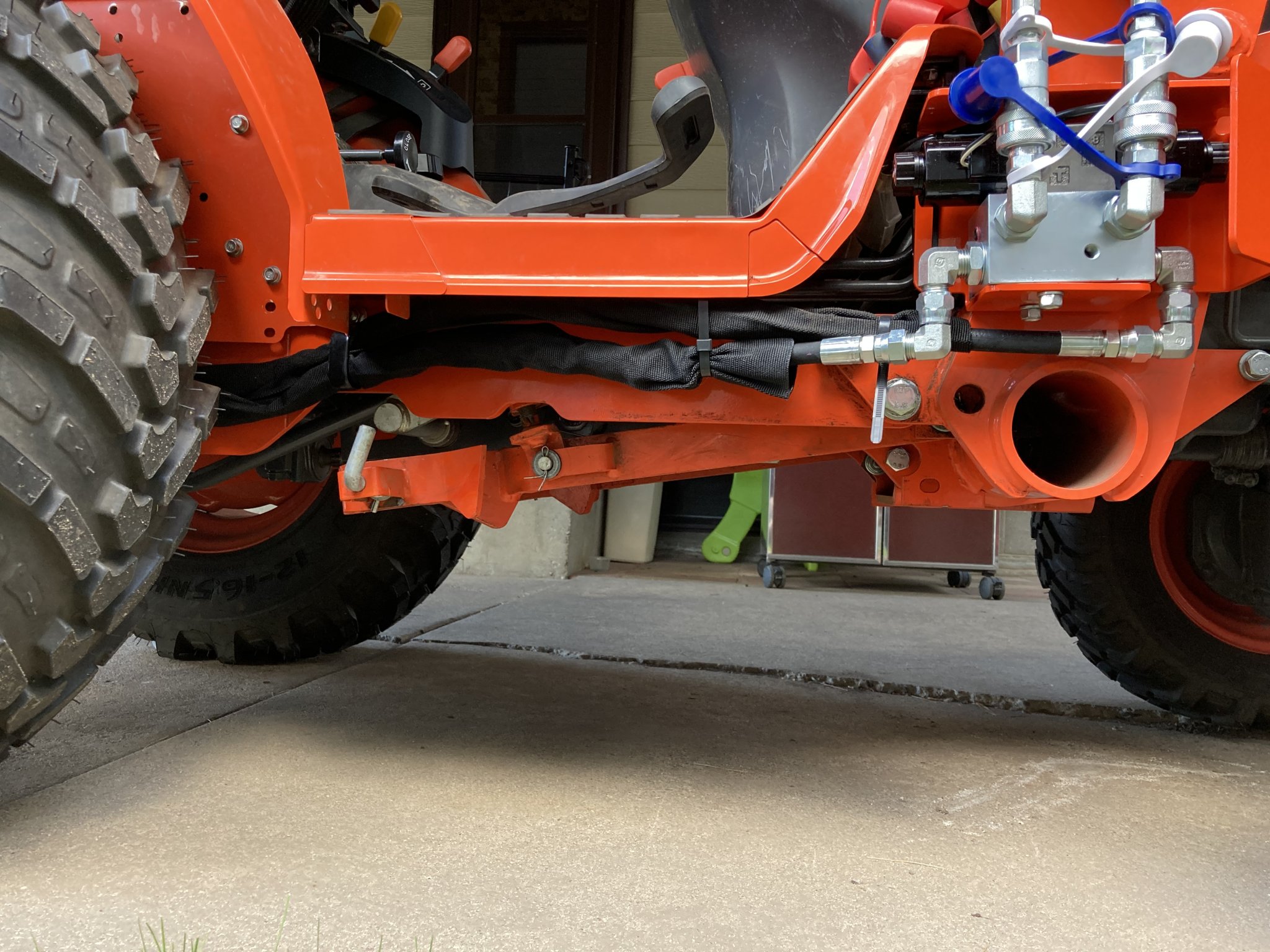

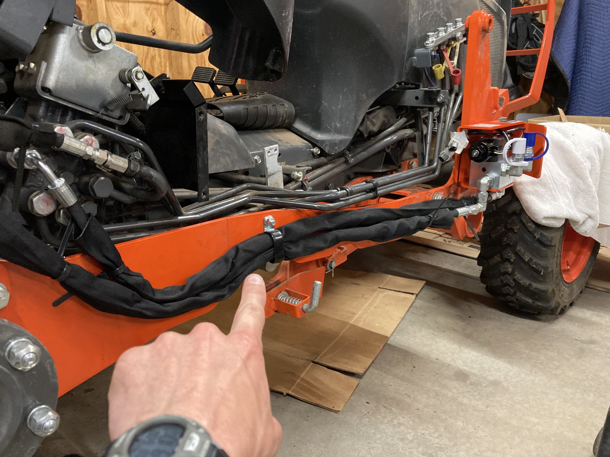

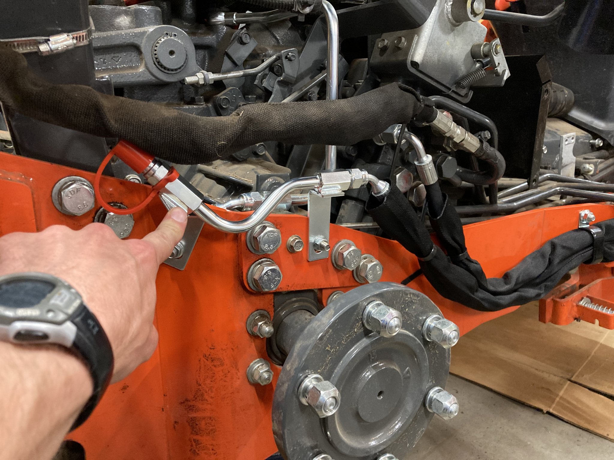

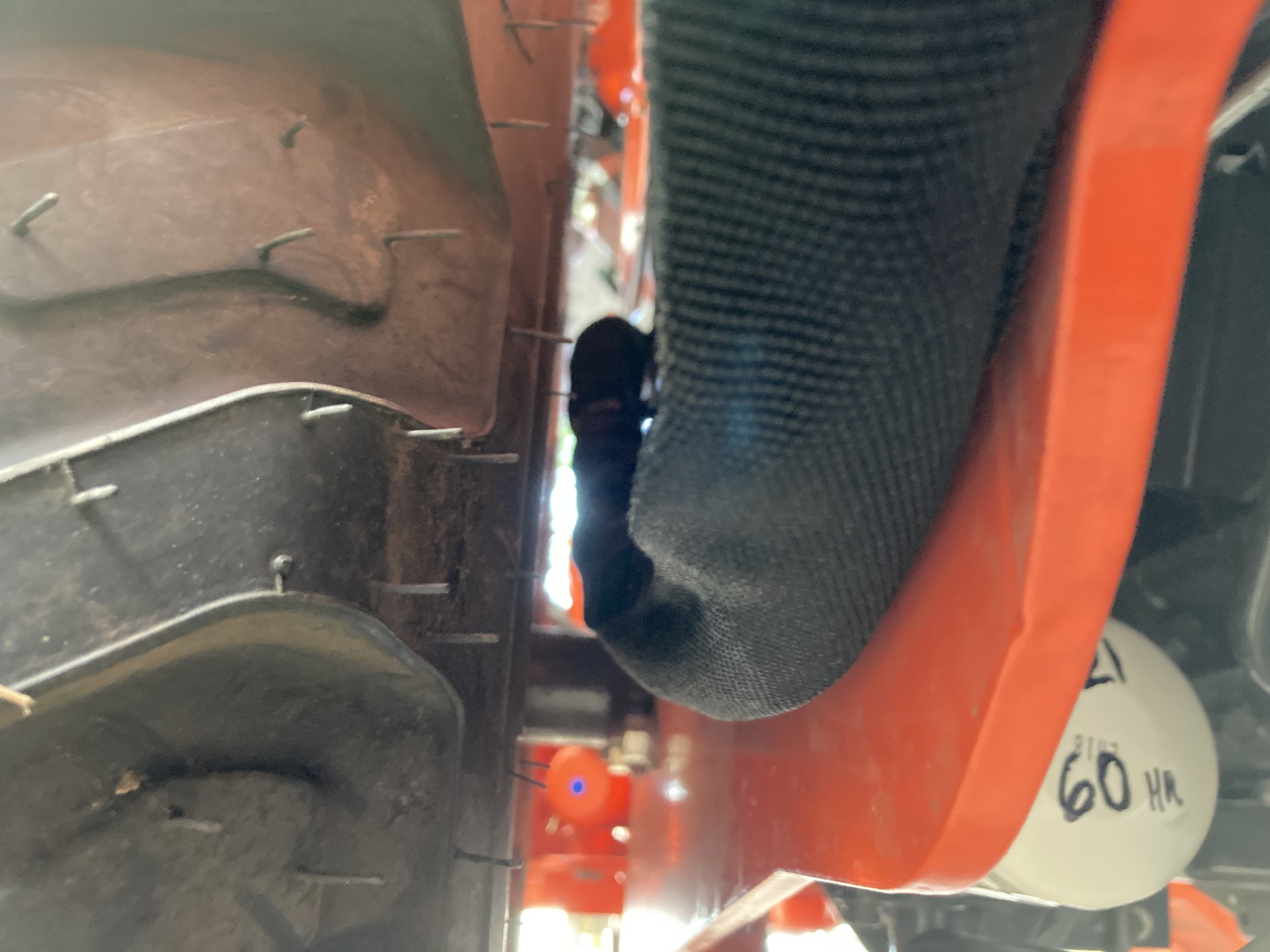

Well, got everything on, tried to take a few pictures as well.
First, had a question for @Frankb
How did they route your line from the 3rd function back to the backhoe?
This is the way the kubota kit says to do it, on the outside of the backhoe subframe. The issue is when you put the tire on it’s way too close in my opinion.

This doesnt look right ^
this is how my dealer installed kit was configured, same bracket where show, but the lines run inside the fender
I think the difference is the backhoe subframe. If you see in my photo, the backhoe subframe drops down as low as the filter. I also have the line with the red cap which I need to access when I mount or dismount the backhoe.
I’m going to pull the tire and see if I can run those lines in any other fashion.

Got a look at my set up and the line from the front block goes behind the frame and to the rear and attaches to the pump. Another line comes out of pump and continues behind fender to the rear for BH. Hope this helps.
