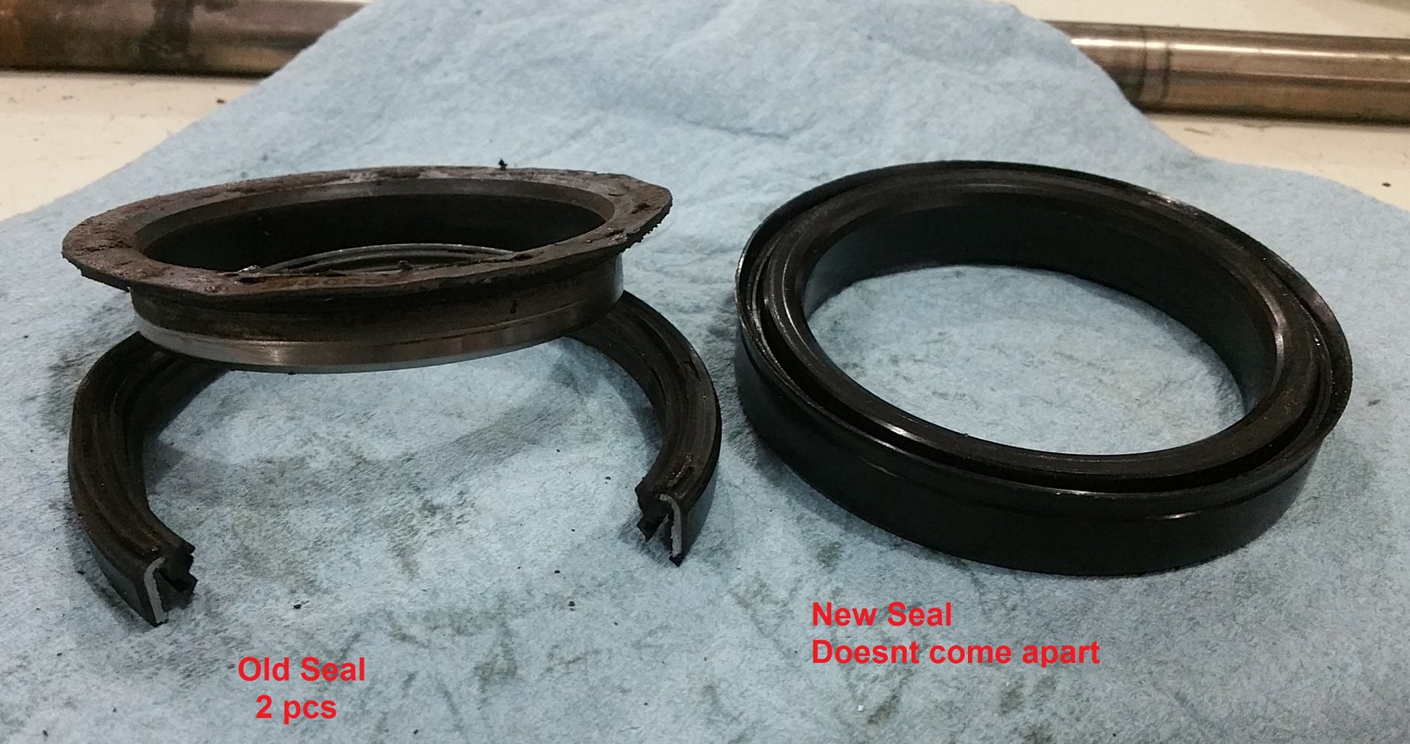

Hi I have B26 (2650 is same) with leaky pivot seals. I ordered new seals from my dealer. p/n 32721-56223 based on my serial number, but the new seals are different.
The old ones are in 2 pcs, a replacable sleeve with flange that slides on the axle, and the seal itself that fits into hub. Seems like a great setup. The new ones do not come apart. Seems to be a 2 pc assembly, I can move the inside ring slightly but cant get them apart or turn them with my hands. The new ones appear to have a wiper that seals against a face (same as old ones) but there is no new steel part for this to touch against? It will just be up the bare rusty dirty old casting of machine. Seems like Garbage.
What is up with this? Are the old style seals still available or are they all superceeded to the new ones? Are these new ones any good at all? Really nervous about the lack of wiper touching anything. And it forms a big bowl to collect muddy water.
